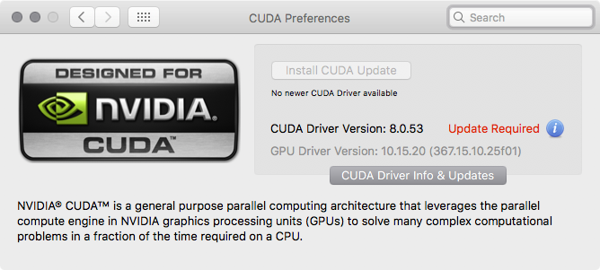

Drivers are working fine except for CUDA saying it's out of date. No updates available that I've found.

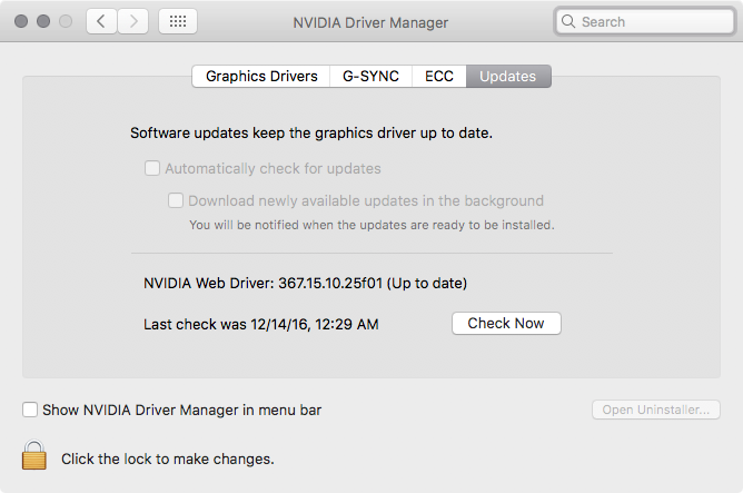

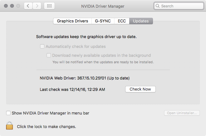

Thanks for the links. What has happened here? No more simple CUDA support? 8.0.53 was a 26MB download and 8.0.55 is 1.4GB.

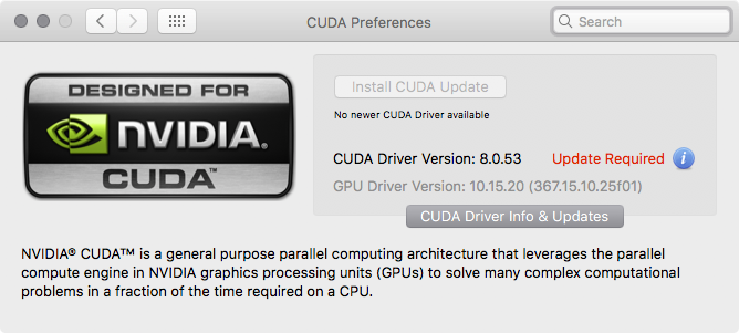

Read the last sentence of the first paragraph. CUDA will be released in the future.
I had the same thing on my MP. I use the standard Apple Nvidia drivers for my GTX 780 card. Updated to 10.12.2 and up pops I need a CUDA update. What was weird to me was I had never had a pop up like that. I usually had to check manually. Anyway I clicked update and I still have the CUDA preference box telling me I need to update. My current version is 8.0.53. I saw the update page on Nvidia and decided waiting would be good.

Actually I don't wee what all the fuss is about. I tried the 8.055 installation too, nothing appears to have been installed. BUT, 8.0.53 is working and working very well. Nvidia's web site is out of date. No Biggee. Everything's working. Only issue is no support for Pascal.
