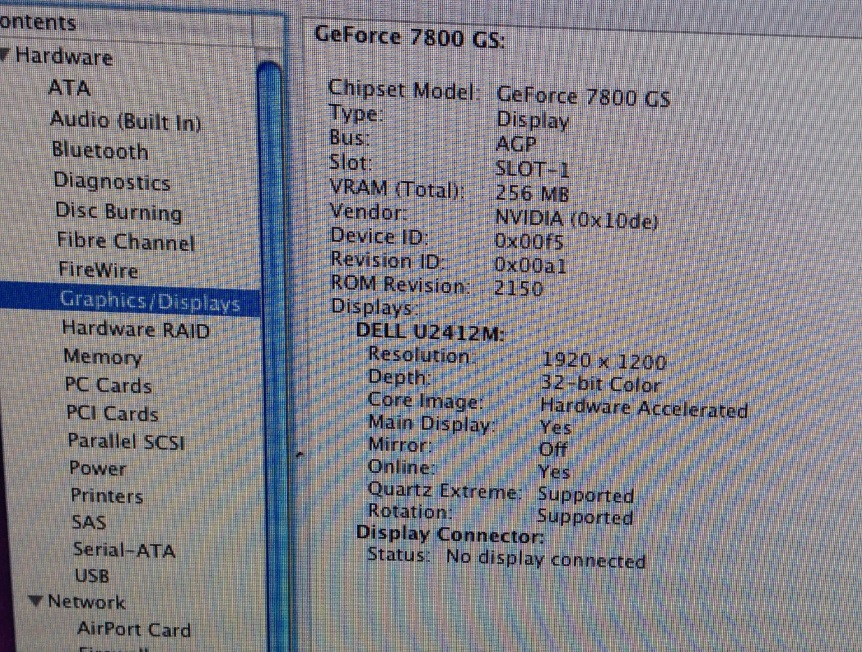

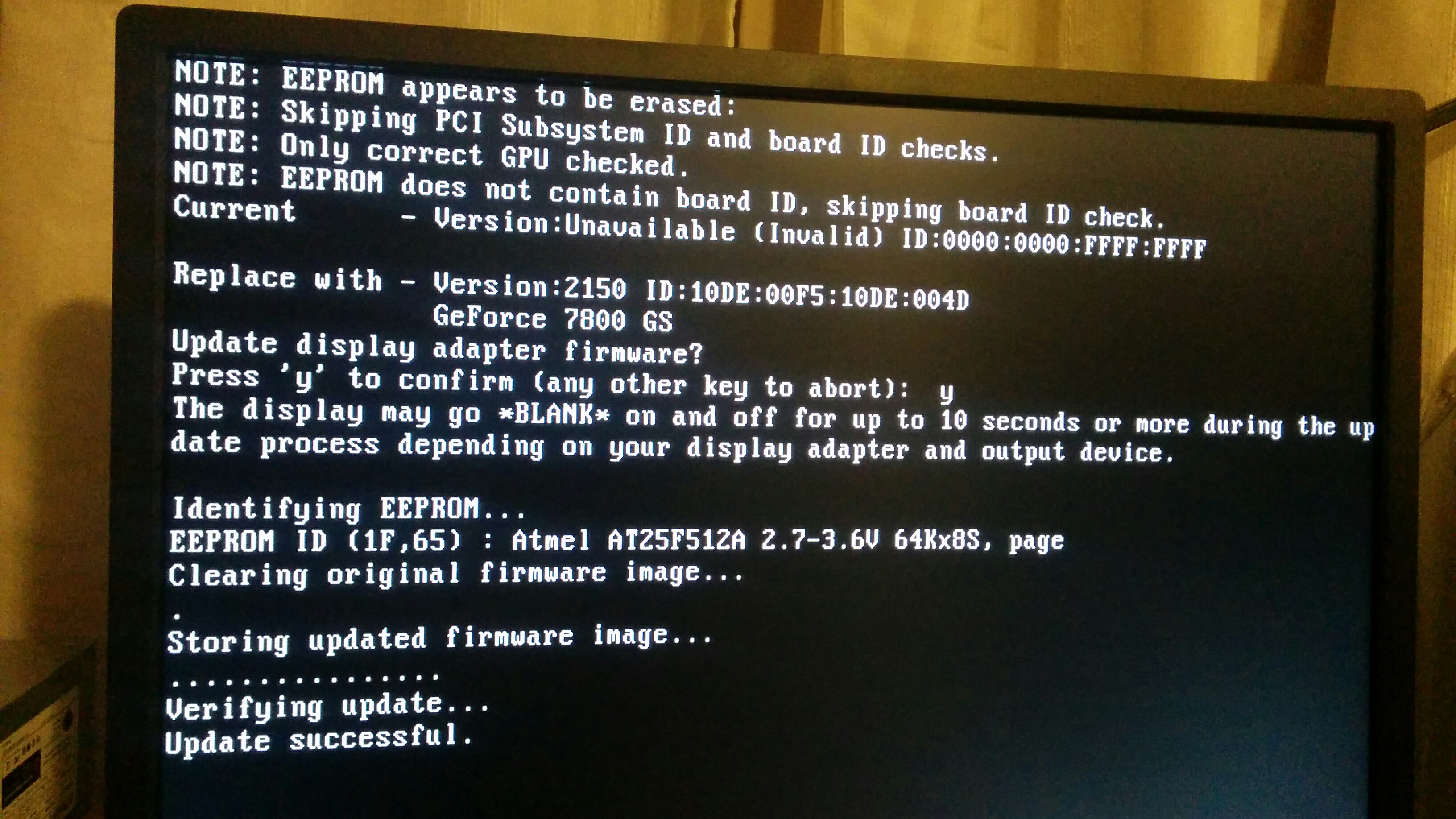

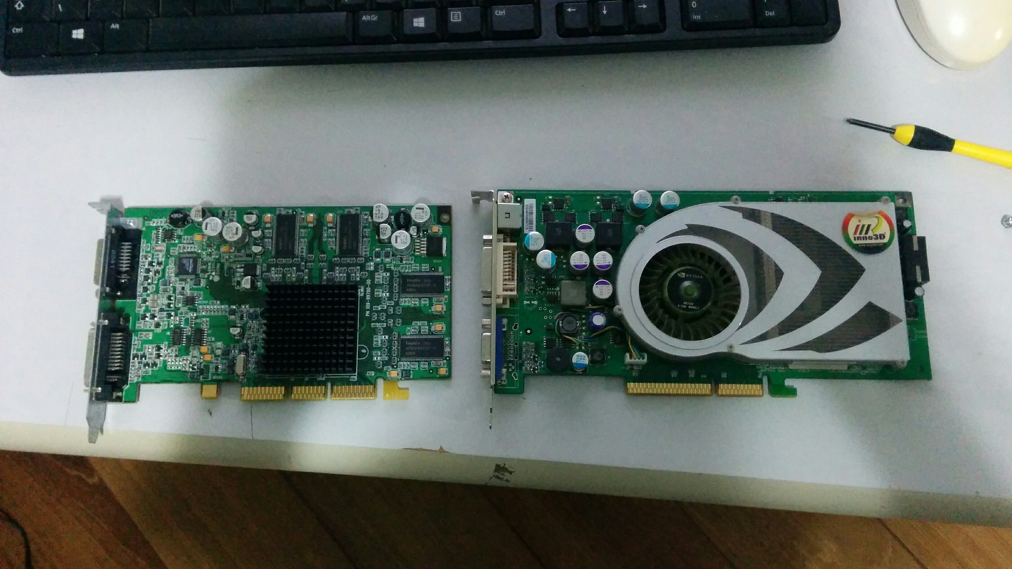

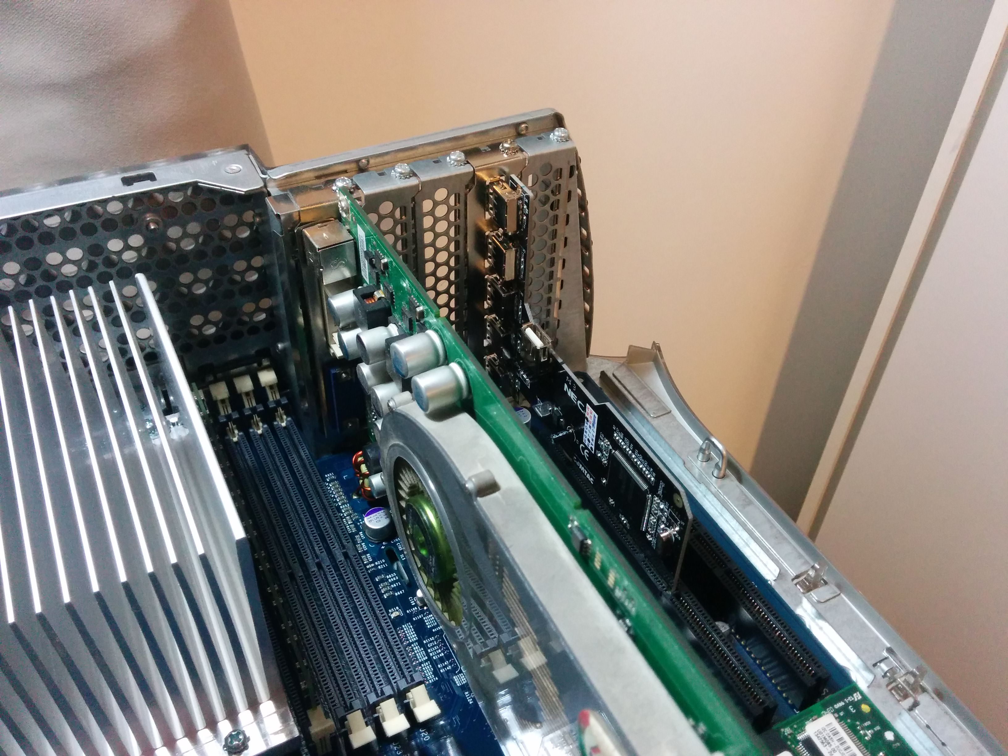

My first research was in reaction to the upgrades available nowadays (2017), I discovered an interesting upgrade to the video card, but I would not use the CRT because of the ADP connector, the original card is an ATI 9000, and a friend gave me many years ago a computer that had a 7800GS, which literally was in some corner in house, because it is outdated to use today, imagine my reaction to the unlikely happening ...

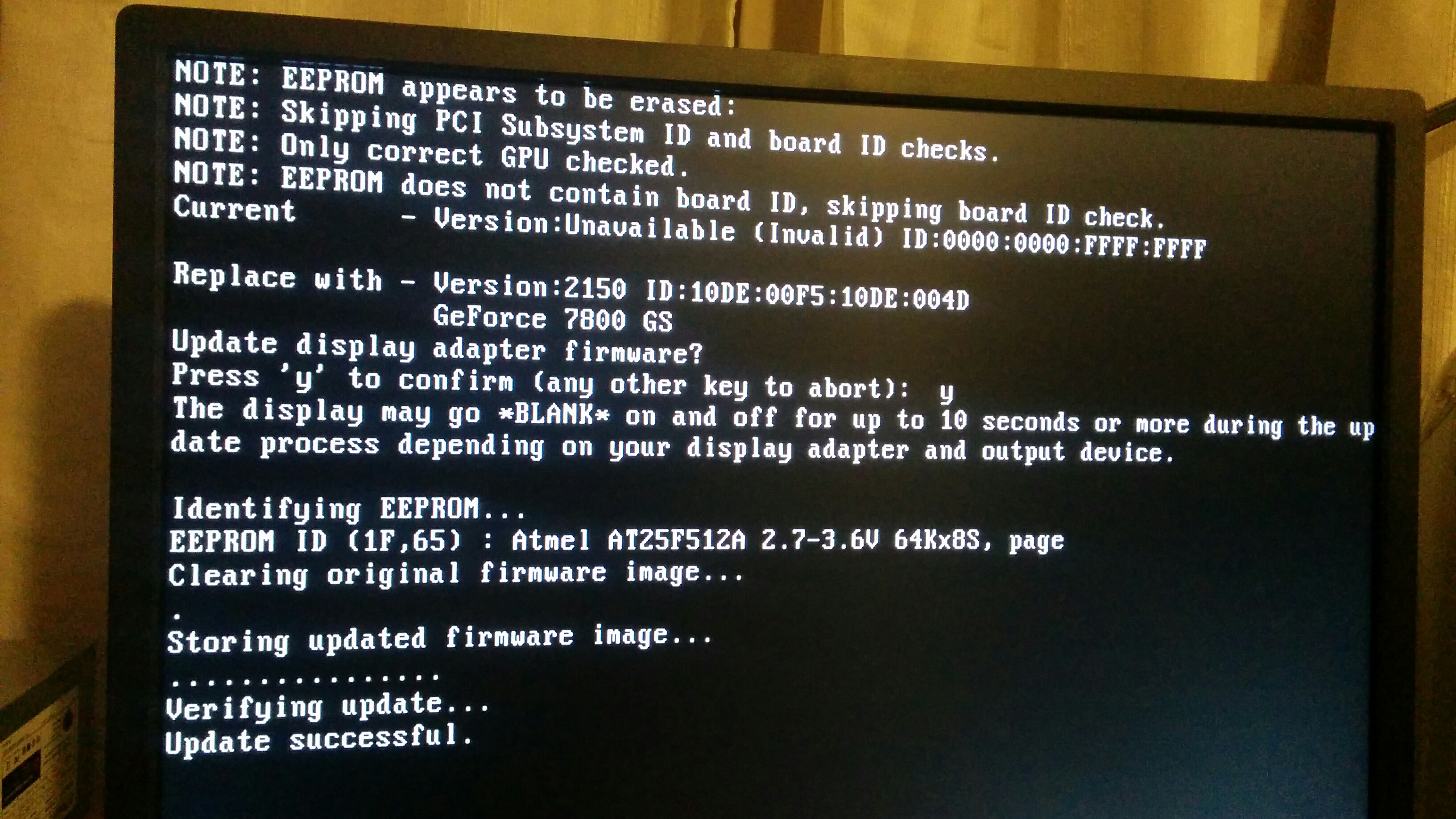

I read in the forum and I looked for information on how to proceed to flash the video card, plug the pins, etc ... etc ..
Well summing up it worked, and everything went well. But after replacing the video card I noticed that the osx takes a long time to boot and it's on a blue screen, but I installed OSX before with the ati and then I changed the card, and I did not redo the OSX again. (but works) normally, just take a long time to boot.

The video card upgrade has already been done and works normally.

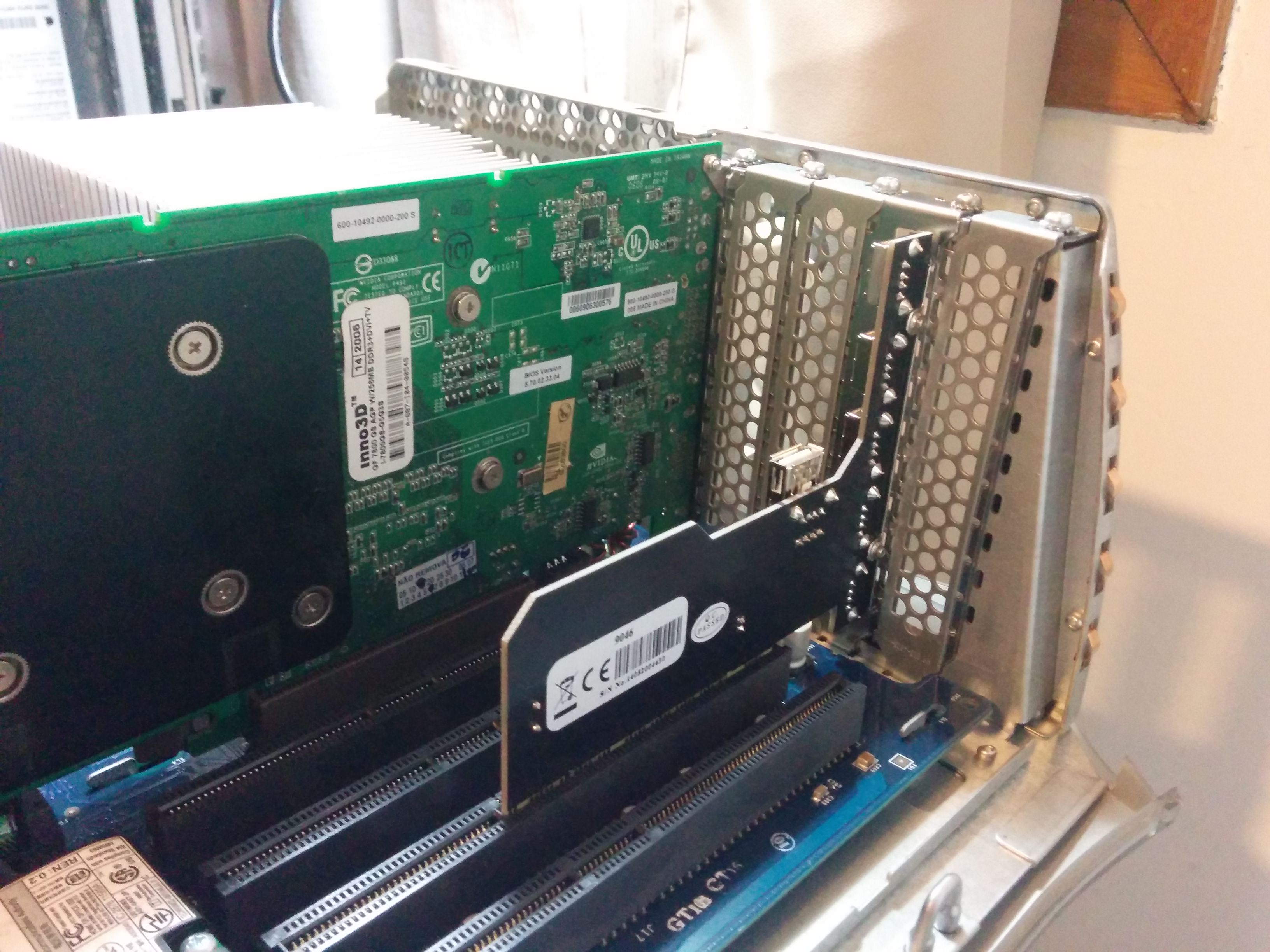

I bought a 2.0 usb card with Nec chipset, apparently has compatibility with OSX, the purpose is to have a faster connection and to pass files on pendrive.

in regards to the slow boot up with Leopard on the 7800GS, you must flash the card with the ROM which has the temperature sensor removed (it causes leopard to hang when it detects the sensor in a G4 computer) http://themacelite.wikidot.com/wikidownloads2 scroll down to the bottom and download this ROM file
this should solve your issues with leopard 🙂

Actually the rom I used was the one that has the temperature sensor. My fear was in flashing the rom without the temperature sensor causes damage to the board.
The GPU temperature its between 65 and 67 Celcius (Idle).

So, today i made some suggested changes, flashing the 7800gs, version without sensor, it really worked, now no longer problems with leopard, LightBulbFun, thanks for the tip!
I still have not changed the thermal compound of the video card, just for lack of time, but I'll do it too.

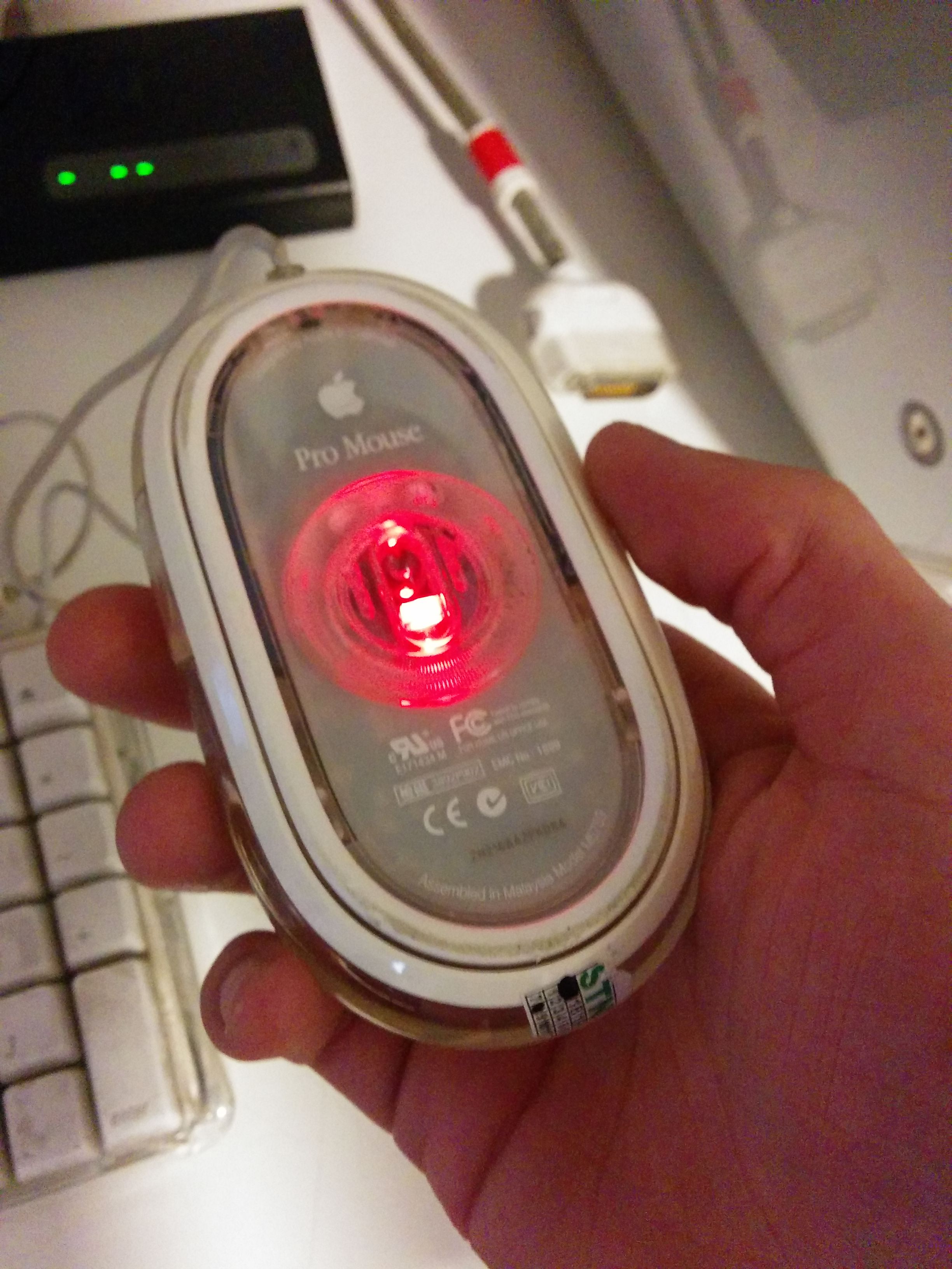

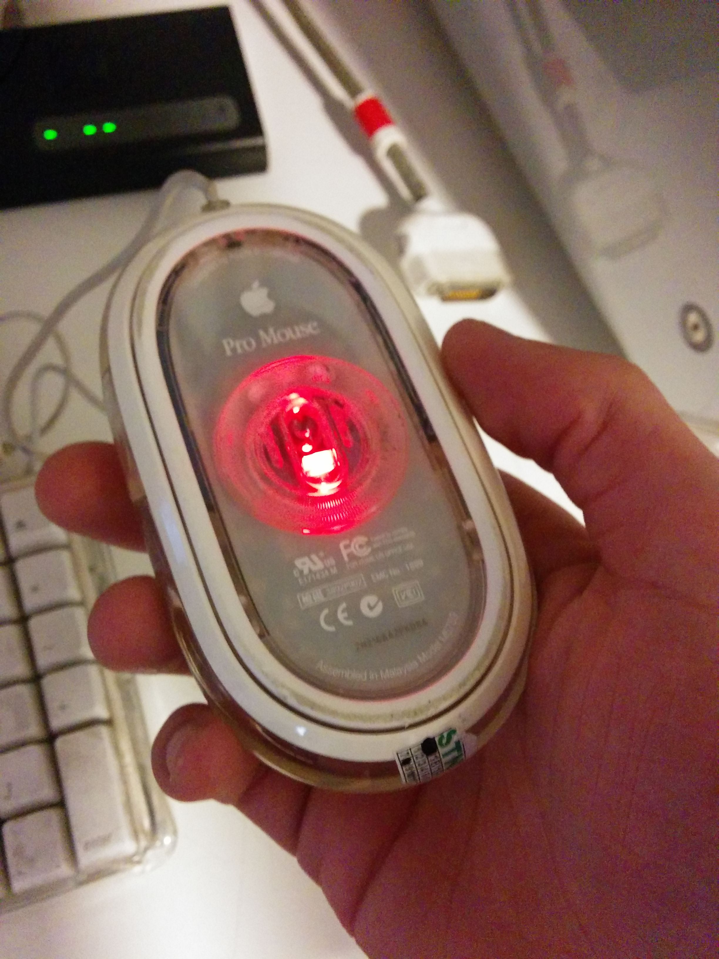

I got an Apple Pro Mouse, it was cheap and works normally, I do not know if this model is what came in the MDD, but that's what I like most with the transparent base. But for games it's not good!

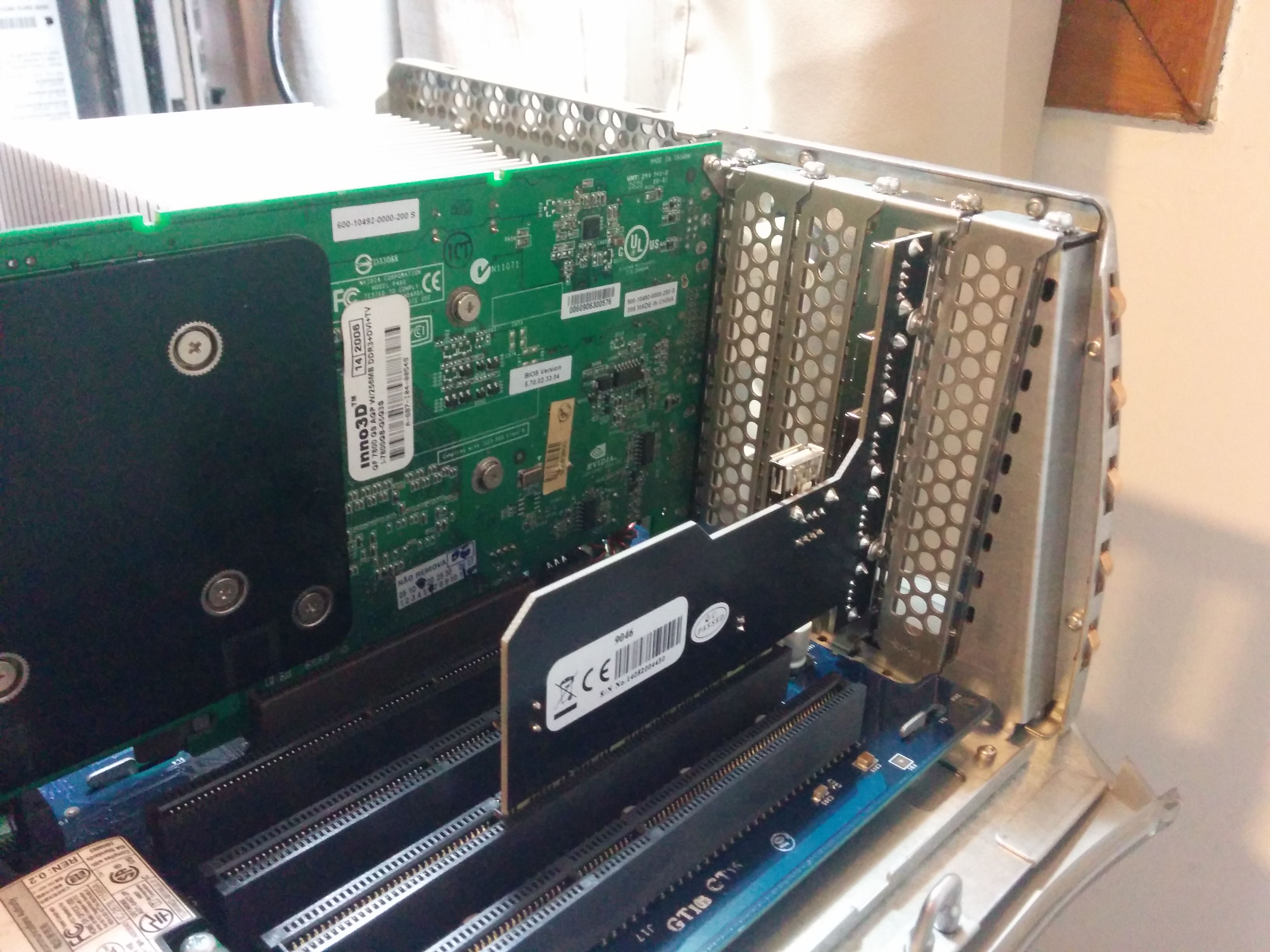

Also installed a USB 2.0 card with NEC chipset, works fine.

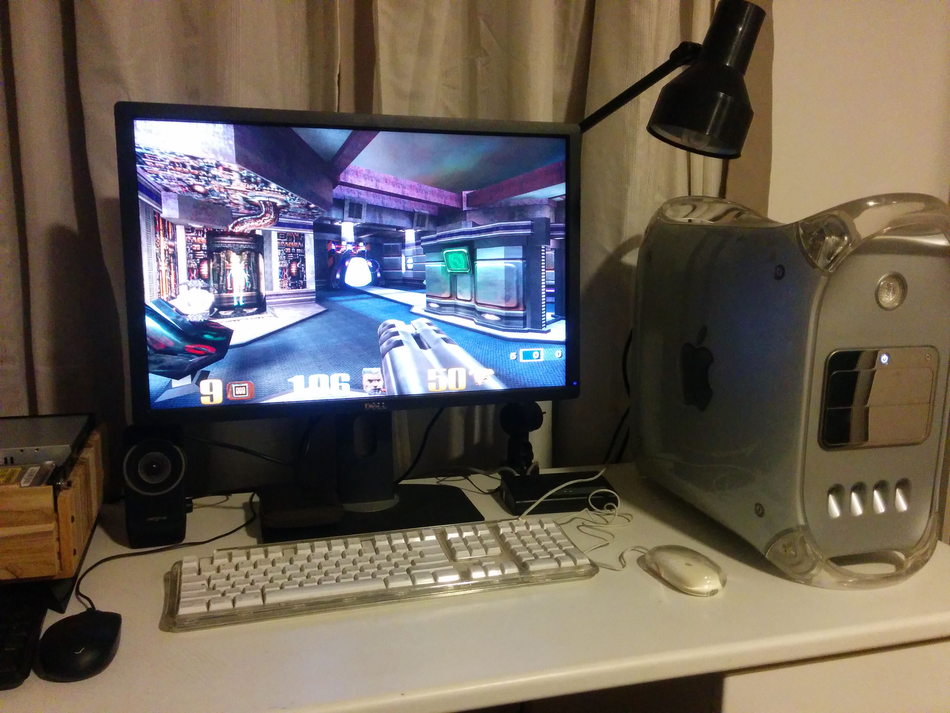

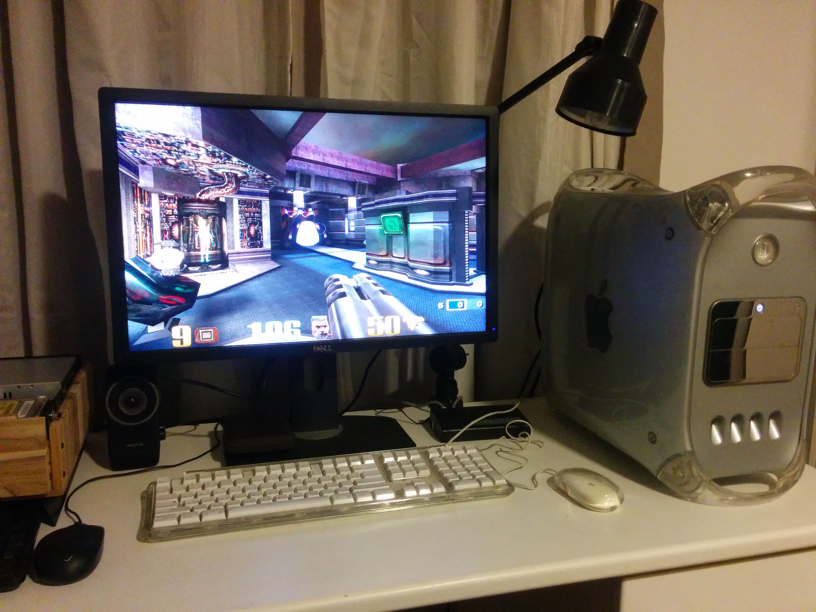

I tested q3a and ut2004, with everything at its best, worked perfectly, I felt a bit nostalgic!
The 7800gs really makes a lot of difference!
thanks for the help, really the goal is a good older gaming machine, and honestly it's getting better than expected.

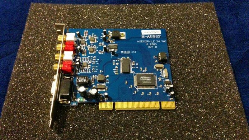

Yesterday I ended up finding a nice card to put on the mac, new old stock M-AUdio Delta Audiophile 2496 is a very simple sound card, but it has some functions i wanted for this setup, like a output spdif, i will use audio monitors, to listen to music, now i can listen and record my vinyl in nice quality.
The problem is that in most games it is not supported, ut2004 does not start, and in quake3 the board gets squeaked with the sound very low, but this is not a problem, for that im usin the built in board.

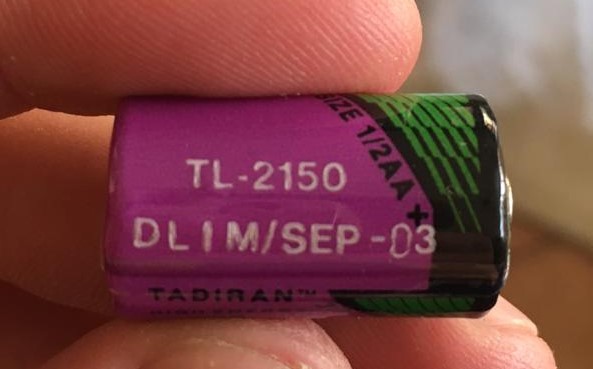

I hope the battery hasn't leaked, as I forgot to remove 😅

I was using a Dell U2412m, 1920x1200, on the 7800GS it works fine.
The CRT is because I really like to play on these old monitors, the resolution is good 1600x1200, to play quake3 is native and works very well, due to the challenge of making the monitor work properly and because I know it would be a waste to leave it in a corner and don't use it.

The battery did not leak!
Probably original?
