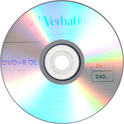

Eh?! You're thinking of dual-sided DVDs. Dual layer DVDs have a label side and an "untouchable" side.
Exactly. Dual Layer means two layers on one side where the upper layer is transparent to the lower layer.
