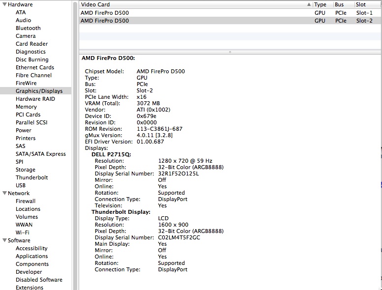

When you switched the monitor to MST, you caused it to go into 30Hz mode (see page 34 of your user manual). That's why you're not seeing the problem. If that's acceptable to you, then that's fine, but most of us with these monitors want them running at 60Hz.

Thanks for the input. I checked the System Info (see image) and you are partially right. It is not running at 60HZ, it is running at 59Hz 😉. Note that I am using the Largest Text scaled setting because I have reduced visual acuity. Also note that my primary Apple 27" TBD is set at 1600x900. At these settings, I find that the text size on the two monitors is roughly equivalent and easy to scan back and forth between the monitors.
I find the extra sharpness of this monitor to be useful. I will be using it primarily for photo editing and coding rather than gaming or video. You are right that if I used a smaller text size setting, it runs at 30Hz. I don't think that will be an issue for me.
