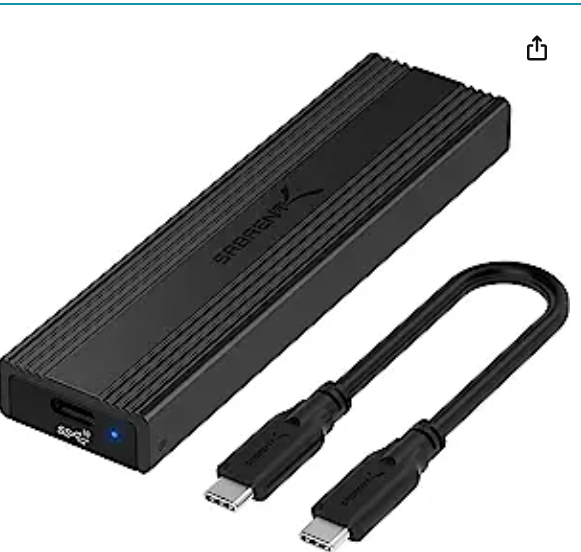

My preferred method is get a new SSD install that in the computer and then use a USB M.2 NVME enclosure for the old SSD, from there I'll copy my data from the old drive to the new drive.
