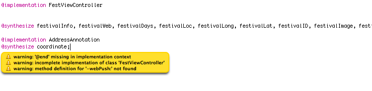

I have a similar problem and after exhausting attempts can not rearrange this into a way that will compile. Could somebody offer me some kind help please. Will be much appreciated.

Hi again thanks for that, it now compiles. Next problem is though that it crashes when that view is loaded. There is a warning about the @end. I'll attach a screenshot. Thanks in advance again!

The previous @implementation block has no @end.
Might be worth going back and re-reading the Objective-C basics again. This is really basic stuff.
Also, to keep things less confusing, it's common to restrict one class definition per file (with paired .h and .m, of course). So, you'd have:
- FestViewController.h and .m
- AddressAnnotation.h and .m
- MapViewController.h and .m
