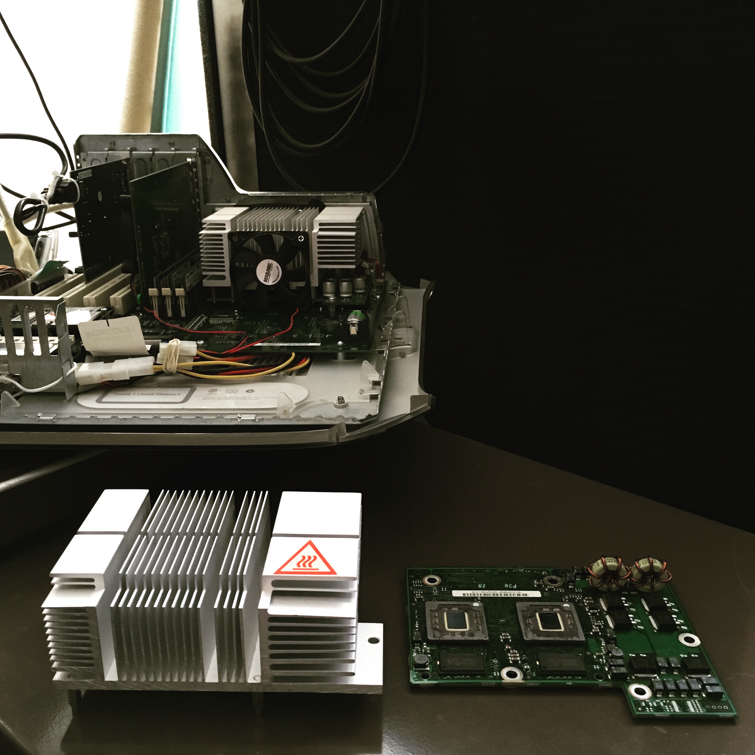

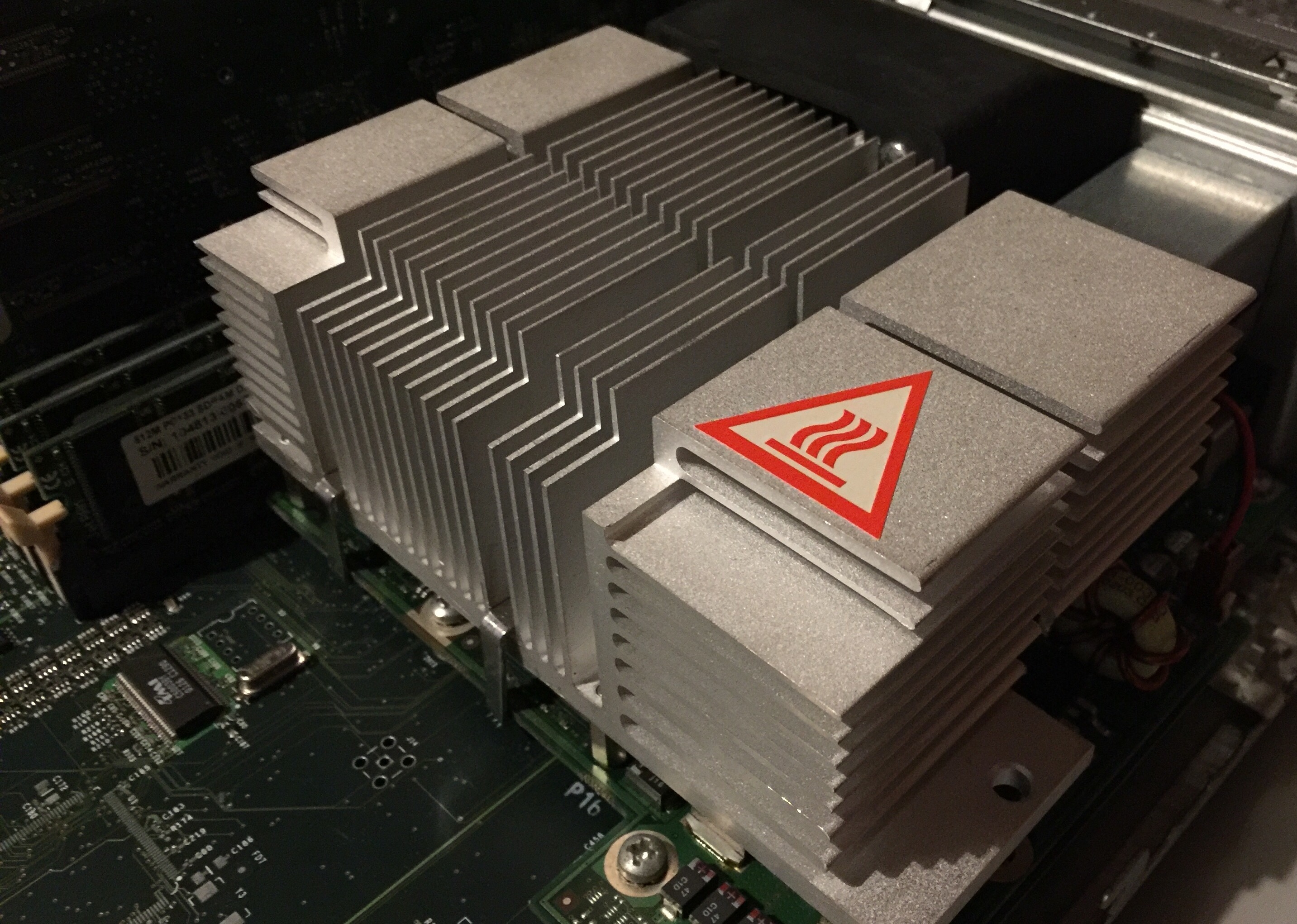

I recently acquired a Quicksilver Power Mac G4, running 10.4.11. It's my first tower Mac and I need some help, so I decided to register here.
Question no. 1: The board on this Mac is from a 733Mhz 2001 Quicksilver, but it has the 1Ghz DP chip from 2002 installed (detects L3 cache no problem). I've read that this chip needs a special, bigger heatsink, but I'm unsure if mine is the right one. I've attached a picture of it to the post.

1. Can't answer about the heatsink. My QS came with a Sonnet and a Sonnet dual replaced it.
2. You can always replaced the speaker on eBay for cheap.
3. You can connect to WPA, but you need TKIP security. You can't use AES.
Thanks for your reply. I'll be replacing the speaker and getting a PCI Wi-Fi card since my 1st gen AirPort card is either malfunctioning or incompatible with AC routers.
I'm still unsure about the heatsink.

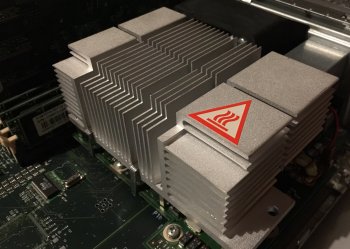

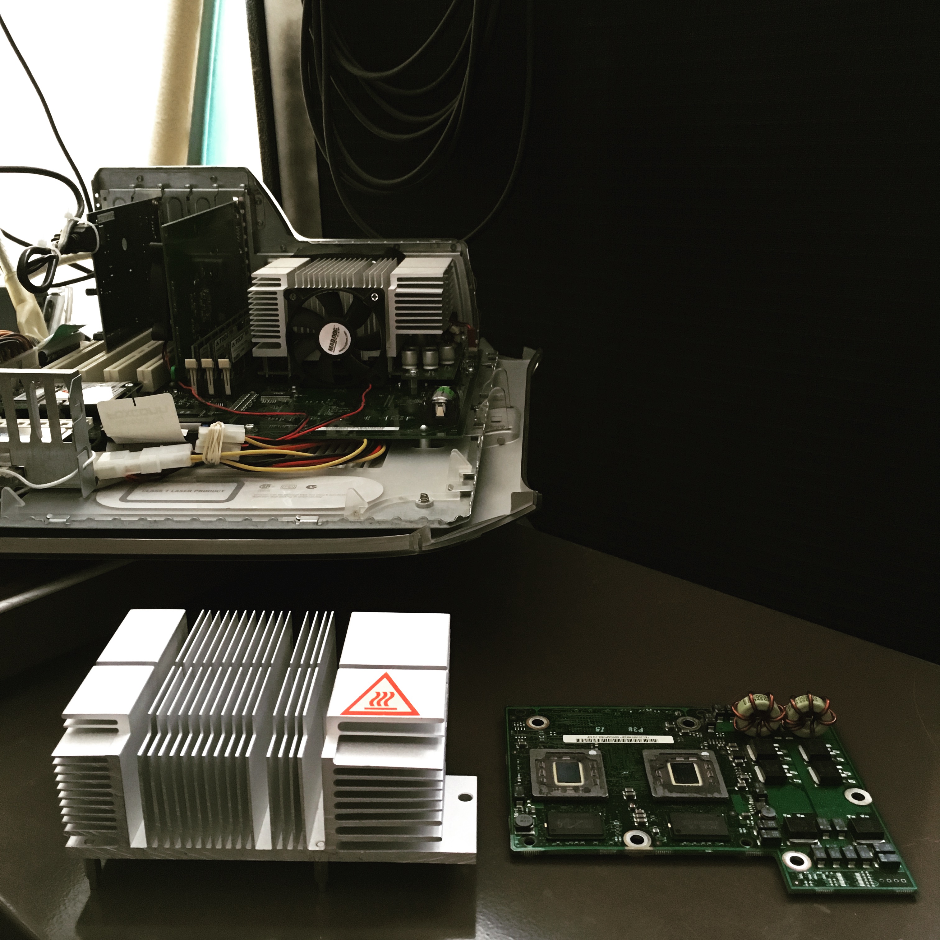

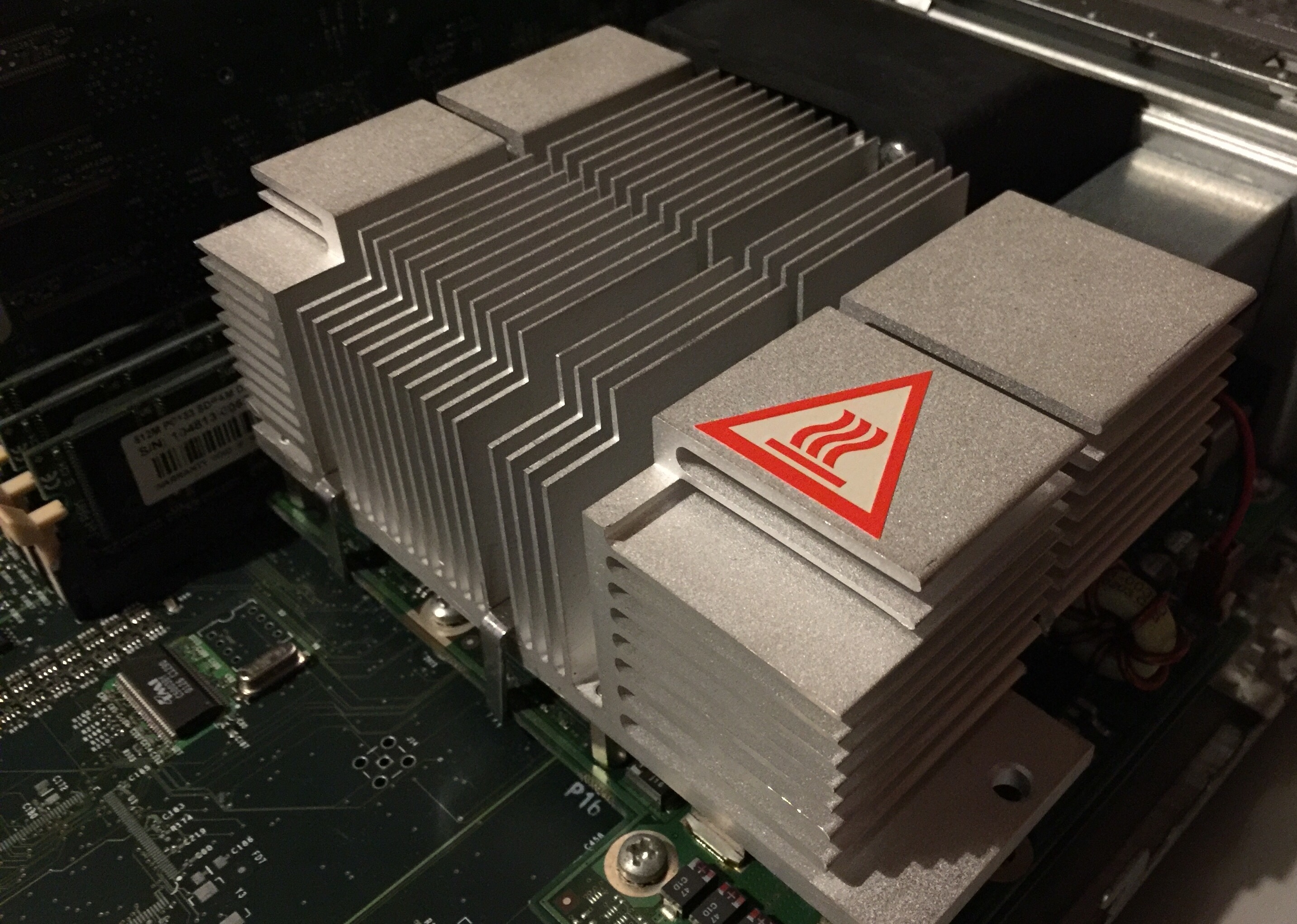

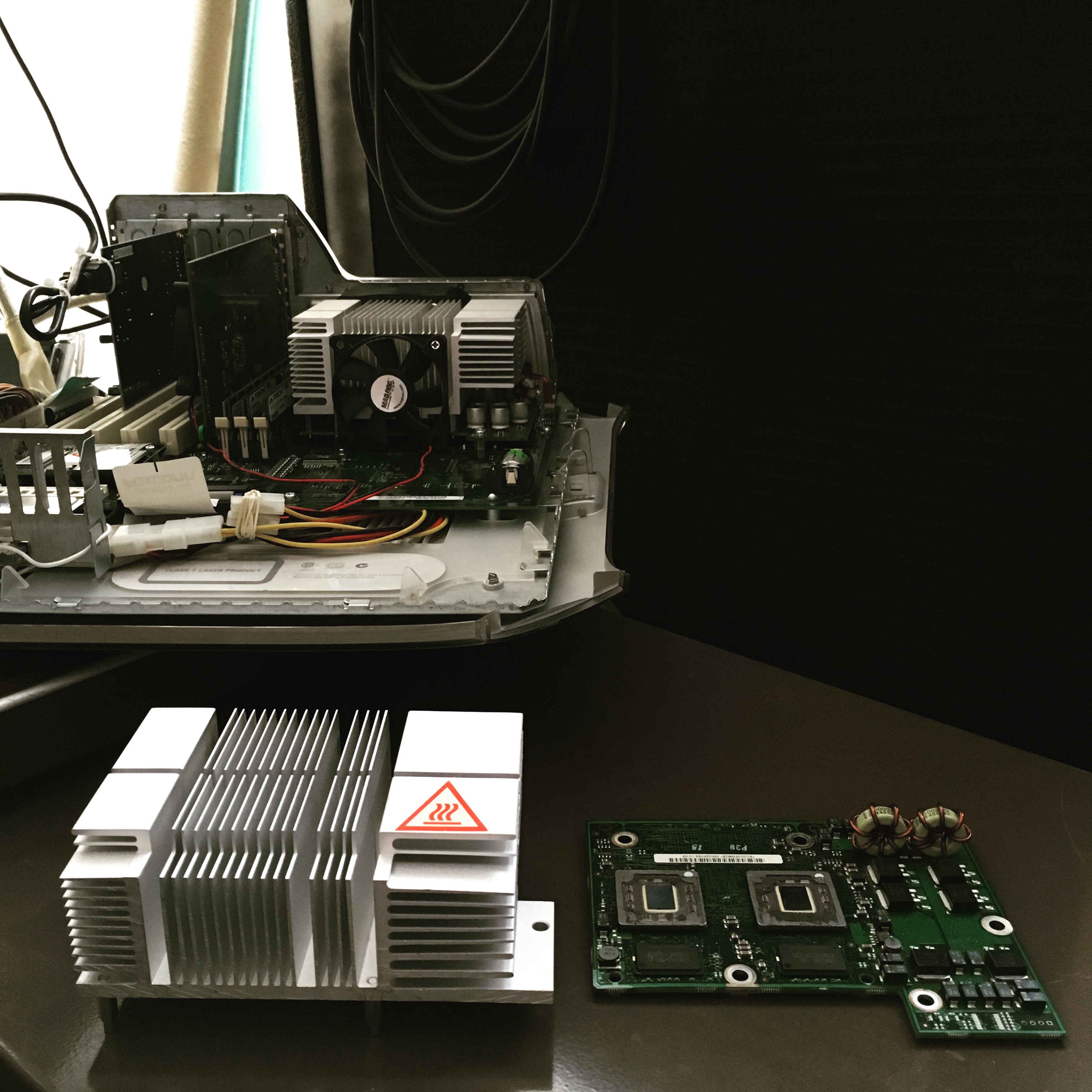

Yep, that's the correct heatsink. Attached is a photo of mine - identical setup as yours, when I installed the DP1ghz Dcard & heatsink into the single 733mhz QS.
FYI, the fan is aftermarket (salvaged off an old HDD cooler lol). The QS runs just fine without it.
As far as the speaker, it sounds pretty normal to me (kinda hard to tell with the MP3 quality). Anyhow, I've always thought the g4 pm towers sounded a little distorted but iirc you can adjust down the output volume in sys preferences>sound to where the chime is not overdriving & clipping that tiny 17yr old speaker. That or just buy a new one per Erik.
Good luck 🙂

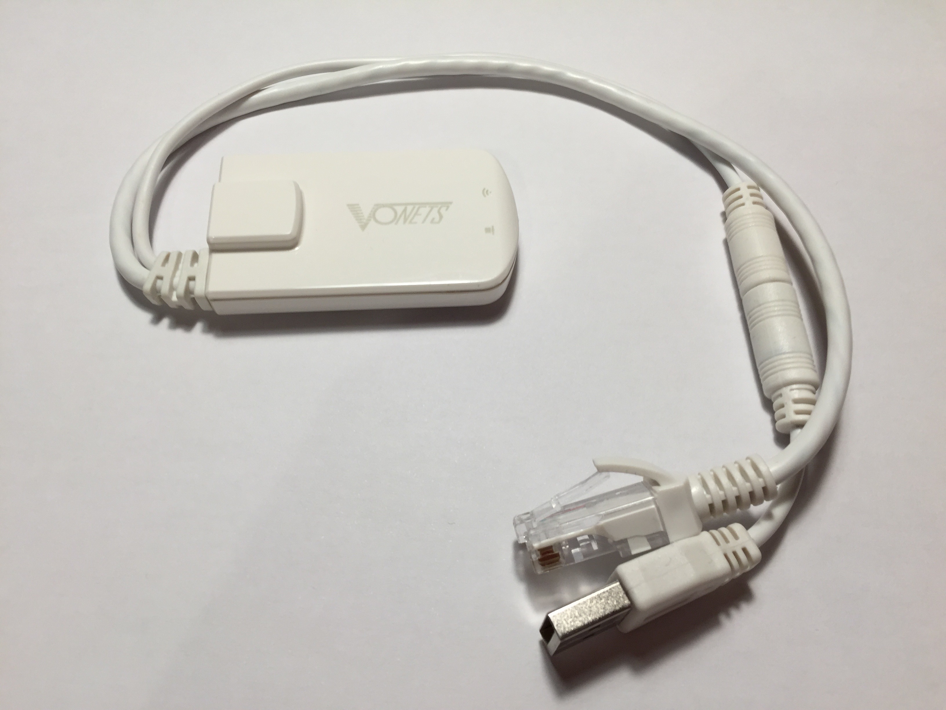

I haven't replaced this guy's thermal paste yet, but the wireless bridge has arrived. It's a Vonets VAP11N.
It came in an oddly inspirational box...

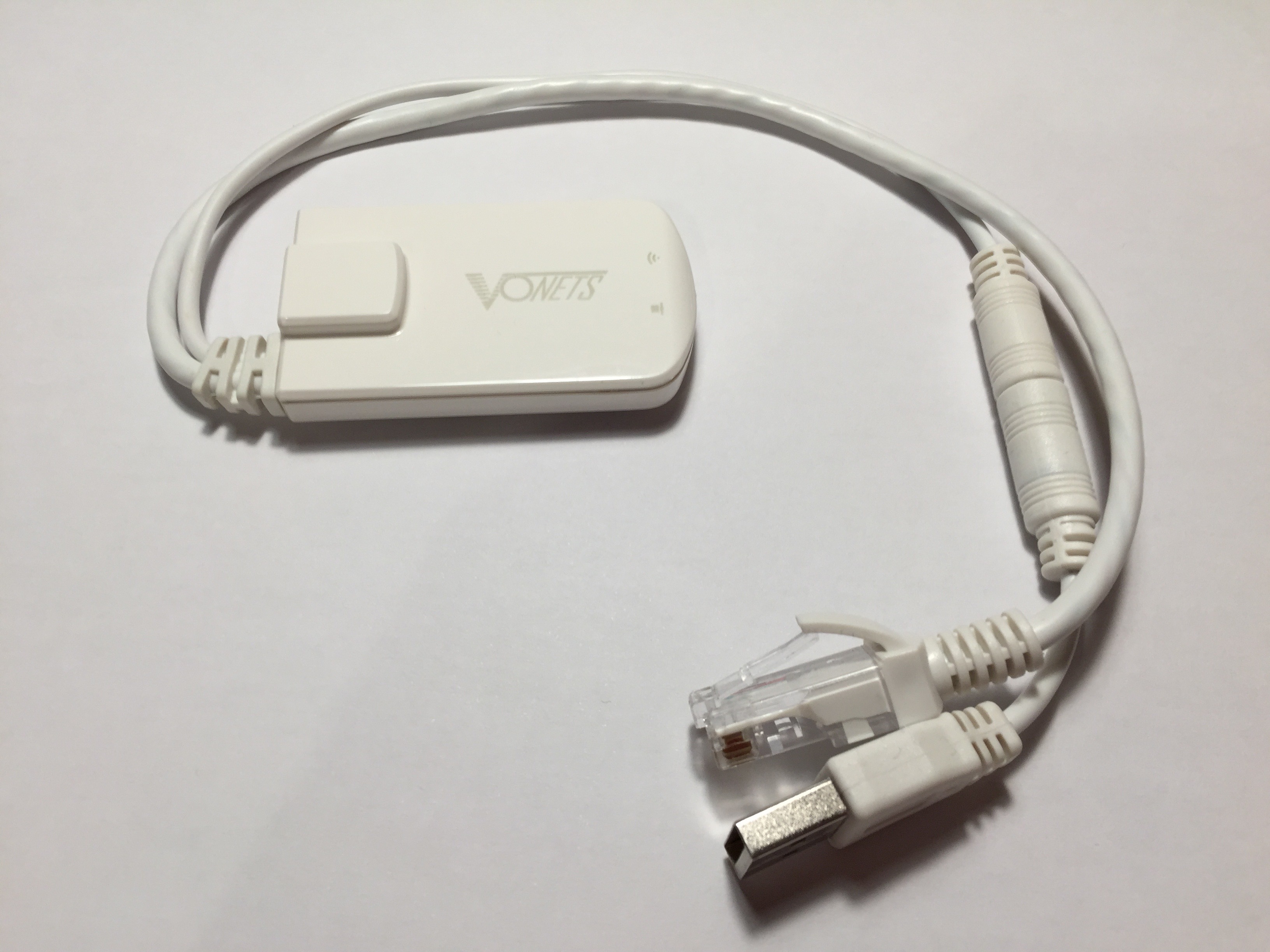

It's a very small unit, comparable to Apple's 5W USB Power Adapter (shipped with iPhone and Watch) but of course thinner. Was powered by any USB port I connected it to, even the USB 1.1 ports on the back of my Quicksilver.
Setup is pretty self-explanatory, but keep in mind it will only connect to a wireless network with no spaces in its name (accentuation not great either).
I thought mine was faulty or incompatible with my router at first but it now works. I didn't test the repeater function.
Connection: it doesn't hit the advertised wireless N speed (300Mbps), it's also not dual band; but for my use it was a great deal (just 11€).
I've been using my G4 far away from the router and it still gets a signal: it's not fast (file downloads are a bit slow) but I could actually browse the forums on Classilla just fine.
I assume a more expensive bridge from the likes of Linksys or Netgear or an AirPort Express would be better though.
If you're planning to do serious Internet use or your G4 is your main machine, go for a Wi-Fi card.
If you're looking for decent, USB-powered wireless connectivity on OS 9, go for this one. Wireless N version definitely recommended.
It should also be useful in connecting even older Macs (68K?) to the Internet.

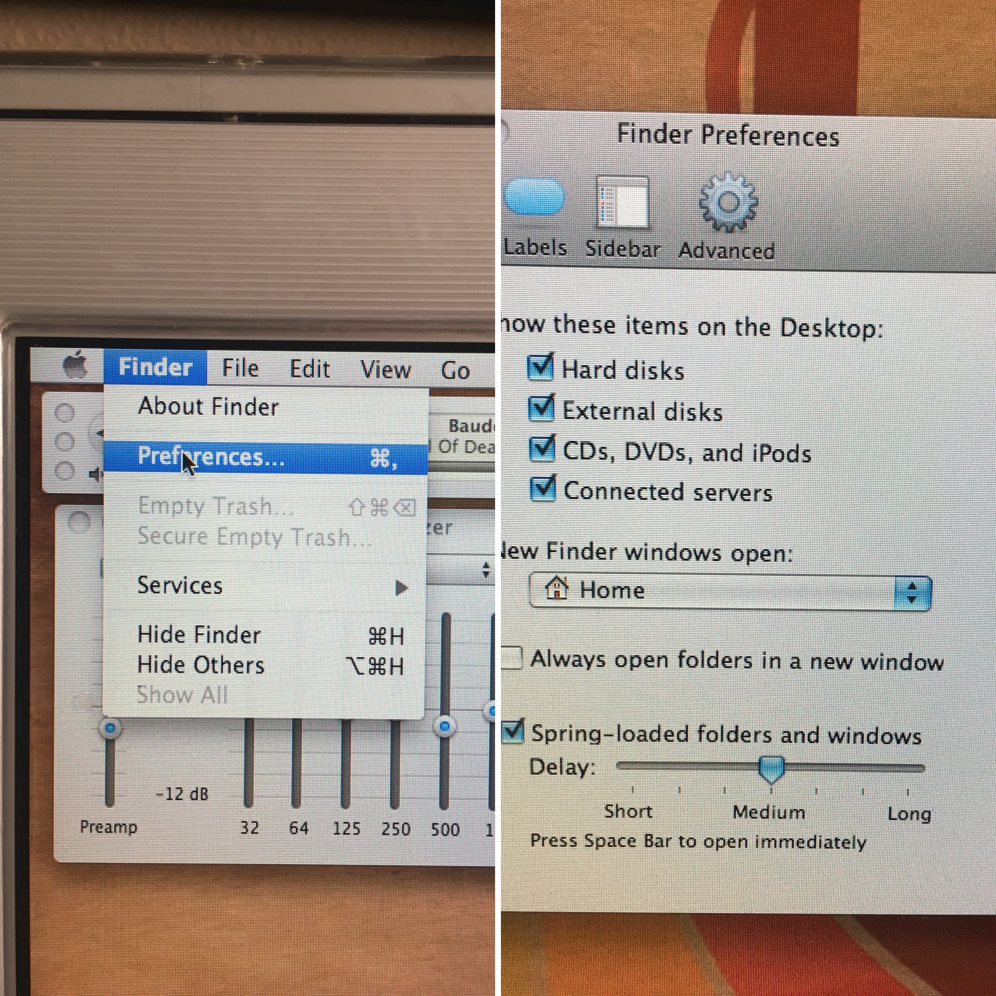

Apologies, this isn’t exactly the right thread, but now I can’t even find the ones I was looking at so thought I would wave a flag at some G4 tower people. I think mine is a Quicksilver. Have had it since it came out.
Basically, I am not computer savvy enough to go further without probably destroying it - any poiters regarding the below issues or anyone who is a fixer in Edinburgh, Scotland?
My HD icons disappeared after I replaced PRAM battery. Will not turn off without manual switch ( but it had been doing that for a few weeks before replacing battery) Did complete back up of everything to external drive thinking was just too clogged ( did take all night)
Have done apple/alt/P/R but there is no start chime to do it to so guesswork on timing.
Force quit does not work in finder.
Apple tool bar at top completely missing unless I open an app - all open and work including TenFourFox for net, except for Money accounting app. Can open HDdisks via a search on tool bar if I make it appear.
Really don’t know what I am doing anymore, but I love my computer - please be kind and help if you can!

As for your hard drive icons, go to finder in the upper left, click on preferences & make sure the show HDD, external hdd, CD/DVD/IPod boxes are ticked.
