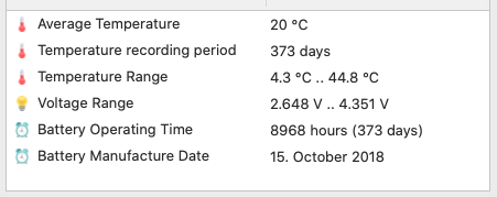

I got my iPhone X battery replaced by an Apple Service Provider today.
Coconut Battery now tells me that the new battery was manufactured 2018-10-15.
The cycle count is 0.
The battery is at 98,7% of its designed capacity.
Is the new battery’s age of 969 days problematic? Should I complain?
I would expect the new battery to last 3-4years like the first one did. The fact that it’s already > 2,5years old worries me.
Is it possible that spare parts (including batteries) are manufactured (and kept in shelves) while the device itself is manufactured? That would match the manufacturing date…

coconutBattery (Plus) tells me the minimal Voltage was 2,65V.
If I'm not wrong a deep discharge starts at 2,5V - so the battery could be fine.
