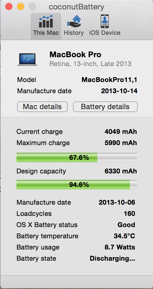

I know this thread is almost a year old, but I'm also have some issues with my late-2013 rMBP running hot and loud while watching a tv show on the ABC website in Chrome. I don't have any of the iStat apps, but Coconut Battery is reading 34.5* C after turning off the video for a few minutes and letting the fan spin down. After converting to Fahrenheit, I realized how hot that is! 😱
Any advice? I have AppleCare, so I can certainly get it looked at. I'm sort of afraid to open up an rMBP myself since it's more of a challenge than the cMBP.

Coconut Battery displays your battery temp. Not to say itʻs not important, or that it wouldnʻt rise if your laptop were running hot, but most people are quoting CPU temps when worrying about such things. Also, 33-34C is normal for your battery. My rMBP runs cool and has no issues, and this is the batt temp range Iʻve always had.
In regards to your issue, what youʻre observing is normal and itʻs because ABC (regretfully) uses Flash for their websiteʻs videos. I just tried it with a newscast on Chrome and within 5 minutes my CPU/GPU temps jumped from 44C to around 85-90C. Fans took a while to spin up.
So...as the poster above mentions. Youʻre using Chrome which many members will tell you is a resource hog, but the real reason your computer is running hot is because youʻre watching Flash based videos.
