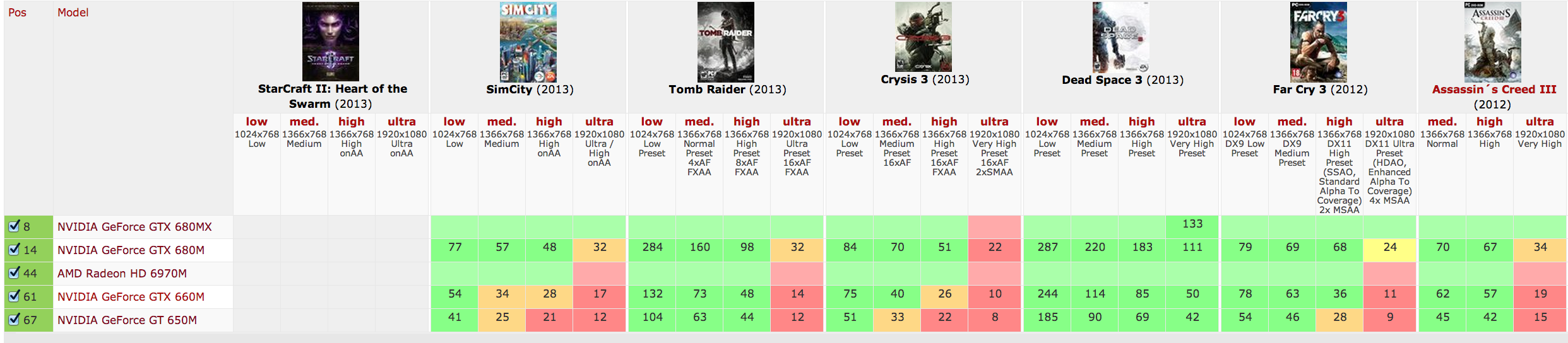

I have never played Sim City before but I would never expect a simulation game this graphics intensive...
