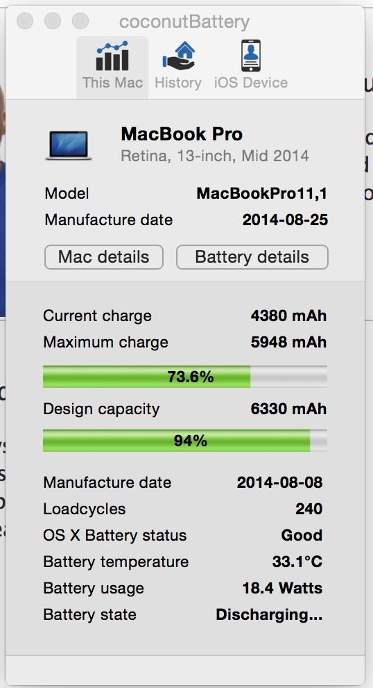

I bought a 13-rMBP in September 2014 and after 3-4 months I have perceived that battery is during only 2-3 hours instead 7-8 hours on the first months. Now with more than six months the rMBO still have the problem. What can I do to solve this?
Here is some information about my battery:
Charge Information:
Charge Remaining (mAh): 5373
Fully Charged: No
Charging: No
Full Charge Capacity (mAh): 5937
Health Information:
Cycle Count: 239
Condition: Normal
Battery Installed: Yes
Amperage (mA): -1175
Voltage (mV): 12259

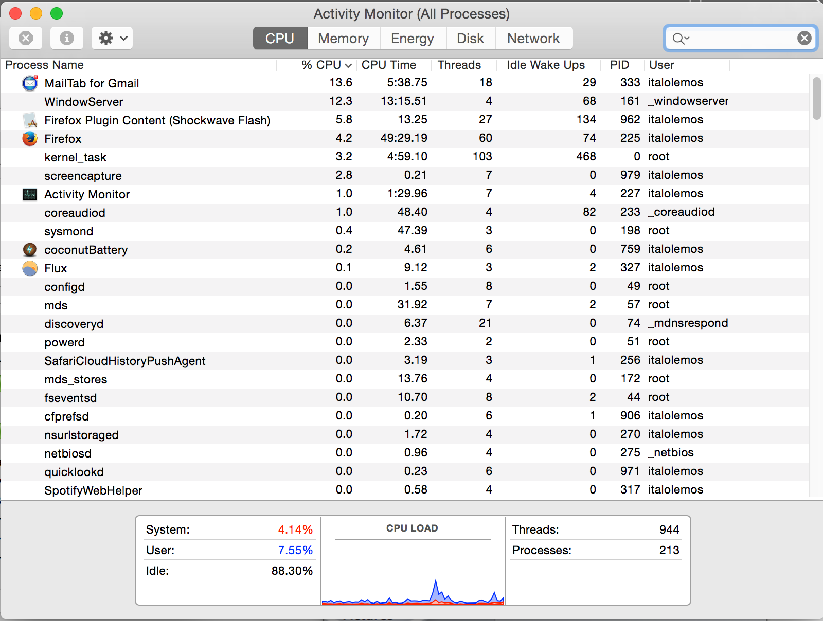

Well, I haven't chrome installed just firefox and safari but I watch a large number of youtubes videos. Other application that I use all time are Sublime Text and Eclipse. They are simple applications, almost don't require much percentage of cpu. I noticed that after upgrade for Yosemite OS this battery problem started.
You can tell us more information, by opening your Activity Monitor. Go to the CPU tab, then the Memory tab.
What color is the Memory Pressure graph?
Green is good. Yellow, or red, means high memory pressure, and will often also mean that you have a high level of swap in use. And, likely that the battery will drain fairly quickly. You can look in the list of processes, sorted by Memory. High memory use will be at the top of the list.
Then, you can look in the CPU tab, again sorting by % CPU. You can see which processes are using lots of CPU time, which can indicate the highest power drain.

The color showed is green. Check the print screen below:
Memory Tab:
CPU Tab:

Your battery health status is excellent, considering your amount of cycles. So something must be wrong with processes which use an abnormal amount of power... How does the battery hold up if you open up a new user account? (and restart MacBook Pro)

You need to click on the Energy tab to see what processes have been consuming energy. What is your screen brightness level? Do you have anything plugged into your Mac?
