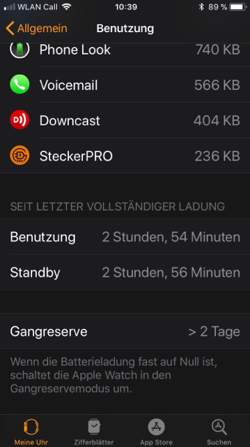

Check the battery info in the watch app. I had it already two times that something on the watch will not send it to standby and standby time was equal usage time. I shutdown the watch and started against this was gone.
Maybe it’s the Same on your daughters watch.
Otherwise I would recommend to do the same. Turn off the watch (keep the lower button pressed and slide „off“) and restart the device.
BTW. Found a screenshot I made.
It looked like this and the battery was already way down. Would say outbid n mind it dropped to <75%:
