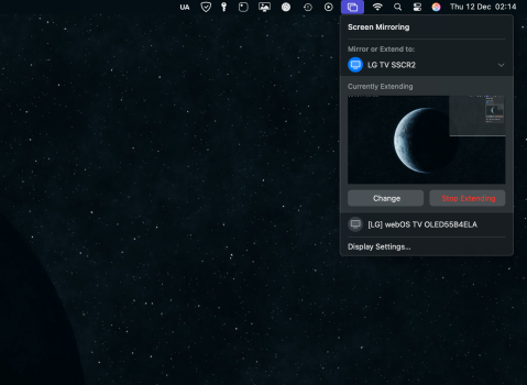

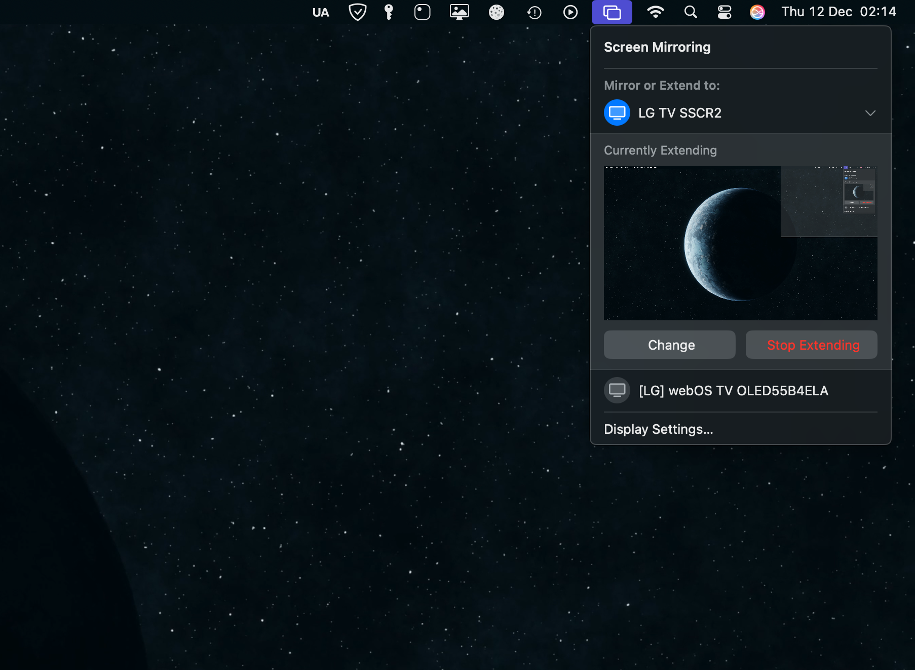

Hi,
I had this option pop up, not sure why as my Mac is connected to the TV and it's the only display.
This icon in toolbar is always lightened up.
How to get rid of this stuff?
Thanks

I have just had the same thing appear. I just updated and use a Samasung odyssey ark as my main screen and this has broken the display input. it worked just fine before 15.2.

You can remove that from the menubar. It's in System Settings / Control Center / Screen Mirroring. If you set it to "Don't Show in Menu Bar", it will go away.

Thanks, but why does it show at all? and shows as "extended"?
I have only one display connected via HDMI, so it's really odd.

Do you have an iPad to try Sidecar? I wonder if your main display would stop working as it did for @amiller039. If so, then your main display appearing as extended is more than odd, but indicative of a problem.

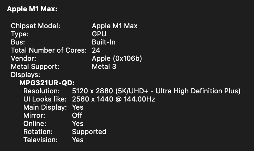

I have the same issue with a single external display connected via DP to the Mac Studio.

I don't use sidecar and I only use the one display so there is nothing really "broken" for me except that it shows "screen mirroring" as active in control center all the time and the extra icon in the menu bar (which I removed).
Still, it obviously treats the single primary monitor as an extended display - which it didn't do before 15.2.

I believe it was 15.2 beta.
M1 Mac Mini + LG OLED.
Reported the bug with screenshot to Apple.
EDIT:
Fixed in 15.3 Dev beta
