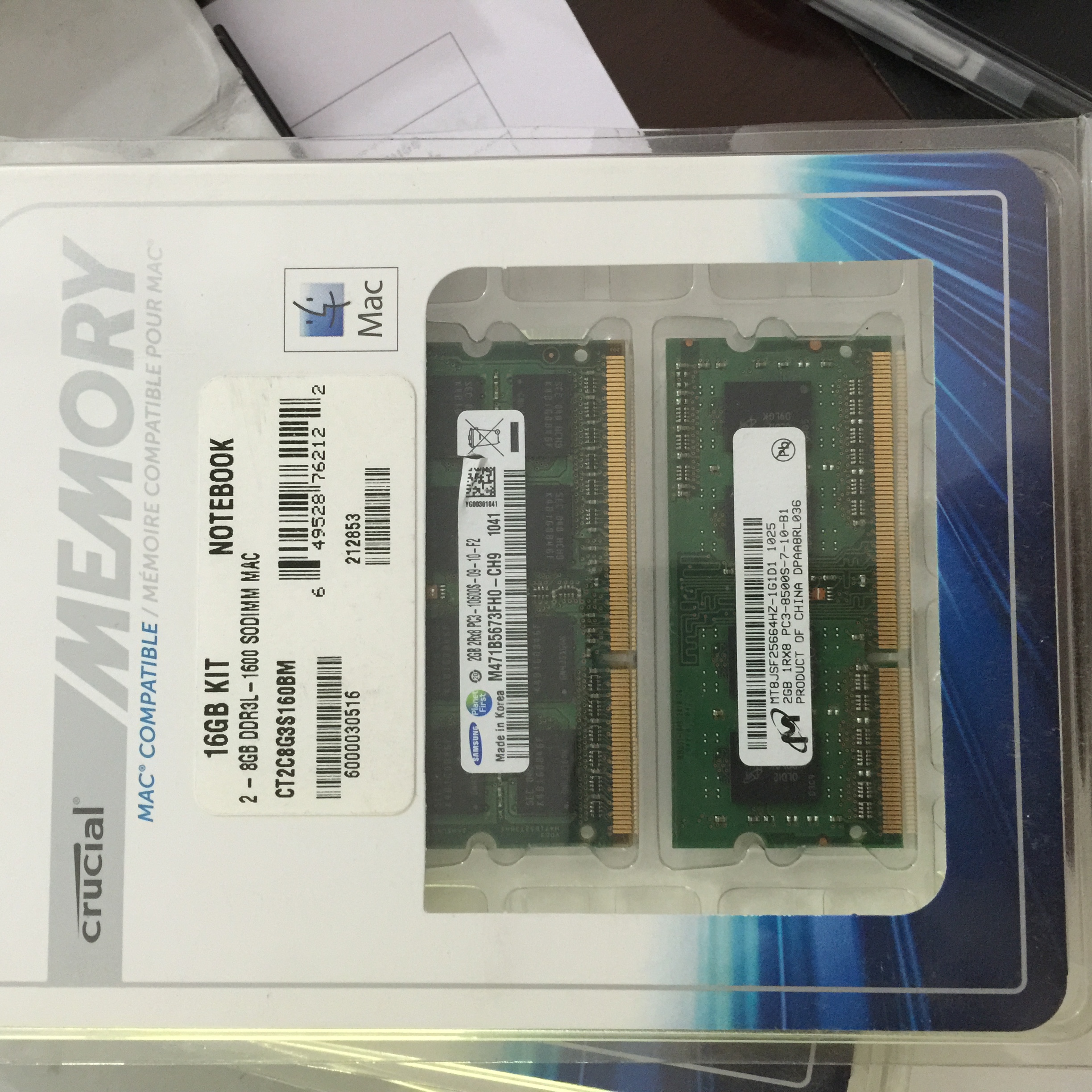

Hi, I have a 2010 iMac. It was running too slow, so I got a new SSD and I had 2 16GB RAM Kit from Crucial from last year, so I used that.
This is the one, I had. (see attached)
Installed the 240GB Crucial SSD.
And Installed 8 ,8, 8, 8 to all 4 slots of the RAM.

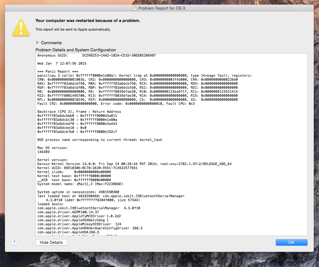

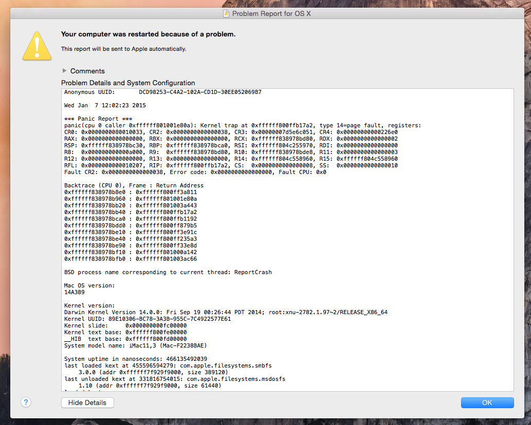

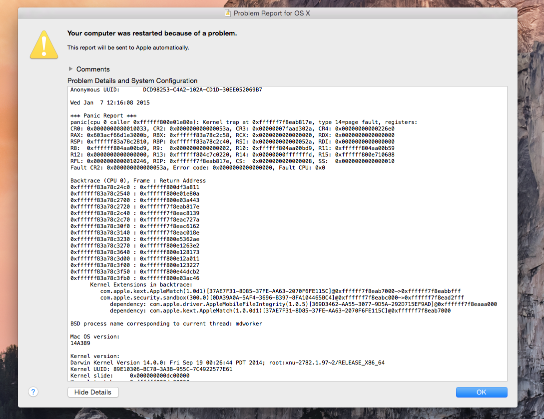

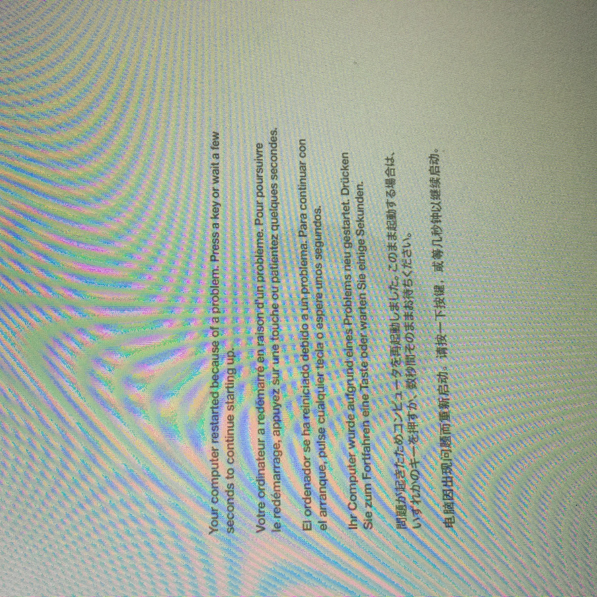

Now the problem is, as soon as the iMac is on and I do anything, the iMac restarts with error screen after 1-2 minutes.
See attached errors what I see.

Obviously the first issue is to get rid of the "24 gb" dimms. It's very likely the OS is trying to write to address space that doesn't exist and blowing up.
