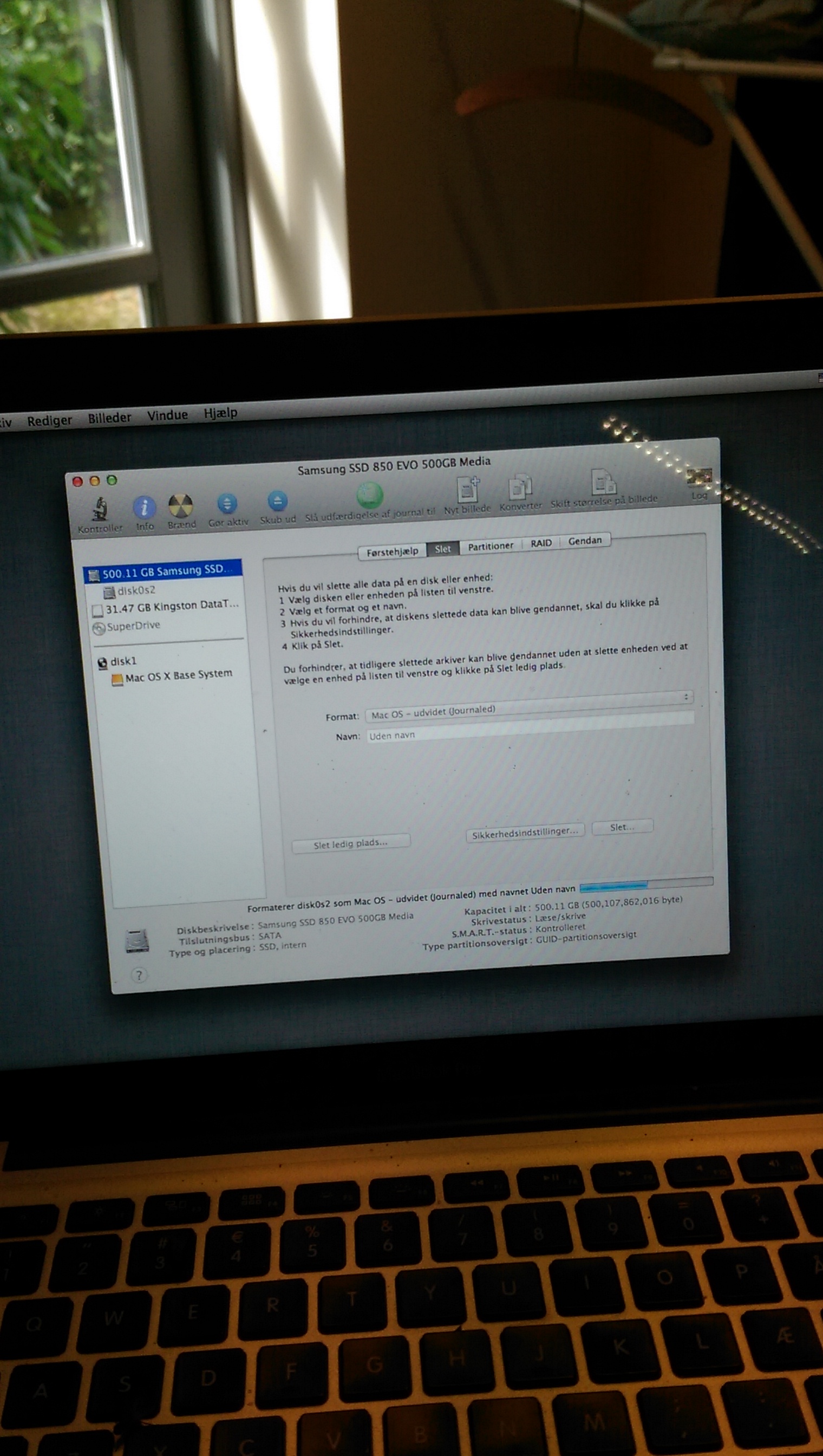

Hi
I just replaced the hdd with my new ssd (Samsung 850 Evo) on my MBP 2011 late and went into Internet Recovery to format the ssd to Mac OS Extended (Journaled) to do a clean install of OS, but it has now been stuck in the process of formatting for about half an hour... Should I cancel the process though it warns me that it might damage the ssd? Or what should I do? Really dunno what to do :/

Looks like you have everything selected properly to do the erase. Like T'hain Esh Kelch mentioned, it should take about ten seconds.
It won't hurt to restart and try again. If it still won't work, it is possible you have a bad drive cable. Fairly common issue with these.
Do you happen to have an external USB enclosure you can put the SSD drive in to see if it can be formatted there, just to eliminate the old cable as the issue.
