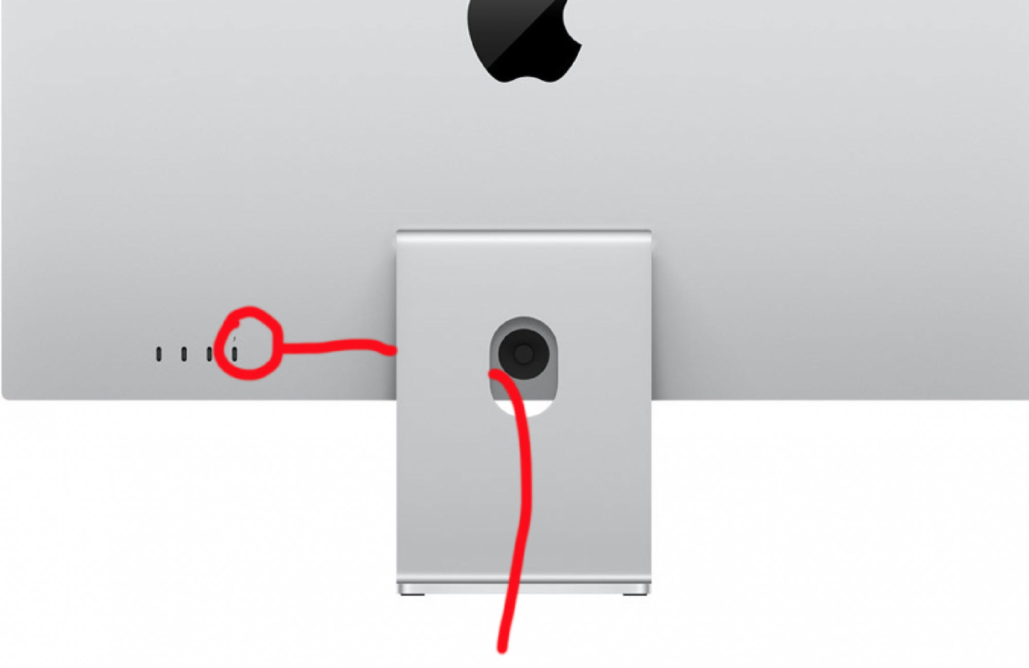

So it only having one thunderbolt port it looks like these displays can't be chained together? This also seems like a weird choice to have to plug the video cable in to the far side of the monitor, I would have expected it to come out from the centre, a lot cleaner...

No you cannot chain them together because there is only one Thunderbolt input port and no output port to enable TB passthrough.
And the center plug is for power, which is why the TB port is to the left along with the three USB-C ports to connect USB peripherals to the display.
You can
Well you can physically connect a second Mac Studio Display to the first with a USB-C cable, but I am not sure it will send a video signal from the first to the second and if it does, I am not sure it would be at 5K@60Hz or it would be 4K@60Hz.
The Studio Display does not have a second downstream Thunderbolt port.
A Thunderbolt 3 stream can carry two DisplayPort signals, both of which might be used to run the Studio Display at 5K 60 Hz 10bpc if the display acts like two 2560×2880 tiles like the LG UltraFine 5K does.
