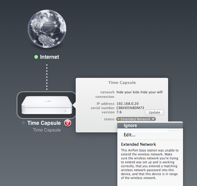

Thanks for the advice. I'm largely undecided because I got the TC for time machine backups.
What does the "extend my wireless network" option do- put it in bridge mode? Because that's what I have enabled right now and I'm getting the flashing amber LED.
I suspect the TC will do a better job broadcasting a network. I recently created a wireless heatmap of my home and discovered my regular modem/router was performing poorly in some locations. That might be something I consider doing when I get a moment.
Currently I'm faced with this error:
This is correct. Also, it will give you the option to ignore errors. I had a weird error on mine from time-to-time that would cause it to flash yellow. After some researching, it turns out it was some random harmless thing, so I ignored it and my light has stayed green ever since.
Okay so it was already in bridge mode, seemingly because I selected the option to extend my network.
I clicked "ignore" on the error and my light is now green- thanks!
