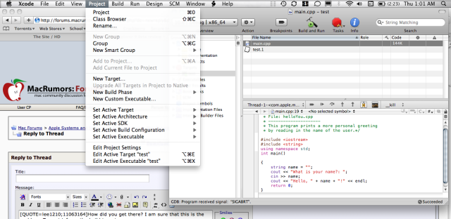

I go to the Project toolbar, and click on Edit Project Settings

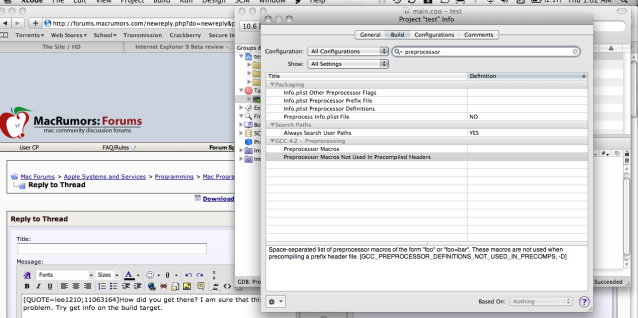

When I get there this is what I see after I search for preprocessor
Is that not the right place?
Try Edit Active Target "test" instead. As an aside, this is why I recommend using command-line tools until you really need an IDE.
-Lee
-Lee
Went into the Edit Active Target "test", same thing. I'm not seeing the GLIBCXX_DEBUG macro anywhere.
Looks like for "Configuration" you have "All Configurations" selected. Try to change to "Debug".
