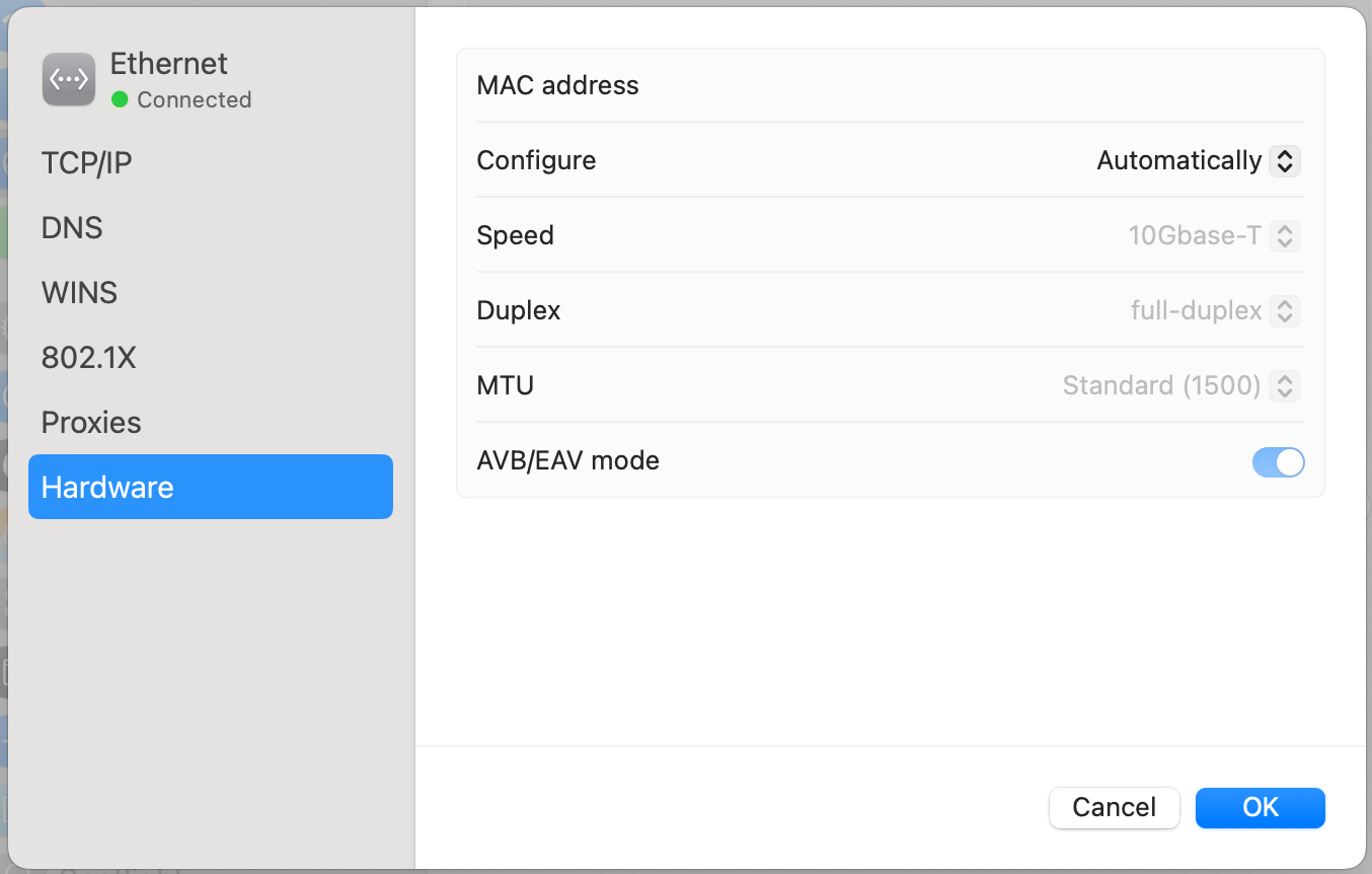

This is my Settings > Network > Ethernet > Details... > Hardware
Are you seeing similar?
