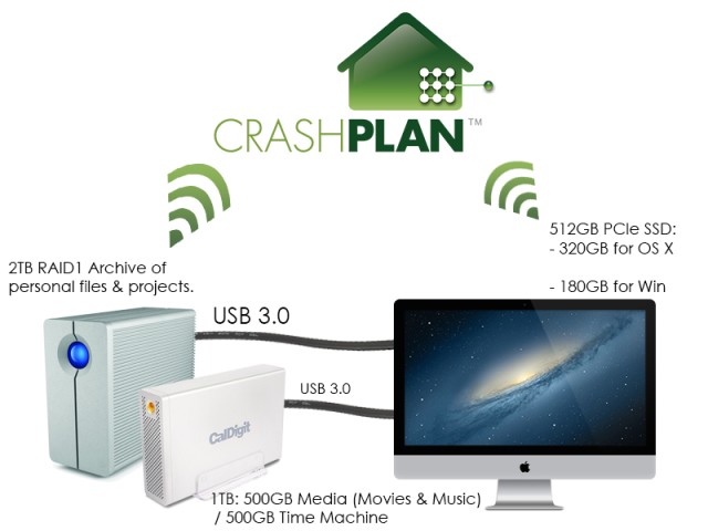

I'm not fully understanding what you're saying, but I know what you're getting at. I made this quick diagram to more accurately describe my backup plan. Does this help?

What about my diagram? Do you think that will work?
Yes it 'can' work.
I know of one person who has her external library of files on two different drives. She uses on directly and then has it cloned incrementally to the other drive. The latter of the two is used for the backup via Internet to the service she uses. I thought it peculiar but actually there is a logic to it - the first drive gets all the data and is "active." The 2nd drive only is active during incremental cloning of the first drive and thus is less frequently used and more available for on line back up service. Given the price of drives, I guess she did her self proud.
I do things as simple as possible.
i buy a USB powered 1TB drive, do my backing up and then unlpug and store it. I include a print out of the projects on the drive and any details I may want (I also keep a .doc file on the hard drive itself).
I use the USB powered ones so I don't have to worry about losing a power supply.
Yes it 'can' work.
