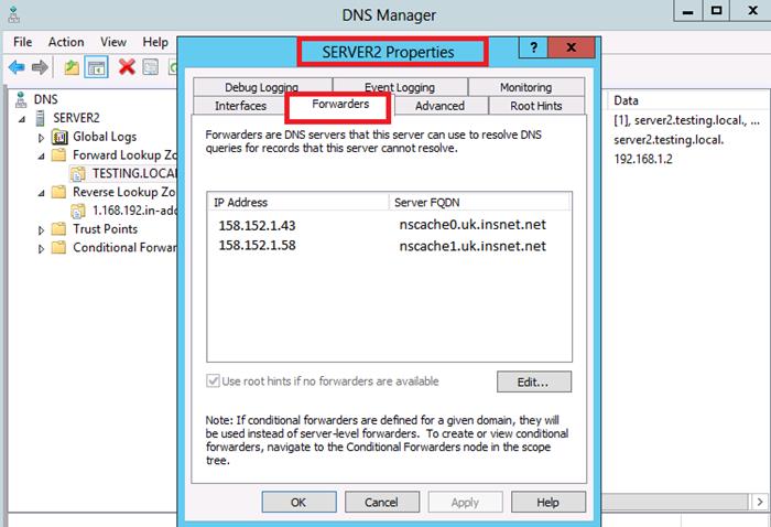

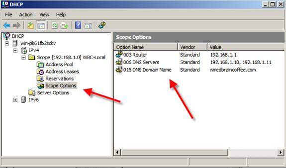

I have seen similar issues before when DNS and DHCP isn't setup properly on the Windows box (if DHCP isn't running on your Windows box, then that is half your problem). In DHCP on the server, make sure the DNS section only has the IP of the server in there (lots of people like to put things like Google's DNS as a backup DNS in here, never do that as it will cause problems with computers connecting to the domain).
Then go to DNS Manager and make sure you have some forwarders entered in there (google's 8.8.8.8 is fine):
Once you have done that, go round all the computers and make sure they are all set to automatically obtain DHCP IP in network settings.
