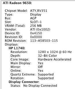

I have just received this card and when installed in my 1.25 MDD it will not power up, no light, no chime - nada.
Does it maybe require the pins 3 & 11 tape trick?
At first I did not think so judging from it being an Apple card but now I'm not so sure.
Someone can correct me if I am wrong, but that looks like a G5 card to me. Which mean mean pins 3 and 11 need to be taped.
However, I'm not sure if the 9650 works in a G4 even with pins taped. Perhaps Bunnspecial can chime in.
My general rule of thumb (with some loose exceptions) is "blue" circuit board equals G5 and "red" or "green" circuit board equals G4 when it comes to video cards.
Thanks for the reply Eric, I took the plunge (what the hell), and taped them up and sure enough that was the issue. Now I have Core Image which is what I was after.
