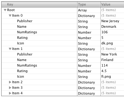

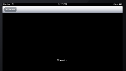

I'm working with the AdvancedTableViewCells Tutorial, and I created a New View that would show when a user touches a cell.
i.e.... if they click on "Denmark" then a new view would show saying "Cheerioz!"
Everything in the cell is from a plist.
What I would like to do is when a user clicks on the cell, the same data will be passed onto the New View.... i.e. Publisher, Name, Icon will show into the new view.
The advice that I got was to load the plist into an NSArray using -initWithContentsOfFile: and the path to the file in the bundle.
Then, in "didSelectRow..." , say the indexPath.row is 1. To access the Publisher of Item 1 (the second item), you would want the second element of the array, and of that element (which is a dictionary), you want the object whose key is "Publisher" .
I would write this... myLabel.text = [[array objectAtIndex: indexPath.row] objectForKey😡"Publisher"];

Ok, here is what I have in the "viewDidLoad" coding...
Code:
- (void)viewDidLoad
	// Load the appetizer.
    NSString *dataPath = [[NSBundle mainBundle] pathForResource:@"Appetizer" ofType:@"plist"];
    self.appetizer = [NSArray arrayWithContentsOfFile:dataPath];
And for the "cellForRowAtIndexPath"...
Code:
- (UITableViewCell *)tableView:(UITableView *)tableView cellForRowAtIndexPath:(NSIndexPath *)indexPath
	// Configure the appetizer for the cell.
    NSDictionary *dataItem = [appetizer objectAtIndex:indexPath.row];
    cell.icon = [UIImage imageNamed:[dataItem objectForKey:@"Icon"]];
    cell.publisher = [dataItem objectForKey:@"Publisher"];
    cell.name = [dataItem objectForKey:@"Name"];
    cell.numRatings = [[dataItem objectForKey:@"NumRatings"] intValue];
    cell.rating = [[dataItem objectForKey:@"Rating"] floatValue];
    //cell.price = [dataItem objectForKey:@"Price"];
    cell.accessoryType = UITableViewCellAccessoryDisclosureIndicator;
    return cell;
So, if it is already loaded - would I even have to reload it in the "didSelectRow..."?

Here is the coding if anyone is interested....
Code:
- (void)tableView:(UITableView *)tableView didSelectRowAtIndexPath:(NSIndexPath *)indexPath
	//Get the dictionary of the selected data source.
	NSDictionary *dictionary = [self.appetizer objectAtIndex:indexPath.row];
	//Prepare to tableview.
	DetailViewController *dvController = [[DetailViewController alloc] initWithNibName:@"DetailViewController" bundle:[NSBundle mainBundle]];
	//Set Publisher
	dvController.publisher = [dictionary objectForKey:@"Publisher"];
	//Push the new table view on the stack
	[self.navigationController pushViewController:dvController animated:YES];
	[dvController release];
	dvController = nil;
THANKS AGAIN!
Now, I hope it will be the same for way to set up the image.... ; )

But both Name and Publisher showed fine in the New View, but when I try to implement the icon, the app closes on me.
Can anyone chime in?
Thanks!
Hey!
Thanks I found the fix...
Code:
//Set Icon
dvController.icon = [[B]UIImage imageNamed:[[/B]dataItem objectForKey:@"Icon"][B]][/B];
What type of object does [dictionary objectForKey😡"Icon"] return? Can you assign it to a UIImage?
