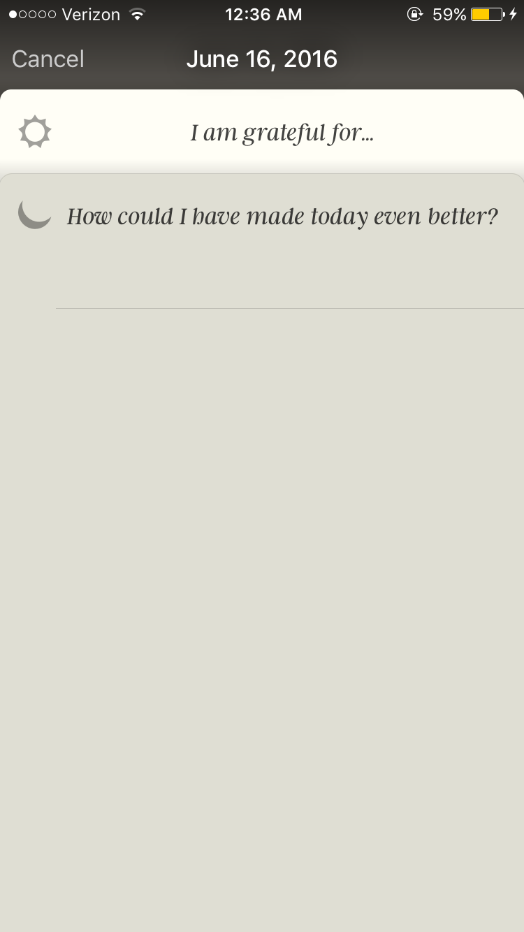

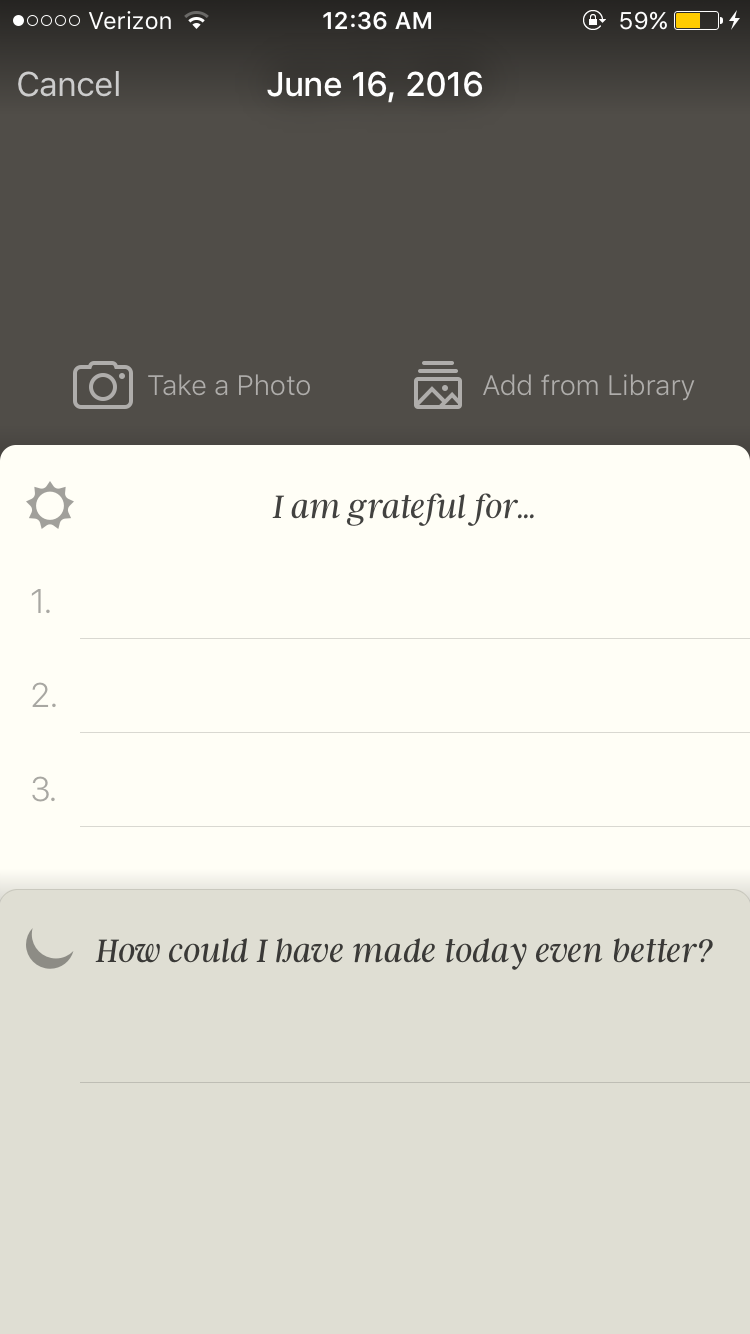

As you can see in the pictures I attached the app has 2 frames that can be dragged up and down and have curved edges at the top. How could I go about doing something similar to this in my app. What would i need to learn how to code to get this effect?
If you need more detail into what i'm talking about, ask me any questions. Any help or direction would greatly help me

The rounded corners are made by setting view.layer.cornerRadius = 10 (or a similar value). The images show only the top corners as rounded. I'll leave that up to you to figure out how to do that.
Code:
view.layer.masksToBounds = true
Adjusting the size or position of a view in response to a finger drag is a matter of using a gesture recognizer to track the finger and then adjusting the view's frame in the gesture recognizer's callback method. I think you need a UIPanGestureRecognizer. You could set view.frame but these days you're probably using constraints. You'll need an IBOutlet to the top constraints for your views and you'll need to set the constant property to force the view to update its frame. I think you're expecting the back view to never be completely hidden by the front view so you'll need to adjust the height of both views when the front view gets to a certain height.
