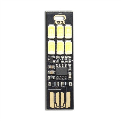

One of my power banks has a power saving "feature" that makes it refuse to stay on when the power draw is too low. I have a small USB light that is affected by the low power draw issue. Maybe yours has the same thing and will only charge the iPod when it is close to empty (below 50%), when the power draw is higher (The iPod Nano has a small power draw anyway). My other one doesn't have this.
