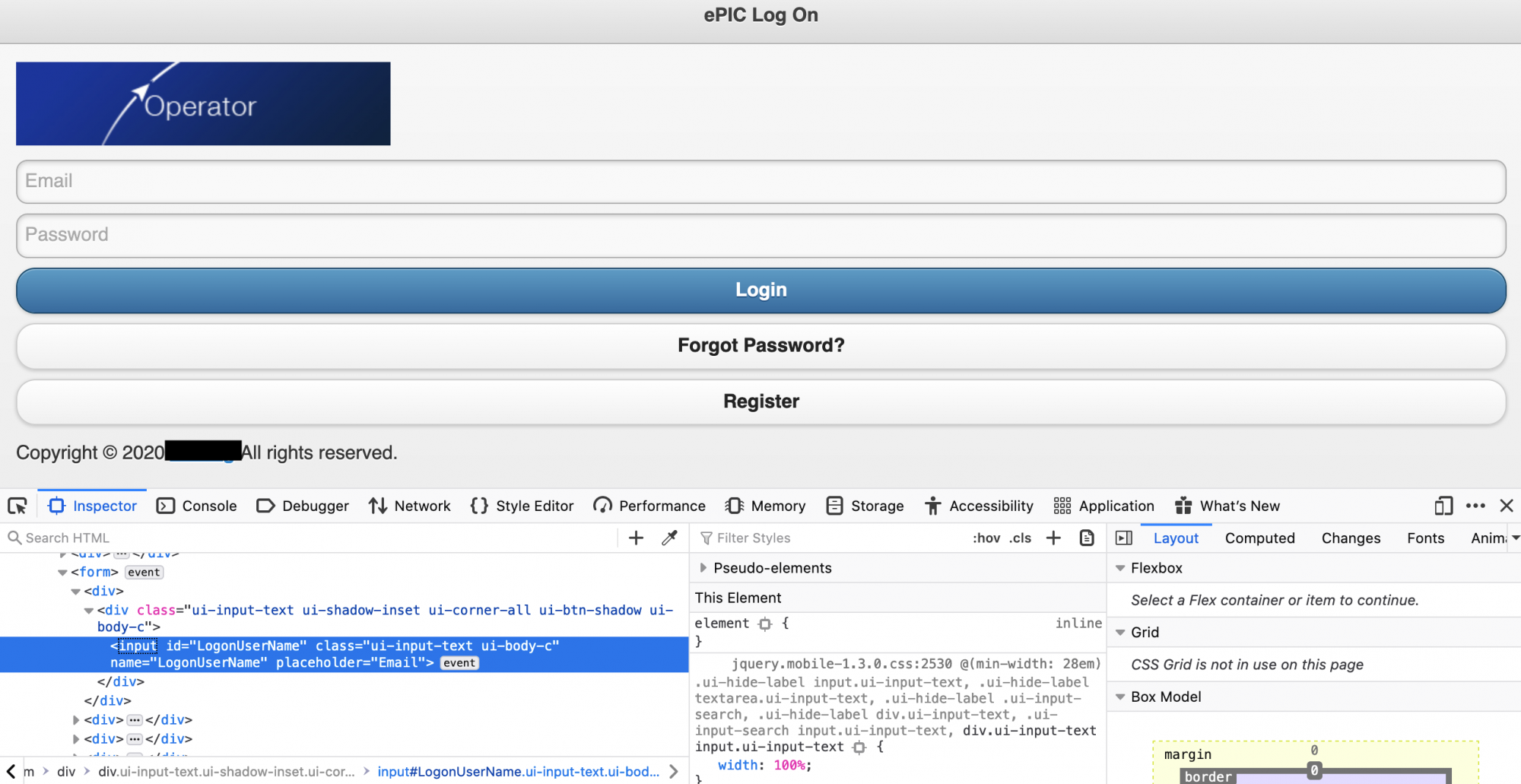

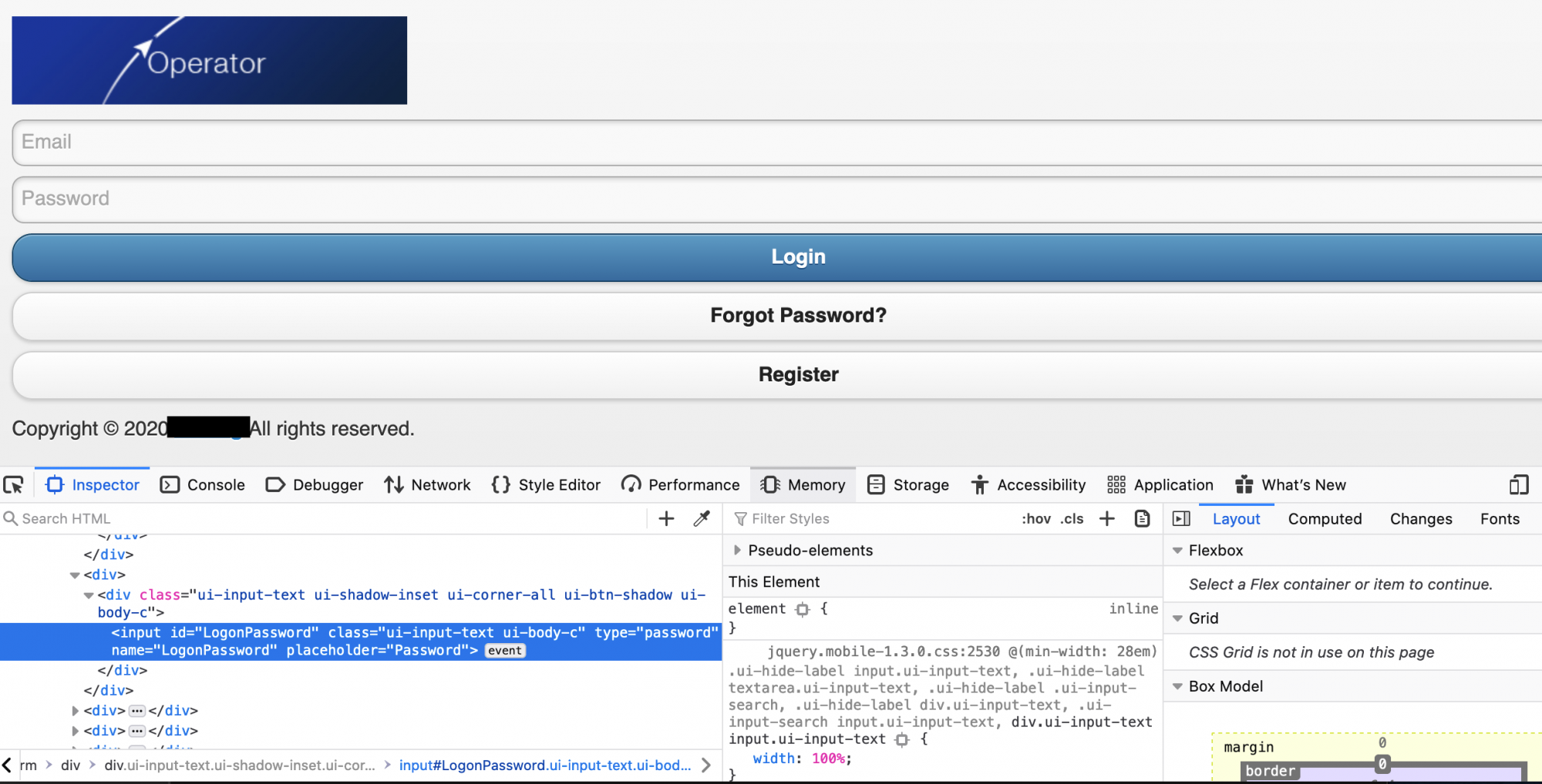

hmm if it's a web app then it should be pretty easy to get the data.
Just make a POST request with the username and password, make another POST\GET request to get the schedule and save the response.
You can easily do something like that straight from the terminal to test it:
Login to the app and save the cookies to a file to be used for later
curl --cookie-jar cookies.txt --form un=test --form pw=testpw http://example.com/login
un is the username field (inspect the page to see what's the real field's name)
pw is the password field (inspect the page to see what's the real field's name)
Fetch the data:
curl --cookie-jar cookies.txt http://example.com/schedule
To do it in Swift, use NSURLSession. Make sure you set a "normal" user agent just in case.

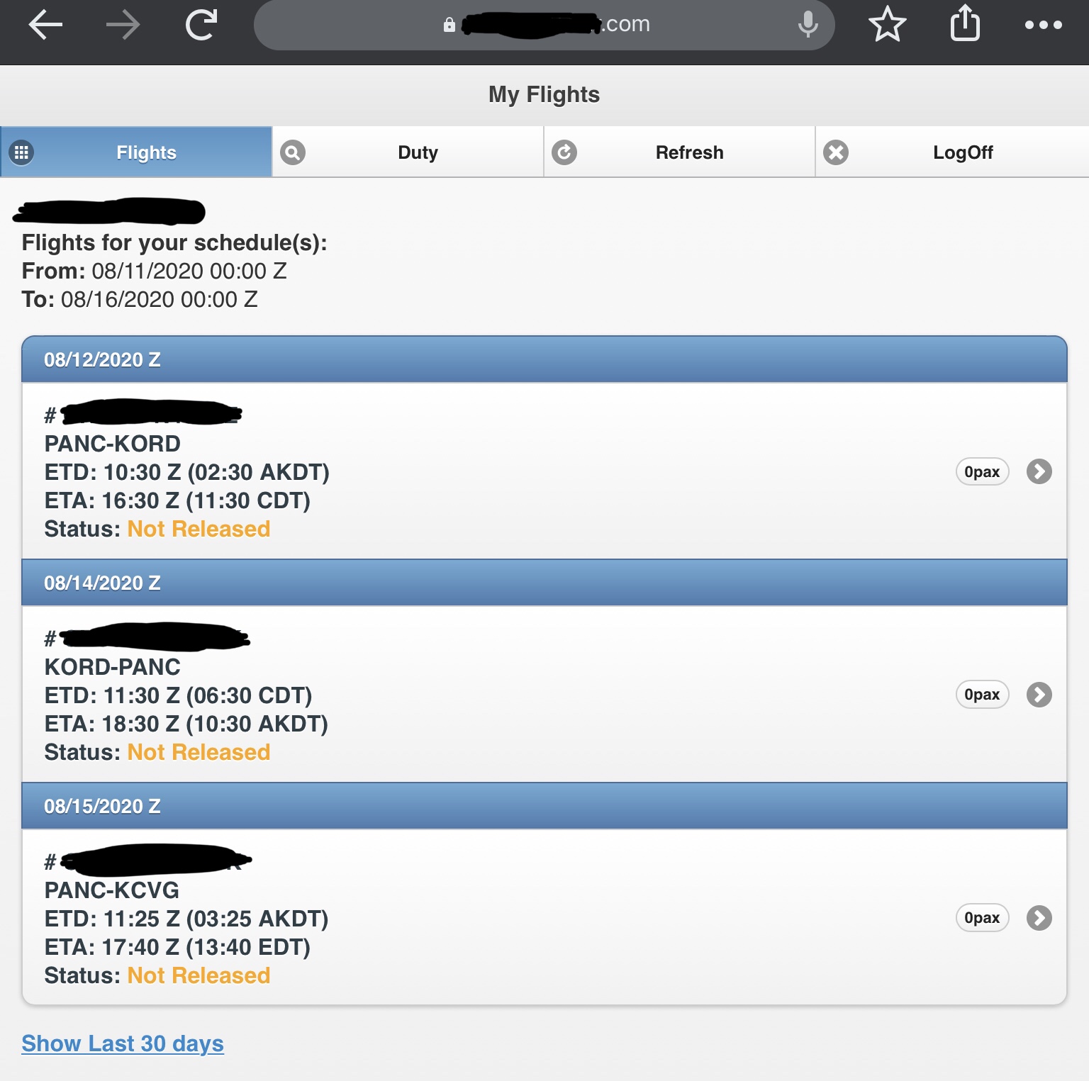

Here is a screen shot of the login page, as well as the form data presented after login. I'll pay around with all suggestions. Most of this is still way over my head unfortunately. I'm studying a bit every day though.
- Schout

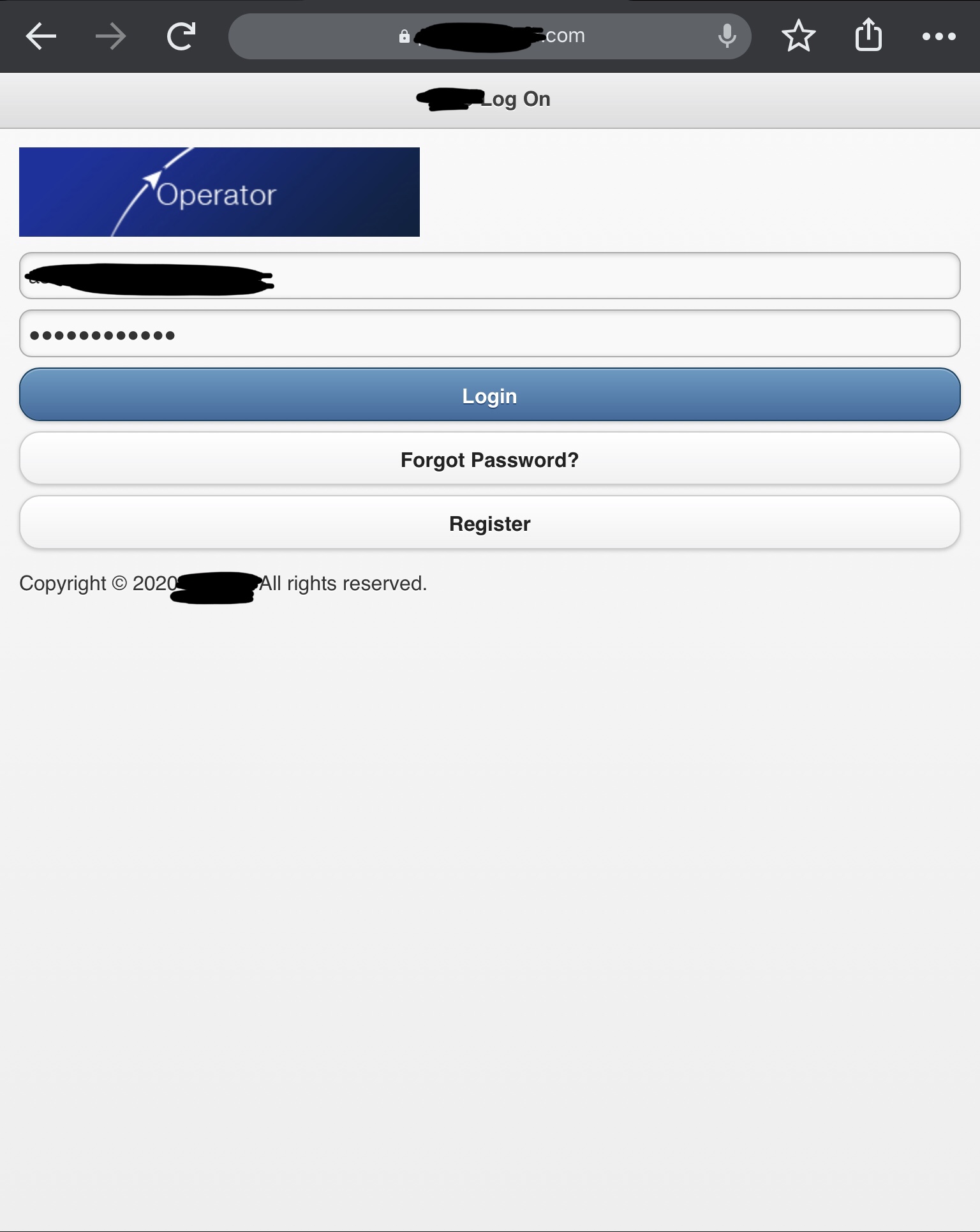

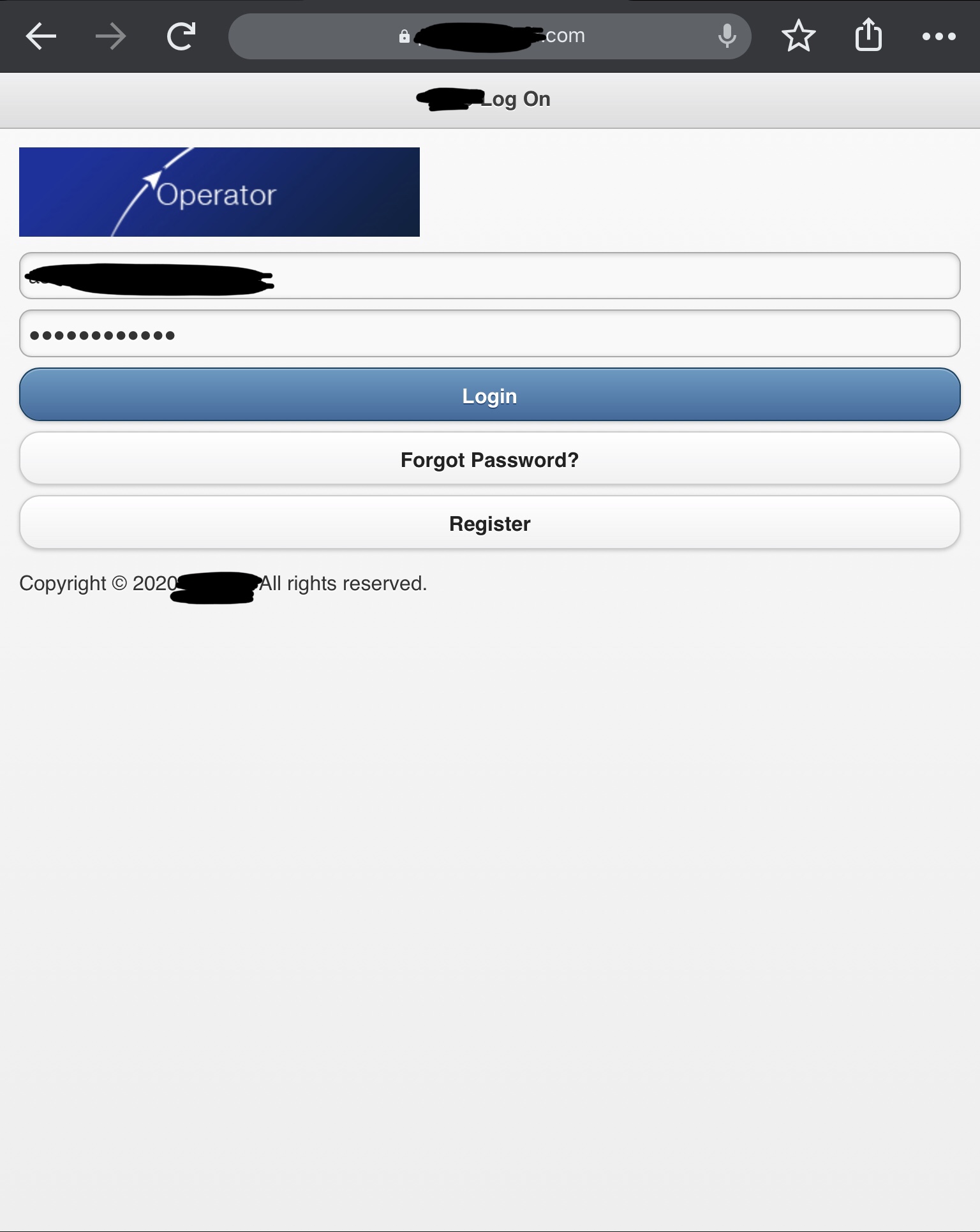

Still having issues logging in with cURL
If I use curl --user myusername: (space intention here so it doesn't insert and emoji) password https://example.mywebsite.com it appears to login. However, when I extract the entire URL https://example.mywebsite.com/testweb/Authentication/Logon?ReturnUrl=%2ftestweb%2f and try the same process it kicks back the page that says I've entered the wrong username and password. It works in a browser though...
- Schout
If this was in reaction to what was written about "inspecting" the name of the fields -
Enable Developer mode on your browser - I use Safari, so that's a toggle in the Safari Preferences. Then you can right click elements on a web-page and click "Inspect element". That will show you the corresponding HTML

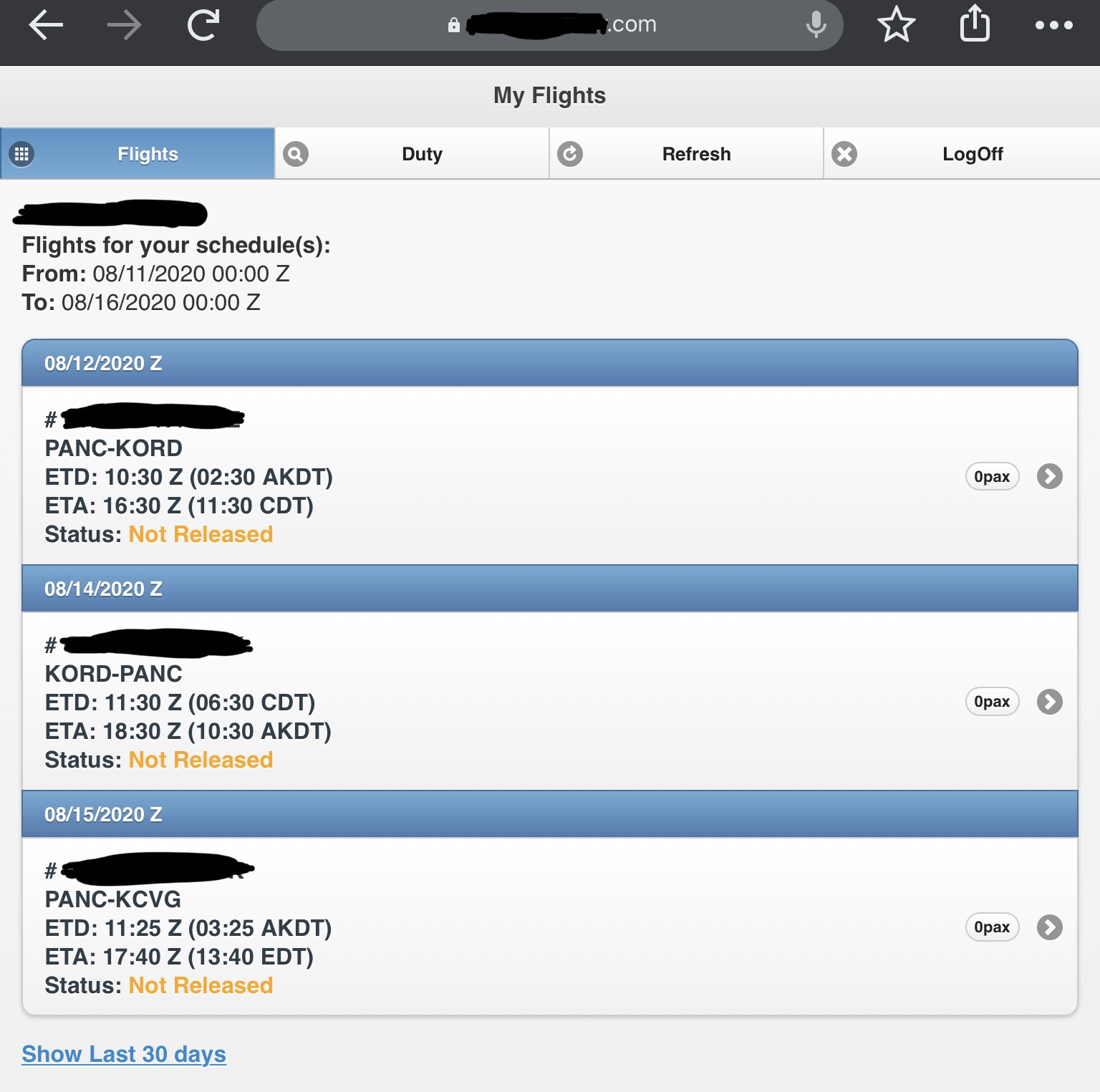

I'm very much new to this so I am probably having a hard time defining my problem(s). We have web based scheduling which requires individual credentials to log-in. Once logged in, it is possible to view your past or upcoming schedule (in various levels of detail). We spend a lot of time out of any kind of internet signal (like traveling on airplanes) but it would be super helpful to have access to the most recent data via an app.
I'd like the app to pull the data from our web based schedule and save it for viewing inside of the app. I think I can figure out the display part, but I'm really confused on how to send the credentials (log in) and then how to download the data and store it locally.
My vision would be like how an airline application works where your boarding pass and gate information are stored even when you are offline, and then refresh that data once connected again.
