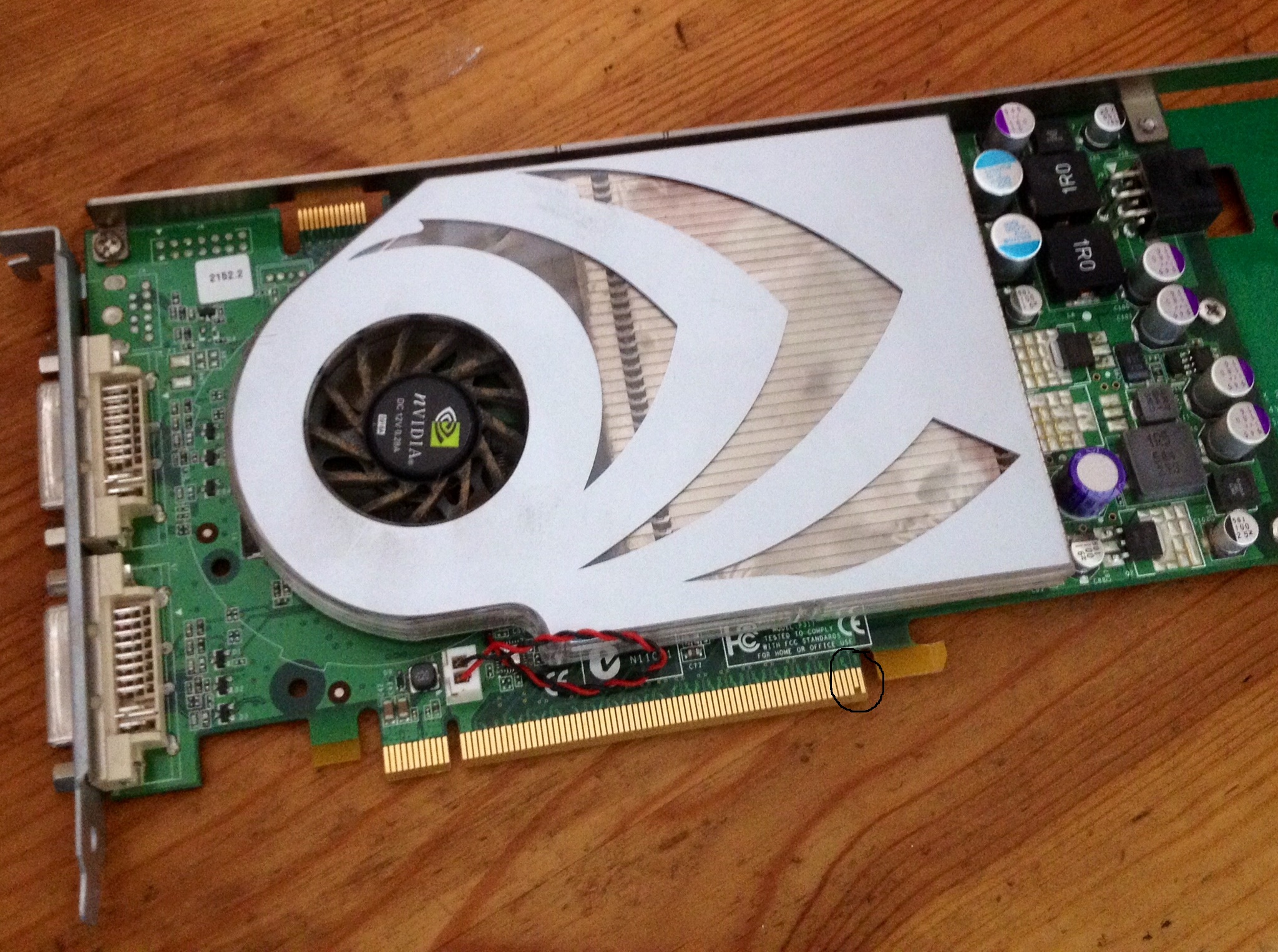

Graphic card clarification-G5
Hi,
This is the Nvidia graphics card out of my G5. Its a PCI-Express fitting.
In the picture I've outlined a section of the connection which is different from the rest.
Should this be like this or has something broken away hence my connection problems?
Comments please, thanks
