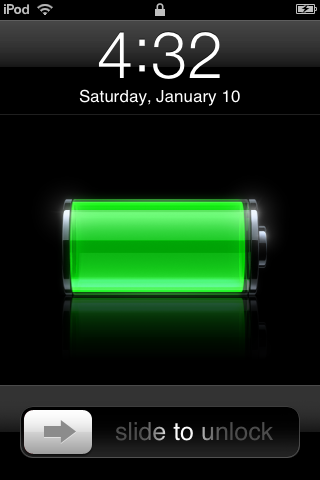

^^ Basically says it. I just installed Leopard today and plugged my touch in for the first time since then. Itunes won't detect my iPod though. iPhoto tries to import pictures from it and it charges but iTunes won't detect it. What's going on?
yup iTunes is up to date and tried the other port, neither worked. I had to install new quicktime to open iTunes after the Leopard install, if that may have something to do with it...
tried a hard reset too and that didn't work.
edit: the iPod has been plugged in all night and the charge bar won't make it all the way over, is there something wrong with my iPod?
This little won't go away, I know it normally goes all the way across, I've made note of it.
Maybe try restoring the iPod, it's an ipod touch, you do have a backup right? otherwise i'm stumped.
I got it figured out I think, I had to take off iTunes and re-install it. The battery still won't show that it's charged all the way so I'm going to try to calibrate the battery and see if that works. Hopefully everything stays working after a shut down or what not.
