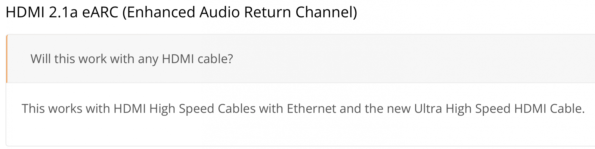

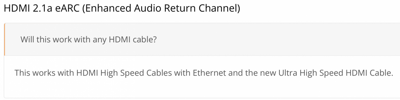

I see, so if I buy a hdmi 2.0 cable eARC would still work correct?
For Apple TV 4K (2nd gen), 2 types of cables will work:
48 Gbps (Ultra High Speed): If you are buying a new cable, this is the cable to buy. It doesn't cost significantly more than the next cheapest kind (less than $5 premium, unless you need a very long cable), and you will be able to avoid any confusion when reusing this cable with other devices. This cable is required when outputting 4K 120 frames per second or 8K, neither of which Apple TV 4K (2nd gen) is capable of.
18 Gbps (Premium High Speed with Ethernet): If you have one of these cables already, go ahead and use it. Apple TV 4K (2nd gen) maxes out at 4K Dolby Vision 4:4:4 60 frames per second. Even with DTS-HD Master Audio or Dolby TrueHD, neither of which are currently supported by tvOS, Apple TV won't exceed 18 Gbps.
