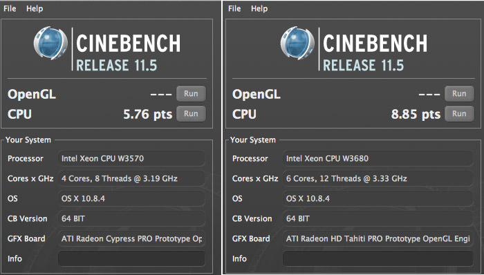

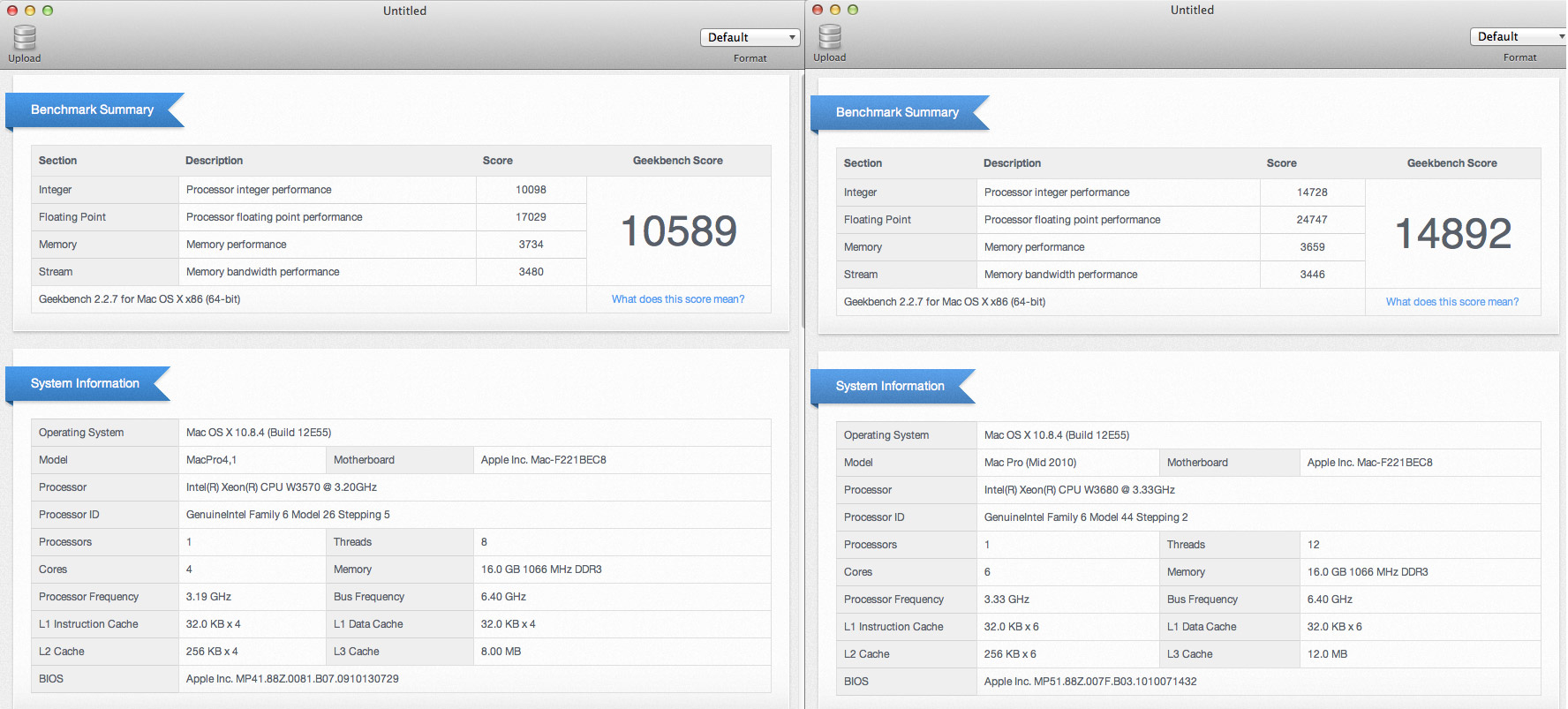

If you need comparison between 3.2 Quad and 3.33 Hex see attached screenshots. I've upgraded mine 4,1 first with W3570 next with W3680.
I'm using 1066 MHz RAM, so scores with 1333 MHz one will be a bit higher.

Numbers look good. Looks like it increases performance by half. I think the new iMac is only rated a few points higher.
