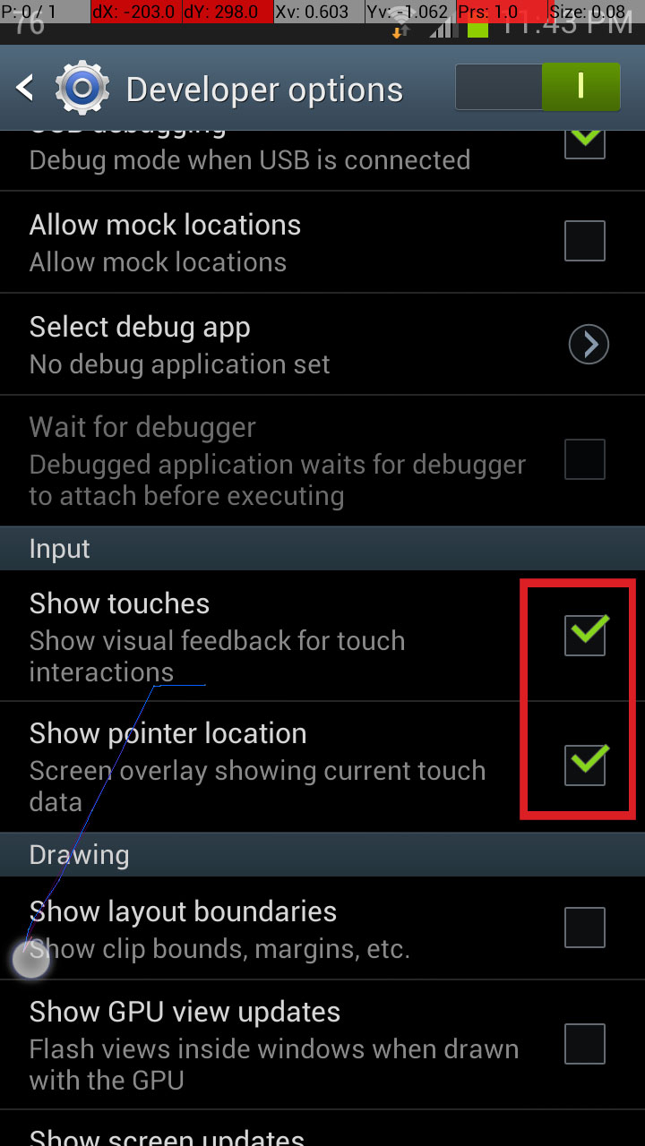

Have you tried turning on "Show Touches" & "Show Pointer Location" in:
Developer options>Input
If the touches show up but the screen doesn't react it would probably point to a software/os problem instead of hardware. If that's the case a restore may work.
Restore only made it worse. Added another video in the original post. And here is one with those checked:
