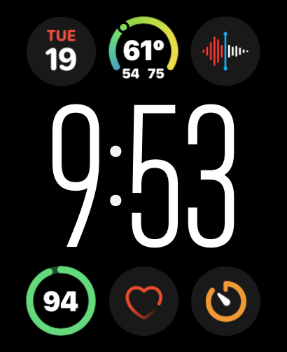

Image 1shows my original configuration. Everything worked, except for NM. The top middle complication is for my Tempest weather station. Not sure why the day shown is Tuesday, I didn't get the watch until Friday. Is there a Wayback machine on the Watch? 😄

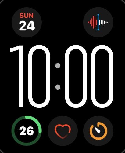

Image 2 is my current face that's working perfectly!
I began to change positions and swap out other complications and found that (on my watch face at least) the top middle and bottom middle spots were pretty picky about what was there. The top was more sensitive. I found that leaving that blank worked perfectly with NM and my preferred complications.
I can get to my weather station app easily enough without it being displayed. But darn it, I do like how it's displayed on the face with current, low, and high temperatures. Also liked being able to tap that and bring up more data.
