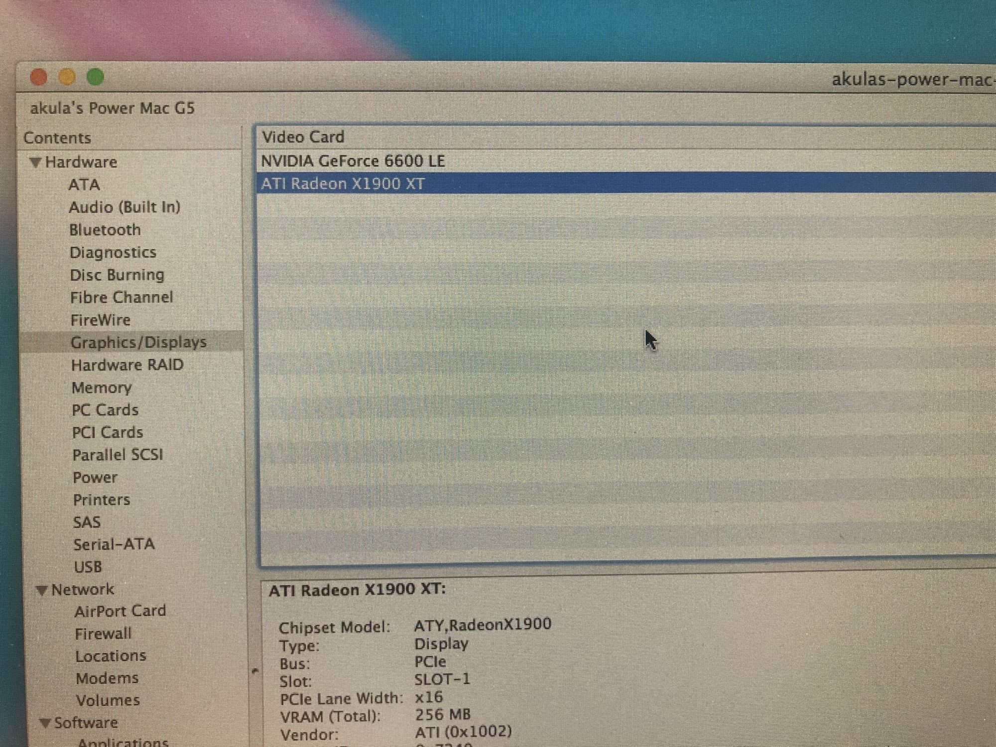

I’ve acquired a x1900gt for cheap on eBay and I’m really having a hard time to get it flashed power pc.
I firstly tried to use AtiMultiflasher on Leopard in safe mode but nothing happens on reboot? ( card seen on system profiler as no kext loaded )
Then I’ve put the card on my pc workstation but it gave no output at all.
I’ve managed to install it on windows 10 with legacy drivers as a secondary card with another non UEFI card and ran furmark with no issue on the x1900 using also the dvi ports on separate monitors. ATiflash under dos or windows doesn’t see the card, but gpu z and windows can see the card (minus the bios version?) so I can’t flash it PowerPC.
I’ve also tried with a ch341 programmer but it shorts when connected to the bios chip. I suppose if it was fried wouldn’t complete 3D stress tests?
Also tried it on an old amd Athlon correct era feeding the extra power from my g5 but no video out too.
Kinda lost right now, anybody has any idea? Thanks

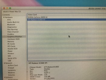

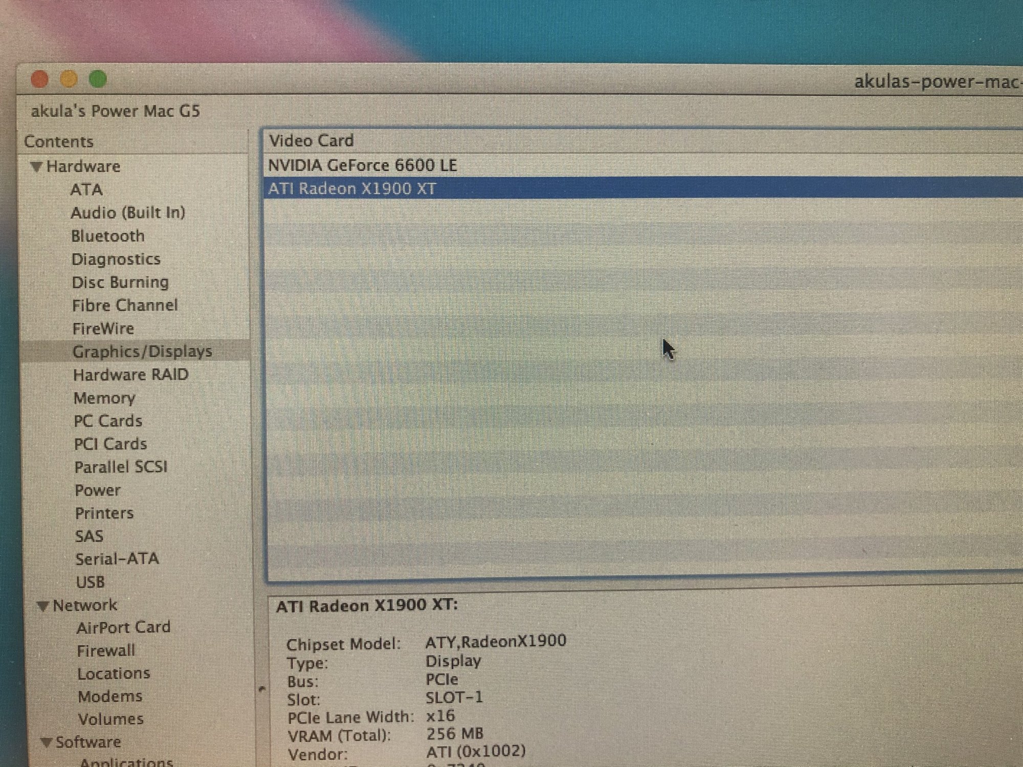

It has been recognised and worked straight away! Thanks so much

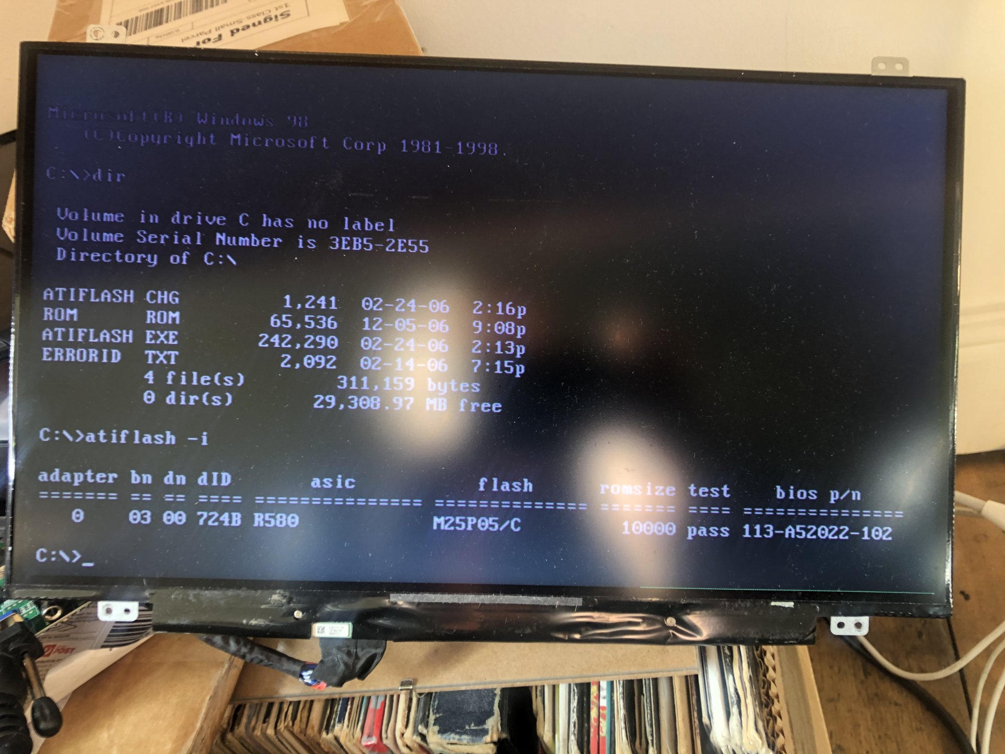

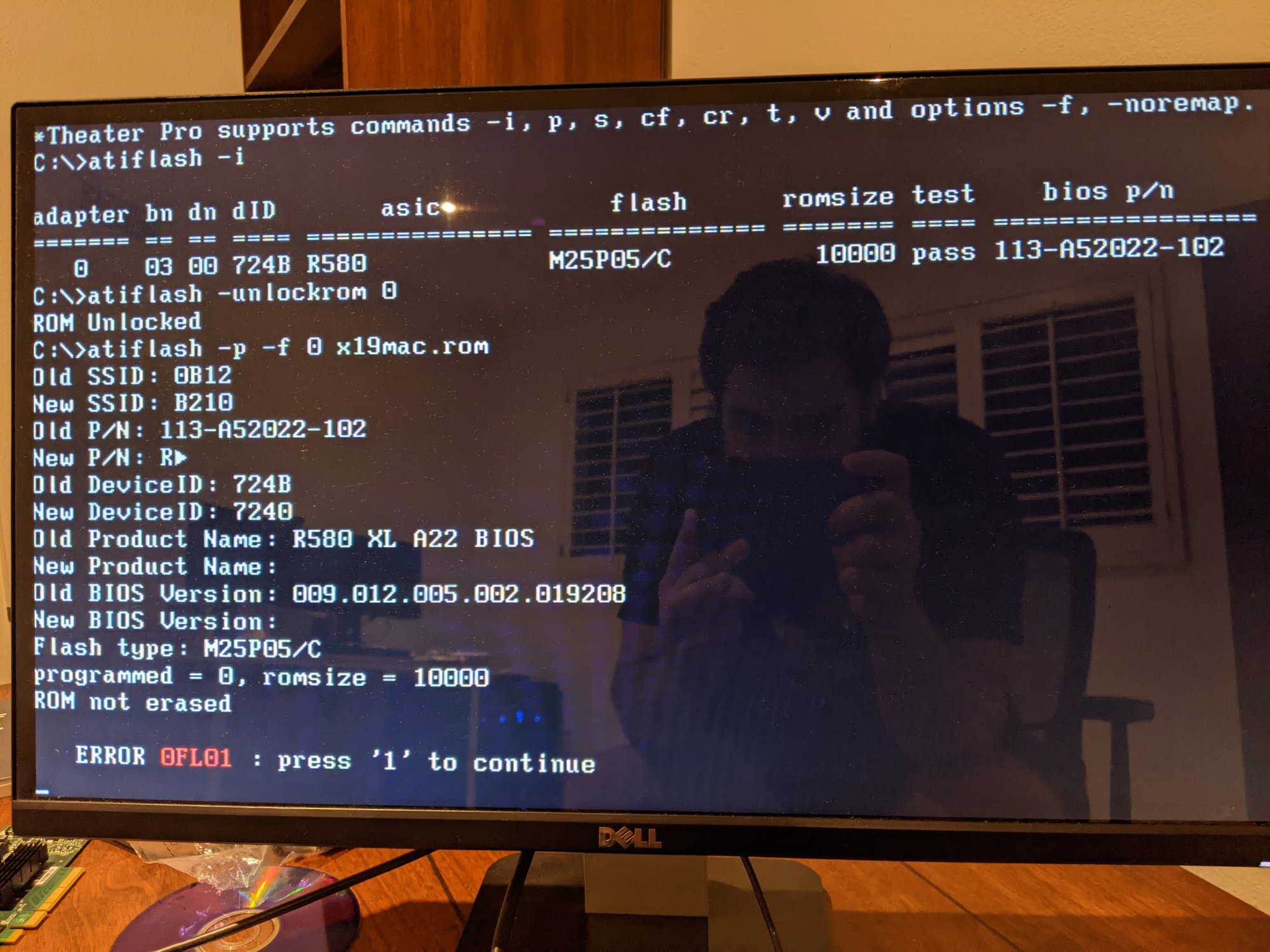

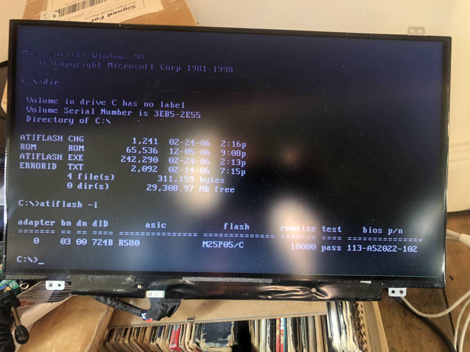

Hi everyone. I'm having a hell of a time flashing a Connect3d x1900gt with the MacElite x1900gt rom. Here are all of the things i've tried.
  1. Tried with dual PCIe video cards, single gpu. Using FreeDos to boot.
  2. Tried totally separate system with intel igpu and gpu.
  3. atiflash 3.15 - Won't recognize the card
  4. atiflash 3.99 - Sees the card but tried every flag I can think would make a difference just gives the error as seen in the screenshot.
  5. Tried a mix bag of versions of atiflash and the ones that can see the card gives the same error or variations on Invalid PC BIOS Image, Rom Not Erased, etc.
So I've never gotten it to flash at all. What the heck am I doing wrong here?? I've uploaded both the dumped rom as well at the EliteMac x1900gt rom for your reference.

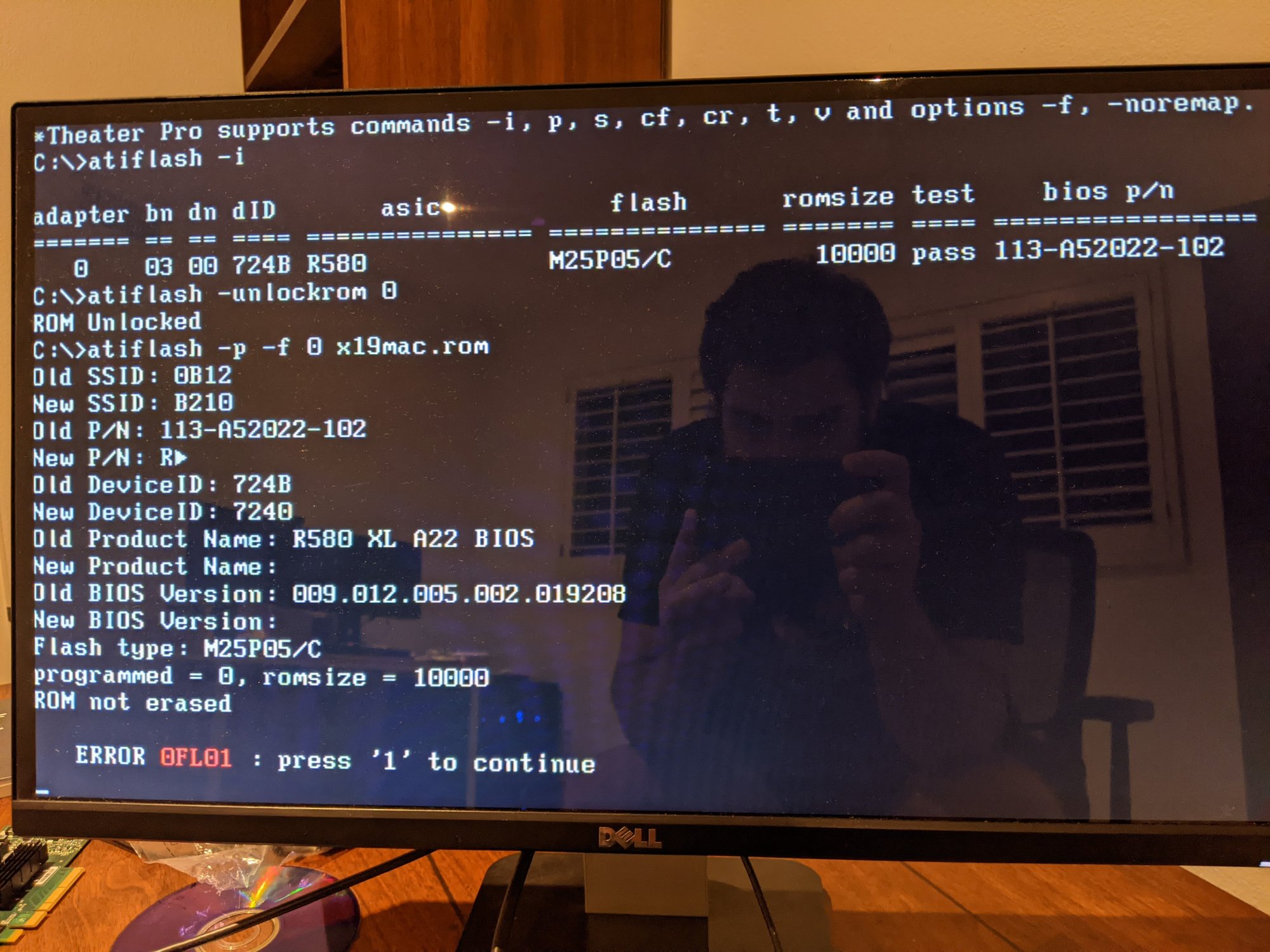

You try actual MS Dos? Because it could be something as simple as that.
@thespecificocean Have you tried ATIFlash 4.07? If memory serves, I had success with using that version to flash an X1900 GT Rev. 2.
Not sure which iteration of DOS I used, though. I believe it was FreeDOS.
Yup tried all of the 4.x variants.
[automerge]1600747040[/automerge]
Just tried with a Win98boot.iso I just found and exact same errors :/

Should I try flashing on a board with PCI graphics? Thats the only thing I haven't tried at this point.
