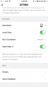

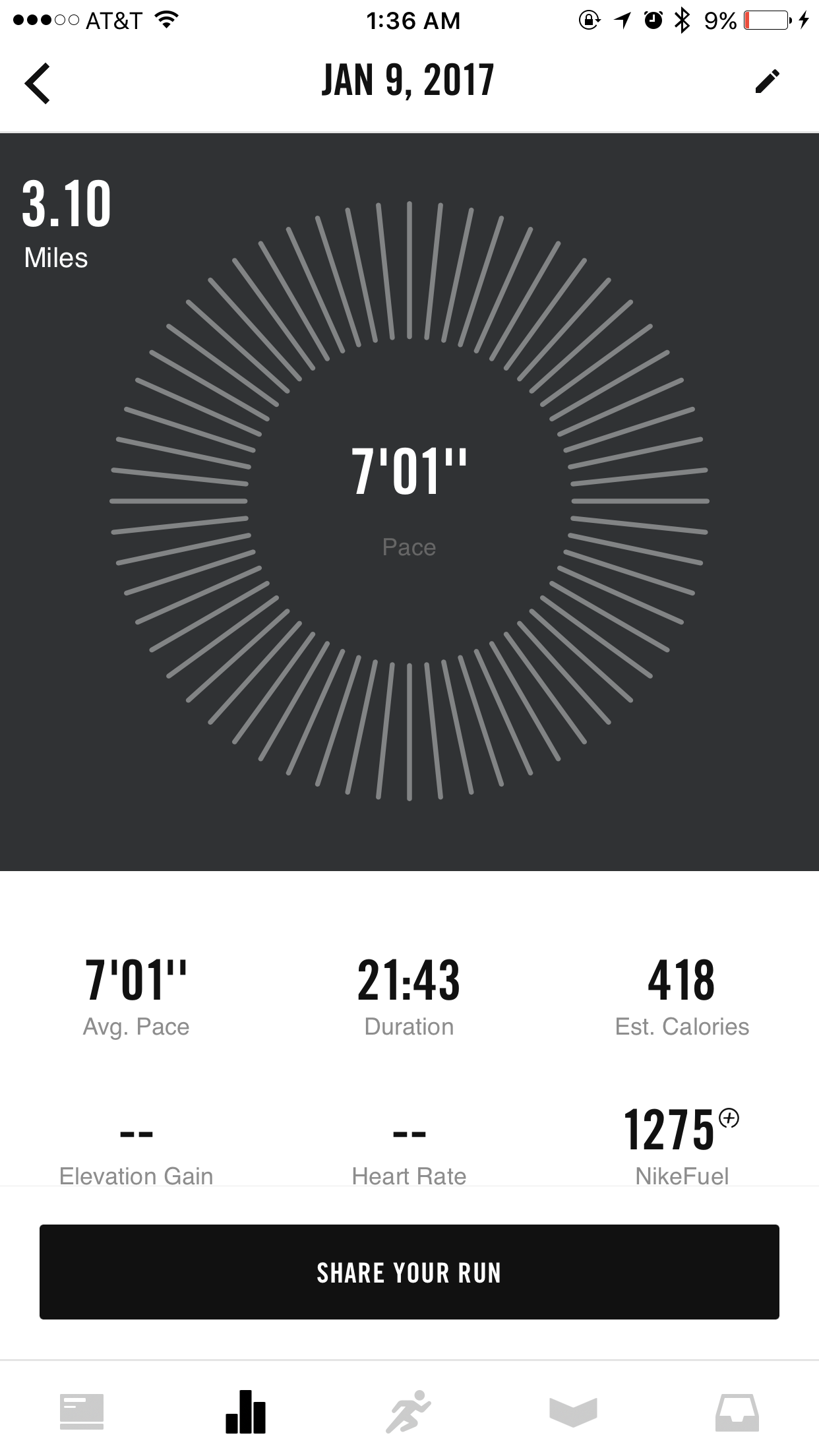

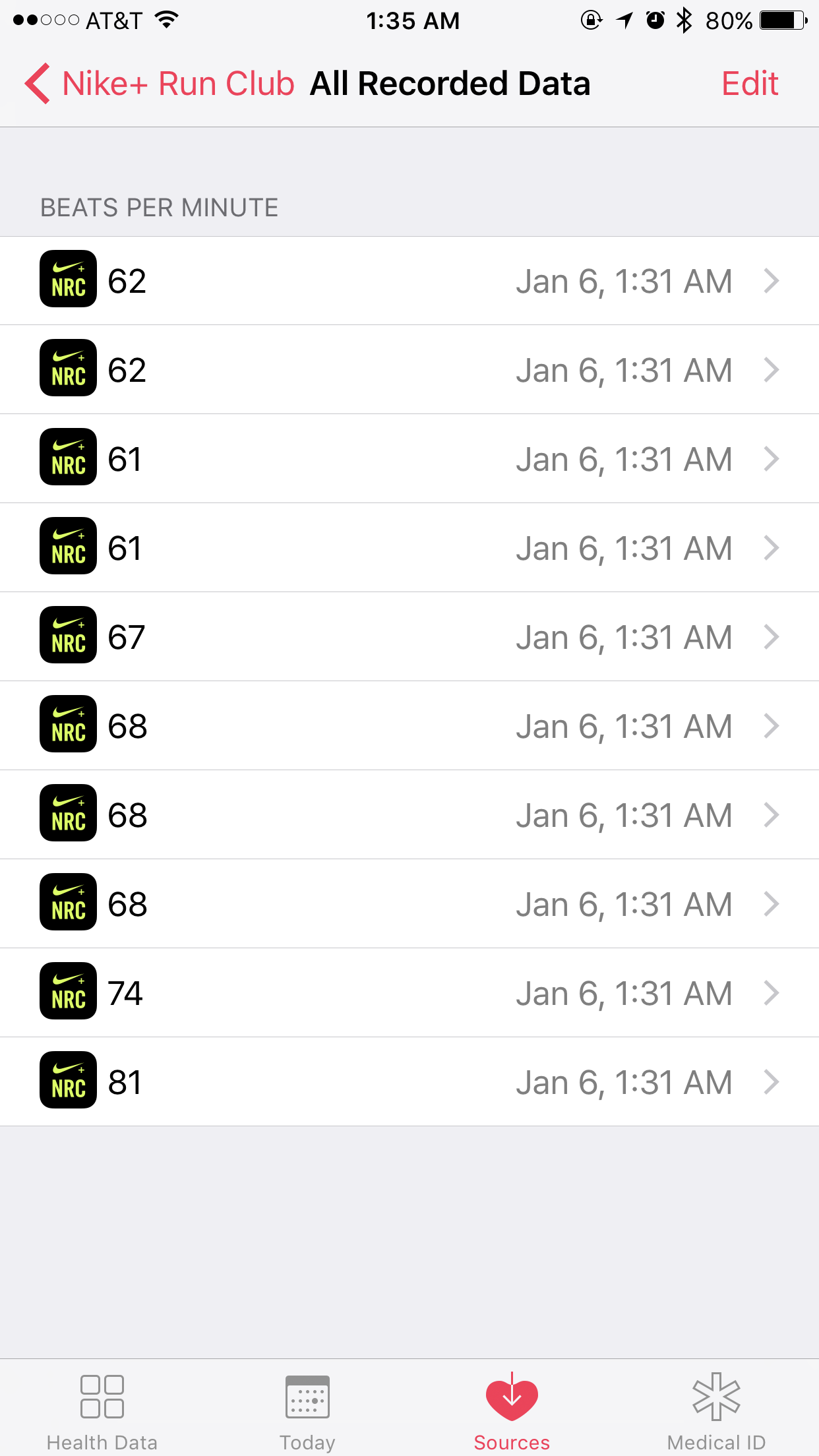

When I run with the NRC app on the watch series 2 with or without the iPhone. I am still not getting it to log the heart rate after the run. Does anyone have it work? Am I missing something or a setting?
Make sure you have the correct setting on the Apple Watch. On the start screen, scroll down to the settings and turn "All Metrics" to the ON position.
The setting in the picture you attached is on the iPhone, so it's looking for an attached HR strap/monitor on the iPhone.

Another thing to check is your Health app data on the iPhone. Go to the HR data and check to see if there's any HR readings during the time(s) that you're using the Nike app.

Thanks for the tip. Unfortunately it has been days. So in my case it is something else. It should not be this complicated!

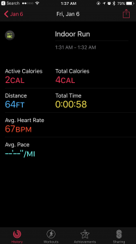

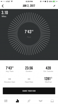

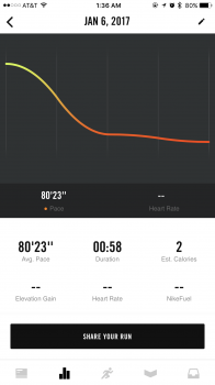

[doublepost=1483684825][/doublepost]Ok all of my settings are correct. I just did a test. ON the activities apple app the workout shows up with a HR from the watch. I then went into the NRC app and it is not there. I have deleted the app and reinstalled and the same conclusion is reached.

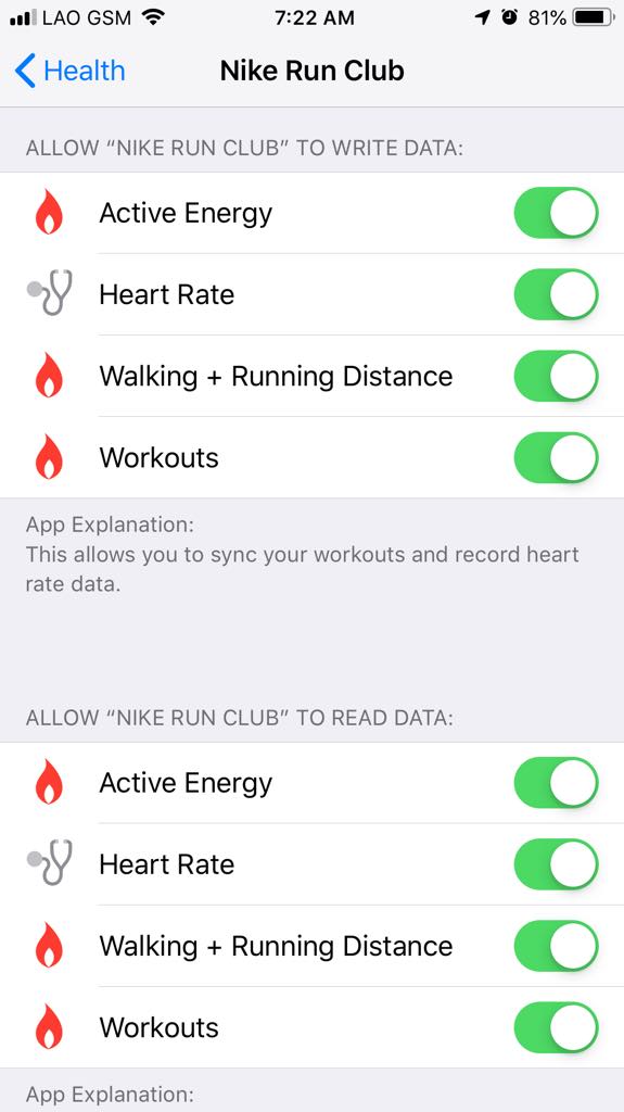

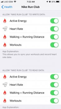

4) Go to Health App on Iphone
5) Go to Sources
6) Click Nike + Run Club under Apps
7) Scroll Down and Allow Nike Run app to read data (Heart Rate is one of them. I allowed all)
That should do it.
For your runs, if you have a circle and not a map, it means that you are in "Indoor" mode. It thinks you are on a treadmill. Before your run, make sure you are on "outdoor". Scroll all the way to the right and make sure Indoor is "off"
You might have found it already, it's in the setting of your health app on the phone.
See image attached
