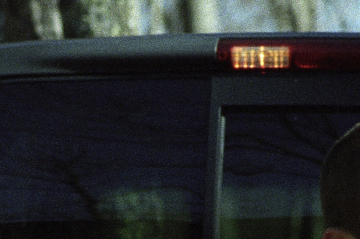

Here's a comparison I threw together several years ago with a random negative from probably 2007ish taken on Kodak 400UC(a negative and not a slide, but the comparison stands). This was most likely processed by a Walmart on-site "One Hour" lab and I picked it because it has a nasty scratch and I like the composition enough that I think it might have potential if I wanted to massage it.
Don't remember the exact equipment, but a Canon New F-1 with a 50mm f/1.4 would be a good bet. It was plenty sharp.
First of all, the negative with no correction on the Coolscan V in Vuescan
I'm going to pay particular attention to an area on the truck back window since it has a prominent scratch and several dust spots.
First of all, a crop of that area with no correction
Now, Vuescan with the dust and scratch reduction cranked up to high
Notice that while both the scratch and the dust are reduced, they're still there.
Compare that to ICE from Nikon Scan
A couple of the bigger dust spots are still visible, but the scratch is gone completely as are the smaller ones.
