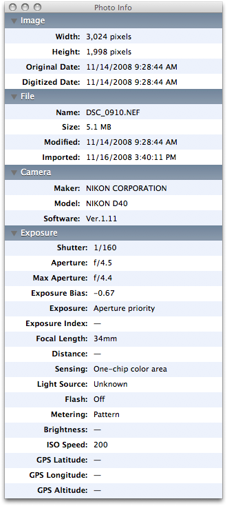

Are you using your kit lens? couldn't really get the exif data from your flicks, so what aperture did you shoot with? could you get any closer to a lower f number?like 2.8 maybe? try the built in flash as compuwar if i'm not mistaking was suggesting in fill mode
First one:
Second one:
you see, the aperture you've used is f4.4 and f5.6 which is the "smallest" on your kit lense,if i'm not mistaking,while the "largest" would be 2.8,so try that
