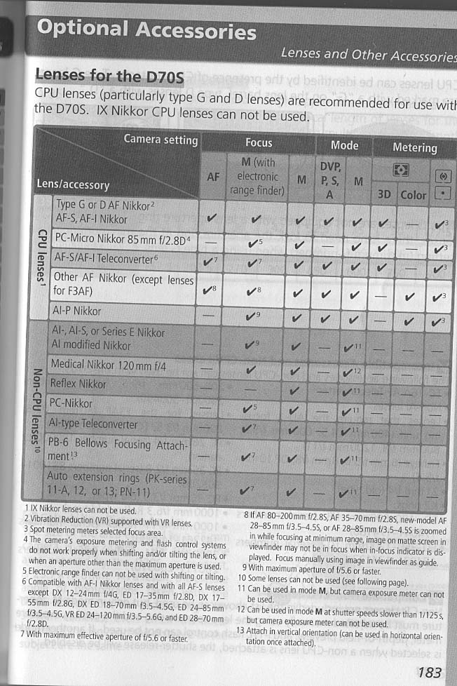

Silentwave said:
There is absolutely NO restriction on what lenses conforming to the Nikon AI or CPU standards can be used on digital. None.
Not sure how you meant this. See attached lens compatibility chart for the D70s.
Yes, most any AI or later Nikon F mount lens can attach, but there are restrictions on metering and the such. As a note the D200 and D2X allow for AI lenses to be used for metering.
Sigma and Nikon have not and most likely will not be making DX/DC telephoto zooms outside the consumer range. Once you get to constant-aperture lenses of that focal length, the lens MUST be that big and will cover the larger format anyways.
