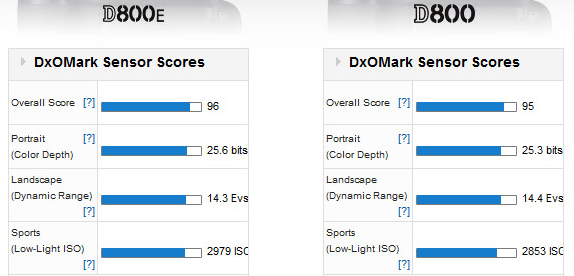

There is minimal difference according to the DxO mark testing, which is either useful or a load of rubbish depending on your opinion.
96 is the highest score ever awarded.
Credit: DxOMark via SonyAlphaRumors
Having a D800 and tested the D800e against it... I fail to see the justification for the price difference. The d800 is a camera that performs amazingly well. The 1 point difference in DxO Mark,I consider as irrelevant TBH. both camera models are amazing and even in 1:1 Macro shots I have yet to see the desperate need to remove the lowpassfilter that everyone seems raging about. The images are pinsharp even at 200%, and the whole blur thing...what a load of rubbish. If you shoot your normal shooting style and you got sharp pictures with other cameras before, then you will also get them with the D800. High megapixel count doesn't mean anything. blur occurs the same way at 16mpixels, 18 , 245 or 36. It's technique. however, on the D800 your not-so-spectacular lenses will drag you down. If you have exceptional glass, then you are ok, if you don't... better upgrade that with the camera.
