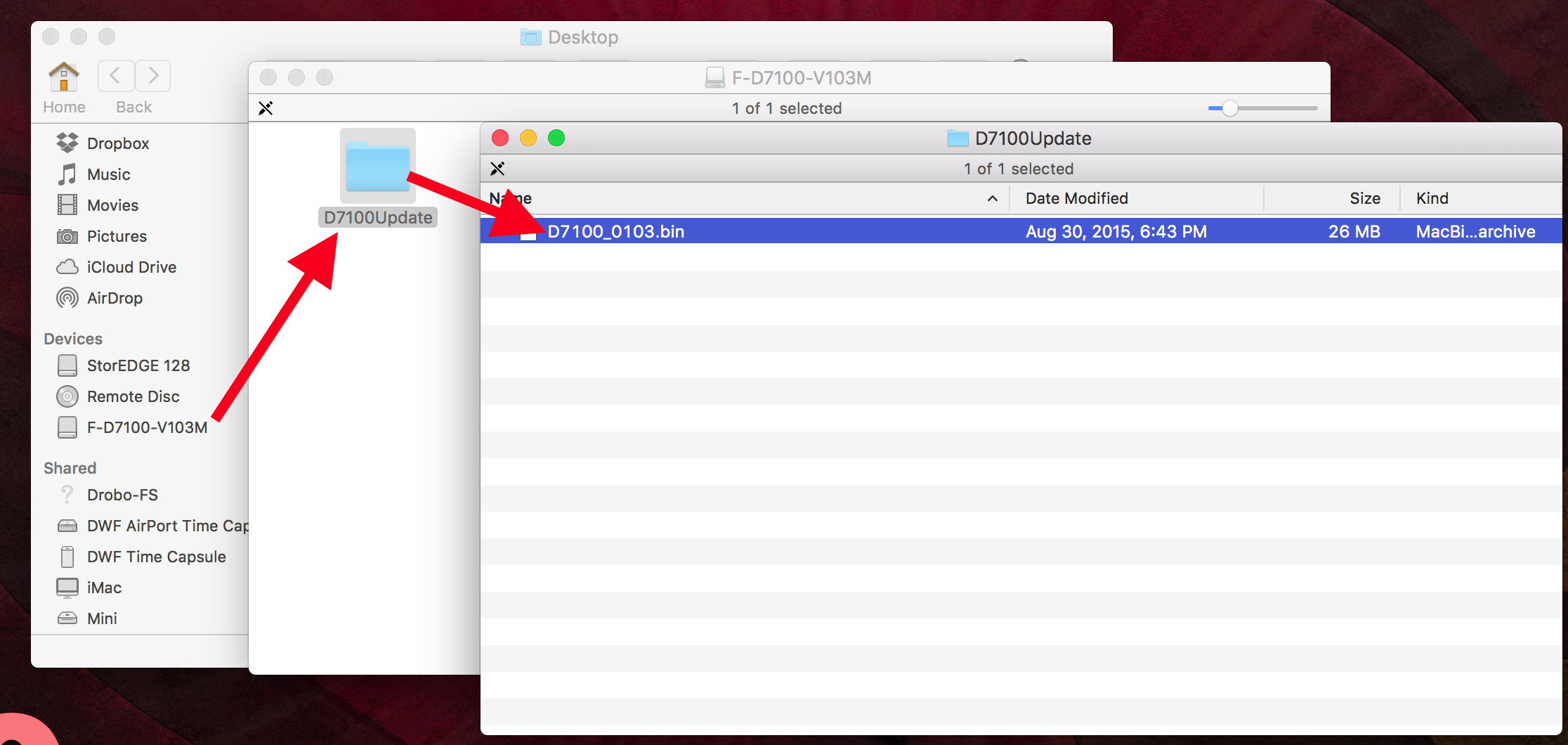

Yes, mount the .dmg file... then open the mounted drive in Finder. You should see a folder named D7100Update. Open that folder to see D7100_0103.bin. Copy THAT .bin file to a freshly formatted SD card... then put the SD card in the (first) card slot on your camera and use the camera menu to navigate to Firmware > Update.
What you are showing here looks like the firmware update for the 7100 going from v 1.02 to 1.03. Got that done, no problem. It is the other update for the Lens Distortion v2.009 that I am having issues with. When I open the bin folder for that, the D7100 does not show anywhere, as this is for lens. I am really beginning to wonder if it is really worth doing the upgrade as opposed to figuring out why I am having this issue 🙂 I'll mess around with this some more on the Mac, then try my wife PC and see if that works. Wish Bob was my uncle today!
