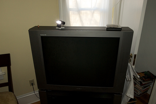

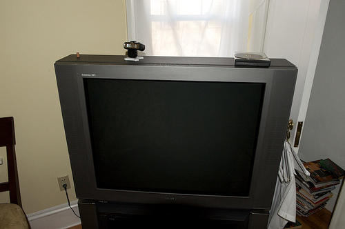

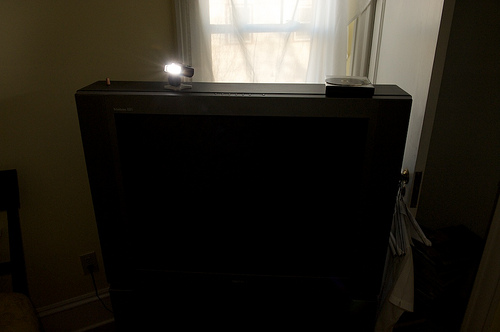

Here are some examples from a D700 using only the built-in flash (though it should work equally well with any Nikon with a built-in flash):
Built-in flash in the default standard shooting mode. Note the slave on top of the TV didn't fire.
Built-in flash set to commander mode with the built-in flash set to fire (TTL). Note the slave went off as well as the built-in flash.
Built-in flash set to commander mode with the built-in flash set to not fire. Note the slave went off, but the built-in flash did not.
