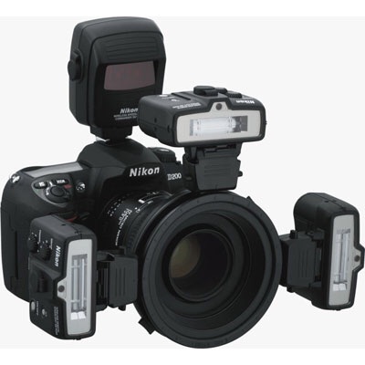

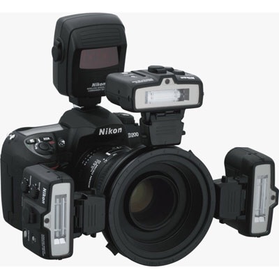

I have the Nikon R1C1 macro flash set. Can't recommend it enough. Gives me a lot more options with my 60 mm 2.8 Nikon. It's a nice little lens, but I could use a little more reach at times.
Can be used off camera as well with little stands.

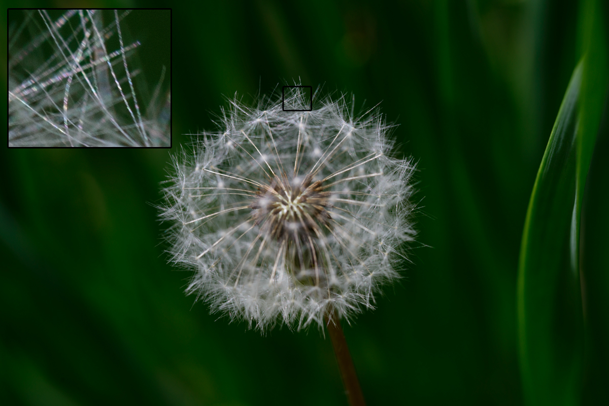

HUGE fan of the Tamron 90mm macro, especially the VC version. I did shoot handheld with it a few times, and the VC definitely helps, but that was only for experimentation. I wouldn't recommend trying to handhold any macro lens, like most of the people before me have said.
Also, I'm assuming you want a "true" macro, IE 1:1 magnification. If that's the case, don't bother looking at any zooms that bill themselves as macro lenses.
I attached a shot from the Tamron 90 VC on a D800, handheld.
