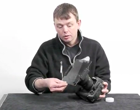

Heads-up. The Nikkor 14-24mm can take filters using the new Lee filter BF holder.
YouTube Video
