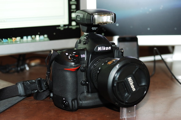

It's not on a par with the SB800 (or soon-to-be SB900, I'm sure), but it works fine on my D3. It's a nice flash to take along mainly because it's so small and light. I've not had shadowing on either my 17-35 f/2.8 or 28-70 f/2.8...never used it with the 70-200.
It won't participate in CLS, but it has faster cycling, it's bounce-able, and won't shadow on most lenses where the pop-up will. And it's $110.
