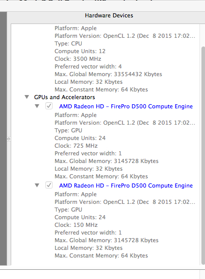

So I ran Luxmark 3 benchmark and got an expected score of 16,668. But I noticed something that I wasn't sure about. In the right side where it shows the dual GPU's, it shows a clock speed of 725 on one of the GPU's and 150 on the other. Is this right?

I am pretty sure that's just the reading of 2nd GPU's idle frequency. When you stress it, the frequency will increase.

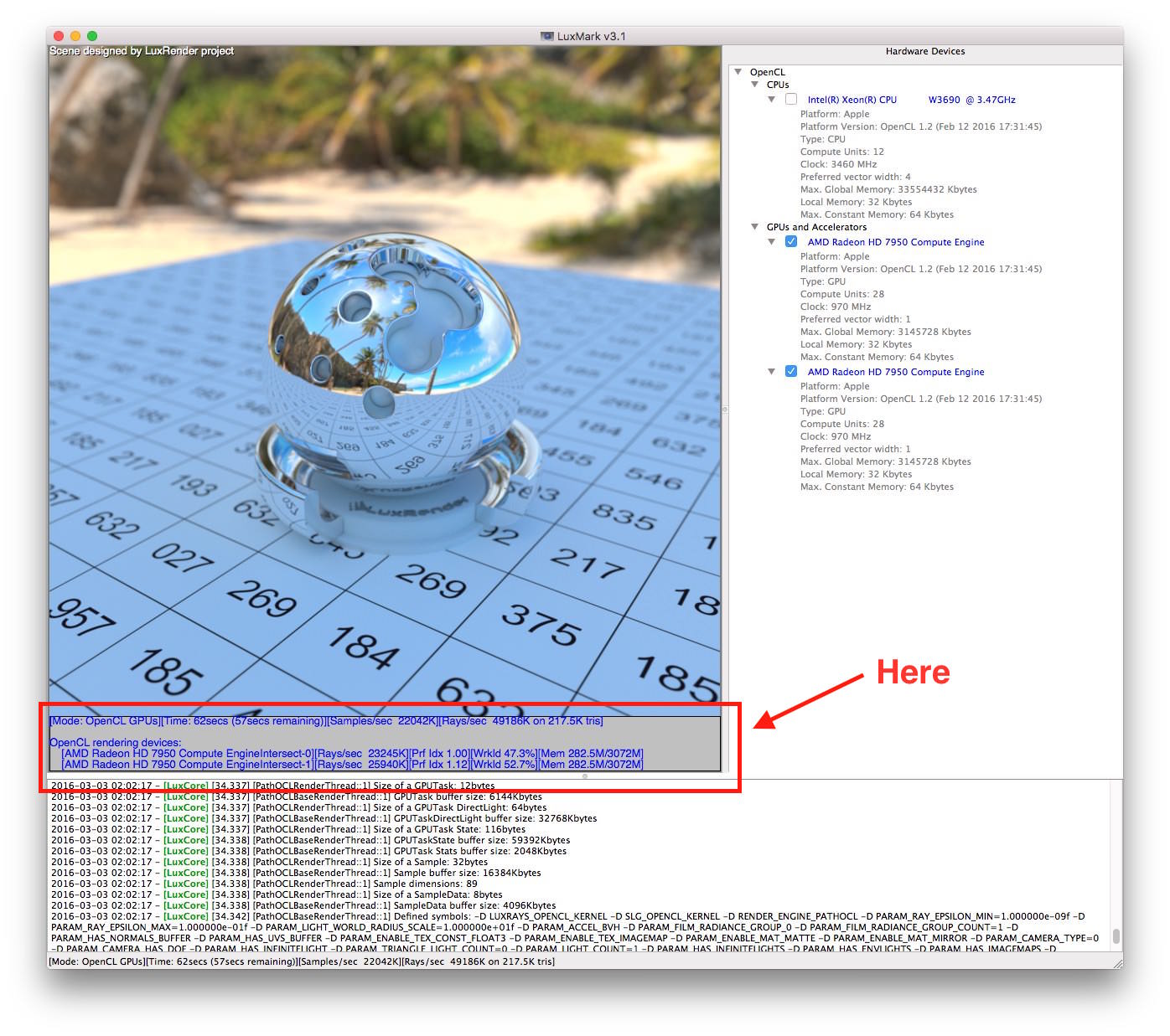

When you running the test, you can enlarge the windows a bit (or scroll down), then you can see the contribution of the GPU 1 and GPU 2. In my case, I have my 2nd GPU in a x4 slot due to cooling reason. So, it's a bit slower than the 1st GPU. And you can see that the GPU in a x16 slot contribute 52.7% and the GPU in a x4 slot contribute 47.3%.
In your case, you should see something similar (may be more close to 50/50). As long as the ratio make sense, then I will assume the 2nd GPU is working correctly, and won't care about that 150MHz reading.
