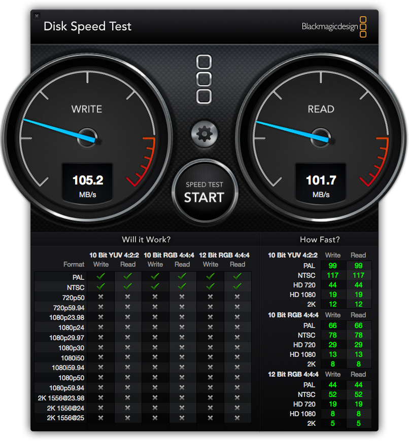

more tests--all tests consistent today at about 115/120 read/write. at least i am not at 44.8 write and 104 read on my TB drive!!!!!
1. re-ran all tests, no reboot, on all day, 115/120 range 3 different tests
2. changed TB cable and port, no sped difference from #1
3. disconnected ALL other drives, no change from #1
4. took that 3TB drive out of thunderbolt adapter and put that drive in USB 3 adapter---116 Write and 112 Read
5. Took the drive that was in the USB 3 and put it into the thunderbolt adapter--99.6 Write and 97.1 Read
6. for reference, took 3TB drive and put it in a USB2 adapter--43.3 Write and 42.2 Read
conclusions? not sure! except my USB 3 and Thunderbolt are basically same exact speeds Read/Write at about 115/120 range. Both Thunderbolt and USB 3.0 are about 3 TIMES faster than USB 2.0 for me. Could my Seagate 3TB drives have 5400 RPM drives that are causing these numbers to be low? I know drive mechanics impact speed and SSD externals will be faster. I'm just thought I'd be more overwhelmed with USB 3 and Thunderbolt speeds since i've never seen them in action before.

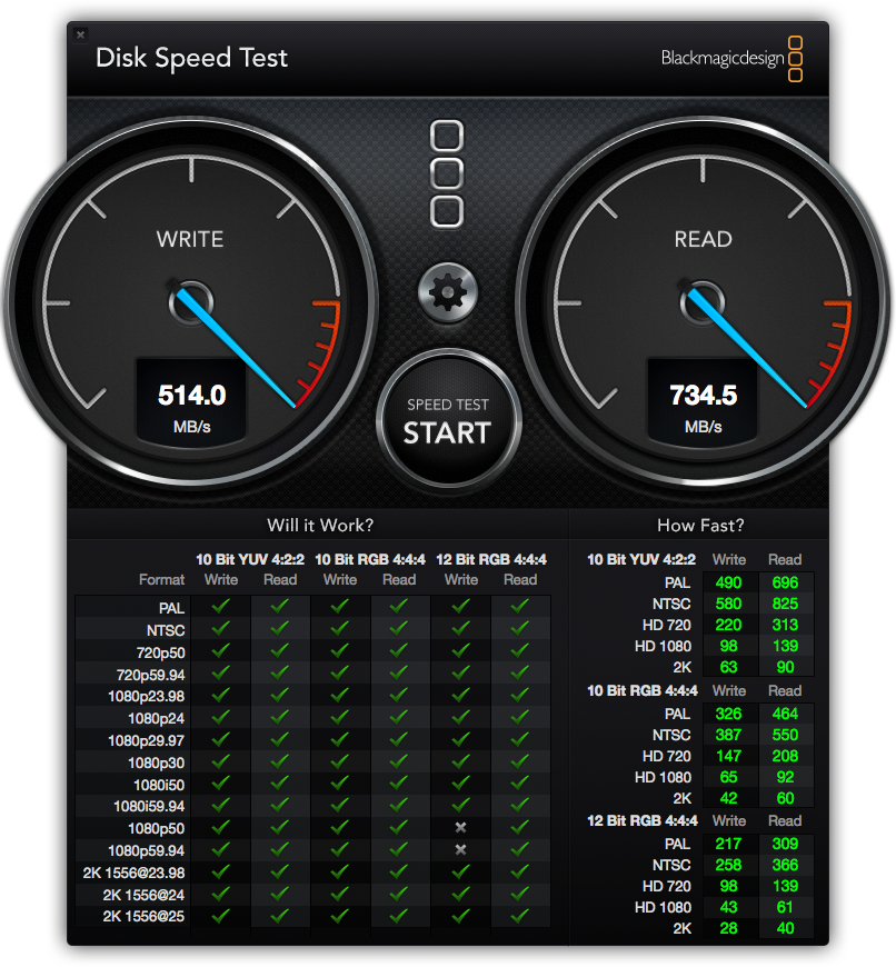

Akitio/Monoprice 2.5" dual drive Thunderbolt enclosure
My Akitio 2.5" dual drive Thunderbolt enclosure was delivered today.
I installed my two 250GB Samsung 840 EVO drives in to the enclosure (pulled them out of the OWC Mercury mini USB 3.0 cases). The Akitio drive case came with an approximately 18" Thunderbolt cable.
Attached is a Blackmagic speed test of the drives in the TB case running OS X's software RAID 0. The speed test of the previous dual-channel USB 3.0, dual-enclosure RAID 0 is attached to an earlier post.
Read speed is very slightly slower than the two-channel USB 3.0 RAID 0 I had been using (734.5MB/sec on TB versus 770.3MB/sec via dual USB 3.0). Write speed is measurably slower (514.0MB/sec on Thunderbolt versus 732.0MB/sec on dual-channel USB 3.0).
I'm a little disappointed that the write speed isn't faster, but really I'm splitting hairs here, really. For the work I do, the real-world difference will negligible to none. And I gain back two precious USB 3.0 bus channels, too. The drive is also at the end of the TB chain, plugged in to the outbound port of my LaCie eSATA hub, though I expect that makes little difference in performance.
The case itself is quite small and compact, much smaller than I expected it to be, and seemingly of sturdy quality. Stylistically it looks almost exactly like a (much) smaller OWC Qx2. Same kind of perforated PowerMac G5/Mac Pro style aluminum front panel and two engraved stripes running down the bottom side edges of the case, just like the Qx2's. And virtually the same back printed front panel iconography and LEDs as the new version of the Qx2. I would't be surprised if someone told me they came from the same Asian OEM.
Each drive slides in on a set of removable rails. I cannot hear the very small fan the Akitio enclosure has unless I put my ear right to the unit. But then again, it's sitting directly on top of a pair of Qx2's with eight 7200RPM drives between the two of them, so whatever noise the Akitio makes is going to be totally drowned out anyway.
The power supply is an external brick. This might bother some people who want to use a unit like this as a portable drive, though makes no difference for me, and I'm sure it helps keep the size and heat of the unit down to a minimum. The unit is also nice in that it has a second TB port for daisy chaining additional devices, unlike the portable TB drives made by Buffalo and LaCie.
I'll try to post a couple pictures later tonight.
So far, I give it two thumbs up.

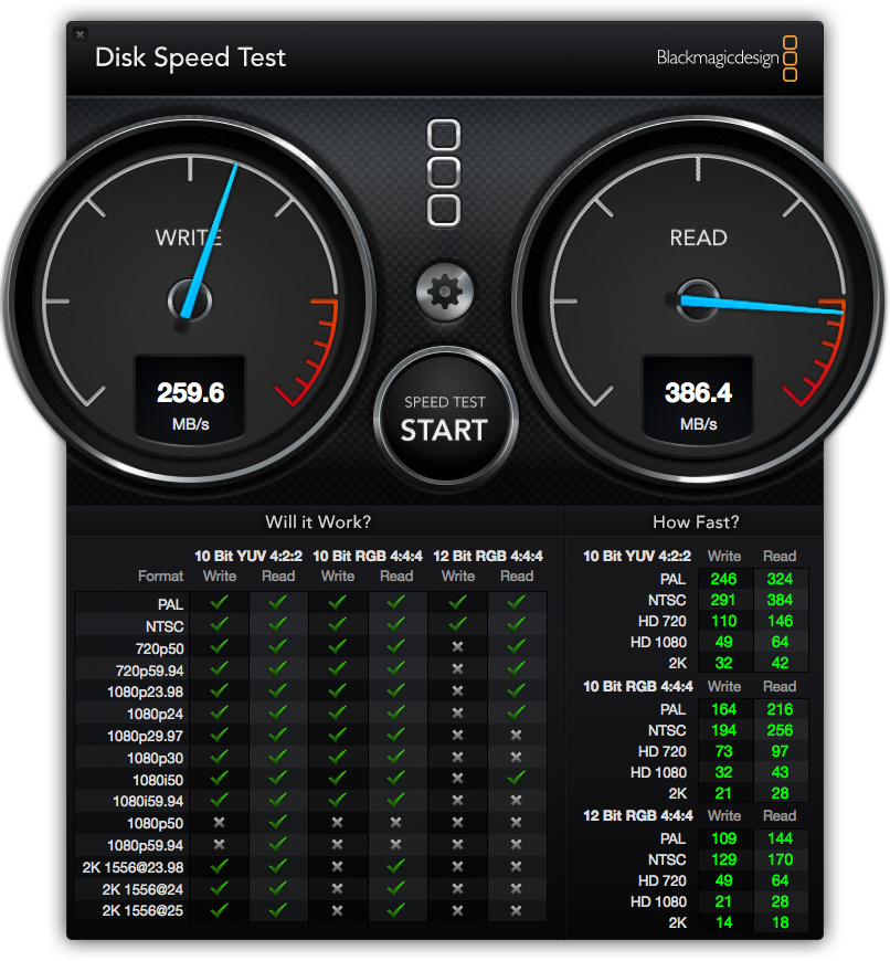

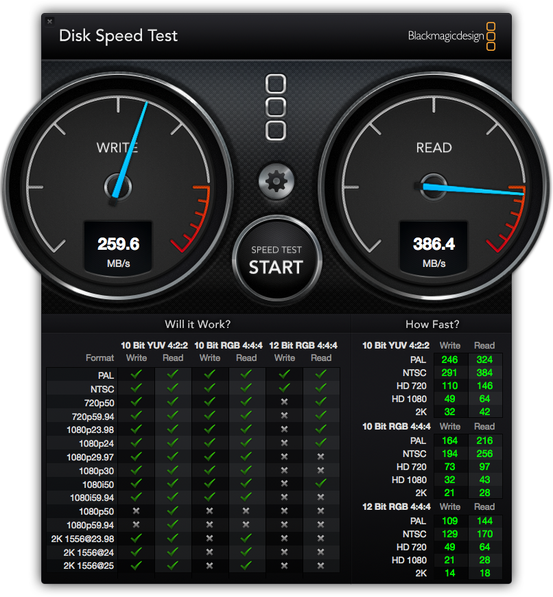

Just for comparison, here is a test from the portable SeaGate GoFlex Thunderbolt bus-powered adapter:
1) 105/102 with standard GoFlex 1TB 5400rpm 2.5" hard disk
2) 260/386 with Crucial M4 SSD 256GB
(I discovered that the 512GB M4 SSD draws too much power for the GoFLex adapter and "bricks" the drive ... 2 different drives, 2 different adapters)
-howard
