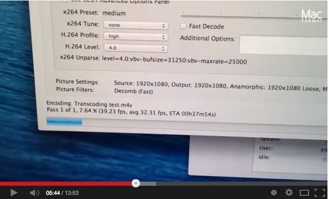

The "MacFormat's Mac Pro 2013 diary - part 3: video encoding, GPU heat tests and a little experiment" video on YouTube shows HandBrake performance of the nMP 8c but I am a bit disappointed if the shown results are the maximum. Not sure what the source material was (BluRay equivalent was mentioned) but the AVG FPS was around 32 - 34 FPS.

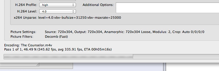

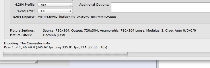

OK, attached a pic. i am running Eye TV, watching Bruins game and cloning a 2TB drive via USB 3 at the same time as handbrake. not too shabby.

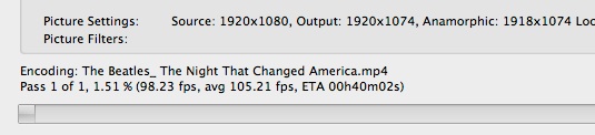

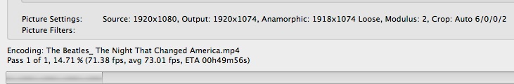

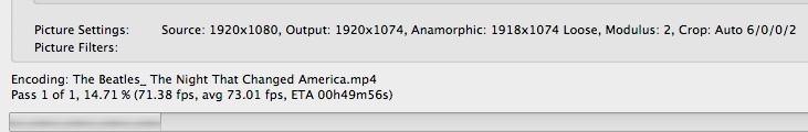

i've been seeing 200-300 fps from mkv and avi transcodes however, i did find something to slow my handbrake/nMP combo. a 13GB 1080p eyetv file from tonights Beatles celebration. i edited the commercials out then i just point Handbrake to the .eyetv file. image attached.

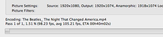

after all that, i forgot to click the Large File size option and had to run it again. interestingly, it is faster this time

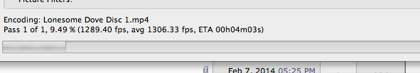

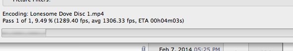

Sorry for the multiple updates but i was just shocked at what i just saw. granted it is a SD 2 hour movie, so nothing close to 1080p but i never saw those numbers on handbrake.
