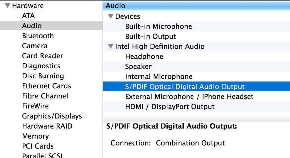

Why don't you? My 2006 MacBook, 2008 Unibody MBP and mid-2013 rMBP all have the 3.5mm analog+mini-TOSLINK combo jack. (The former 2 machines had the advantage of sporting a similar analog/digital input as well!)
It says so even in the System Info!

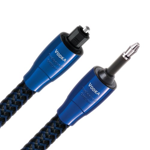

So the only thing you need is the matching cable:

The 2010 MBP has a combined digital/analog mini jack but I don't believe it's optical though.
Its optical. It's an electrical mini jack socket for analogue with an optical emitter hidden behind it for digital. You need a 'TosLink to Mini Optical' optical cable - one end looks like a plastic mini-jack plug with the fibre optics at its tip, the other end is the more familiar, square-ish SPDIF connector. They're widely available.
(the previous poster, priitv8 has a fancy cable with metal tips which doesn't help the 'its optical' argument - but it is. Hope he didn't get charged a ridiculous price for all that non-functional bling!)
