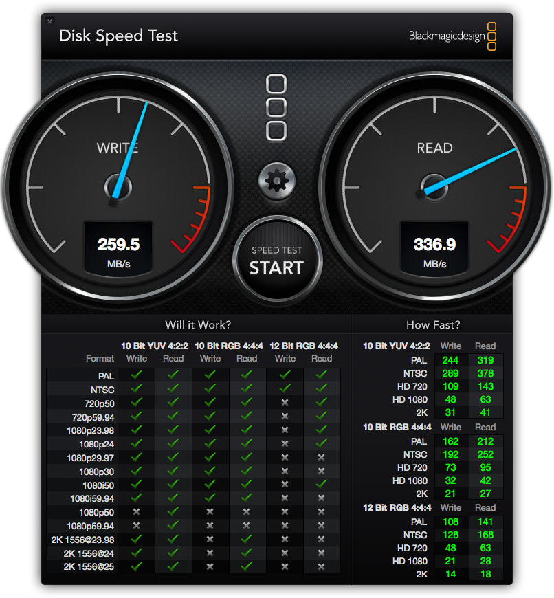

These data rates are measured from a RAID 0 of four Crucial SDDs in a 4-bay enclosure with 4 eSATA cables.

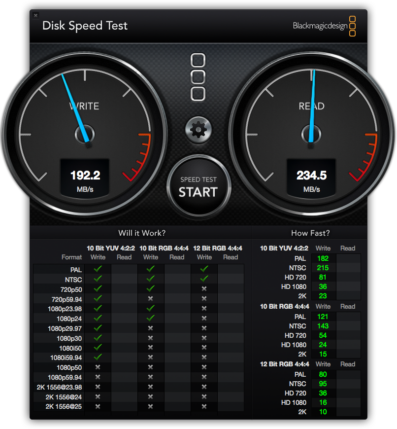

Not too bad, considering the 4-bay, 4-port enclosures are limited to 3 Gbit/s bandwidth per port.

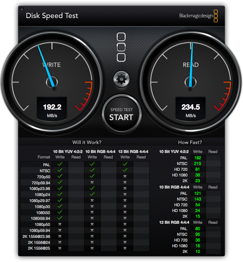

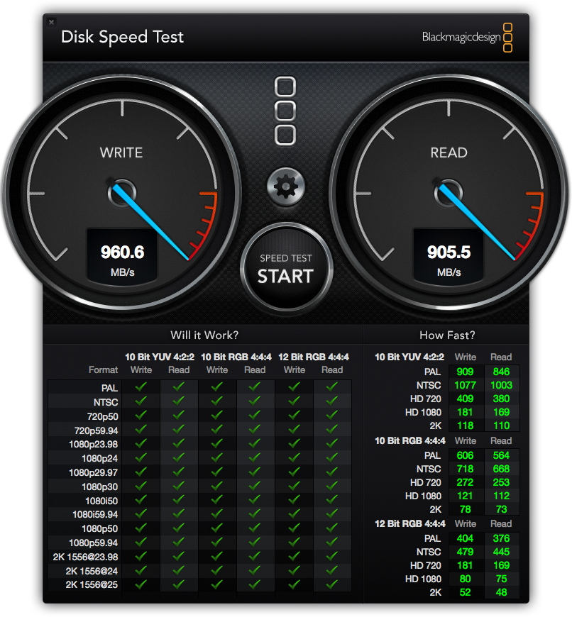

These are measurements for the internal Apple SSD.

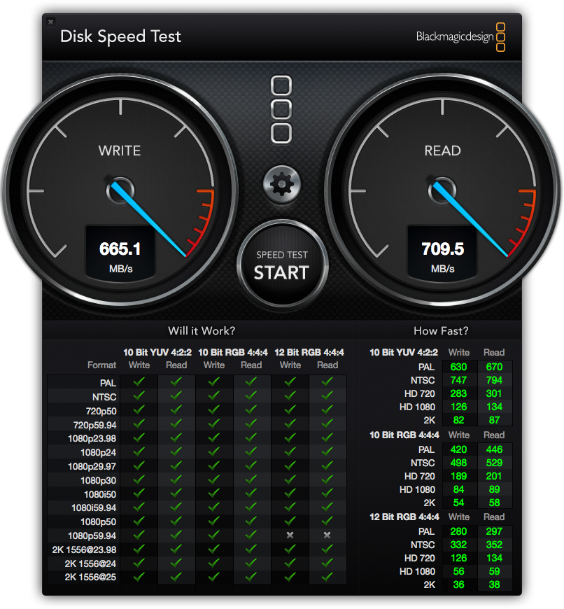

These are the speeds of a single Crucial SSD in a 6 Gbit/s enclosure attached via the described CalDigit Thunderbolt™ Station.
These measurements are from a single Crucial SSD in a Port Multiplier enclosure.
