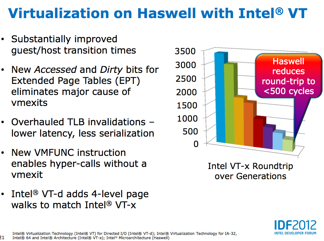

Same feature can run at different speeds with different amounts of overhead.
For example Haswell has a few virtualization updates over Ivy Bridge ( E5 v2 )
http://www.anandtech.com/show/6355/intels-haswell-architecture/11
If running the newest VM software that is Haswell aware there can be a substantive difference.
Apps don't normally make tons of system calls, so improvements likely largely elsewhere also (e.g, there is something mismatched about the RAM or free RAM configs. )
