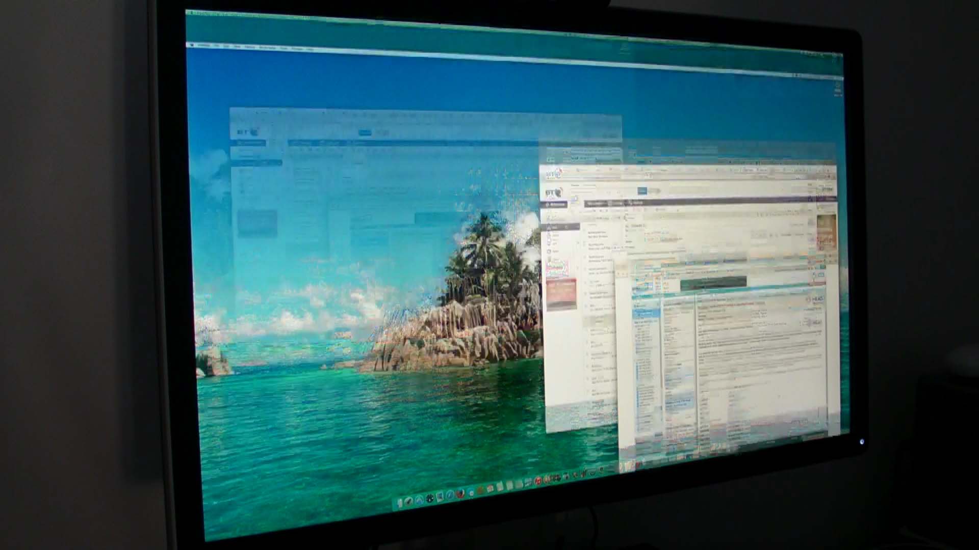

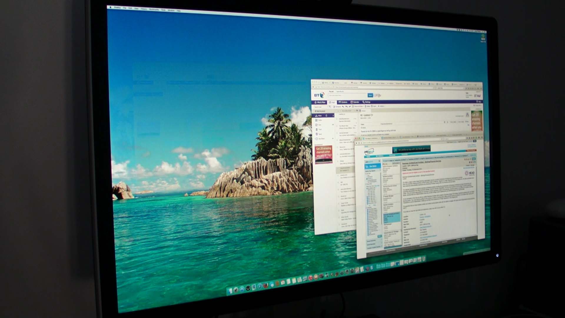

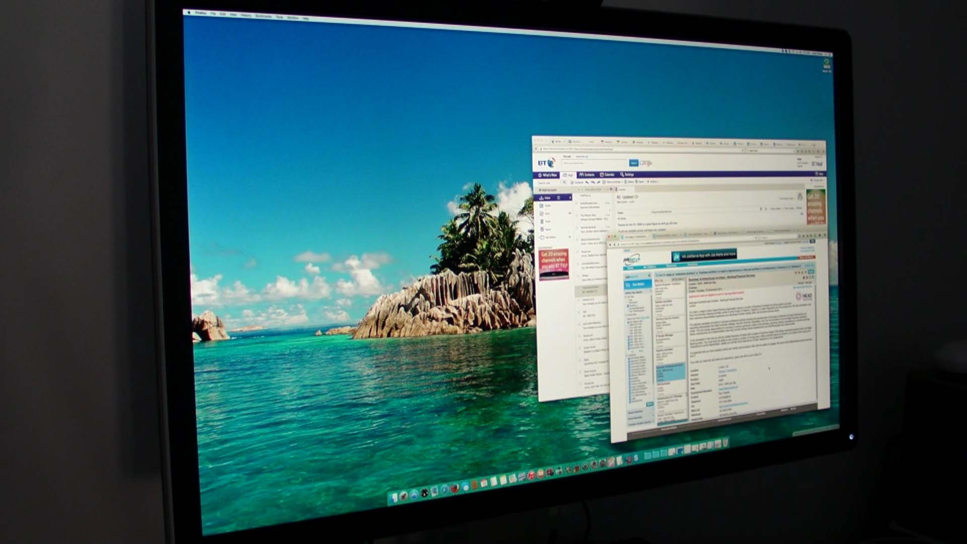

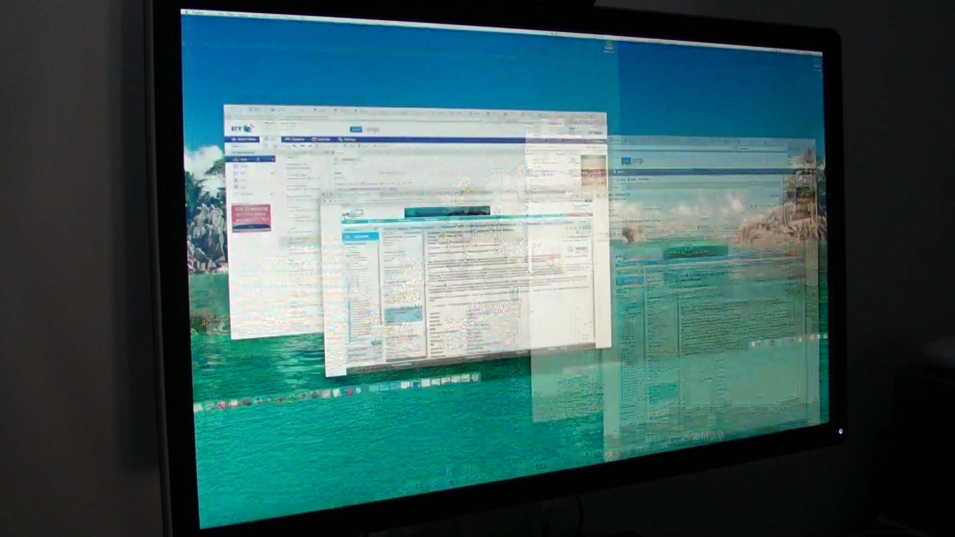

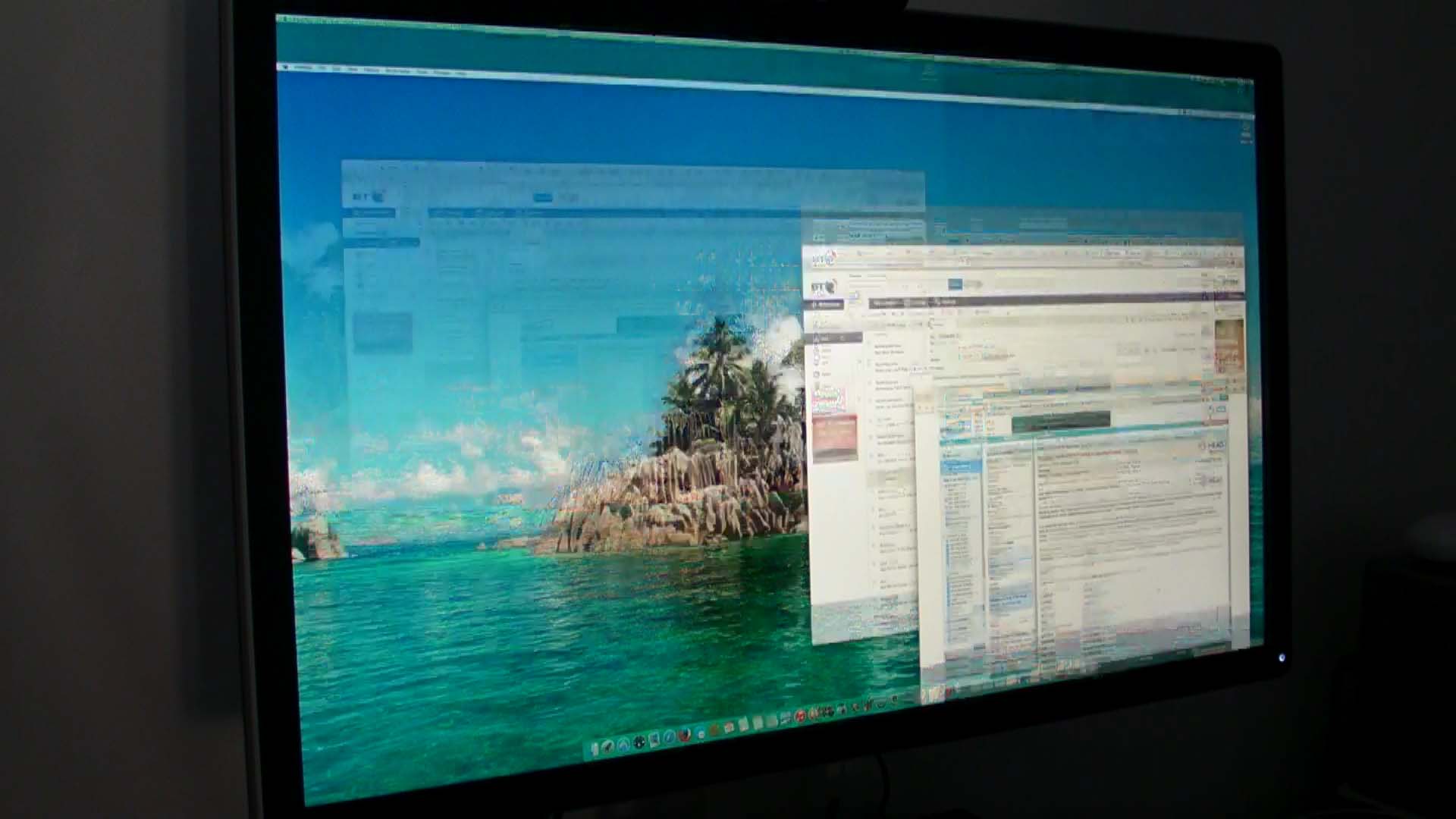

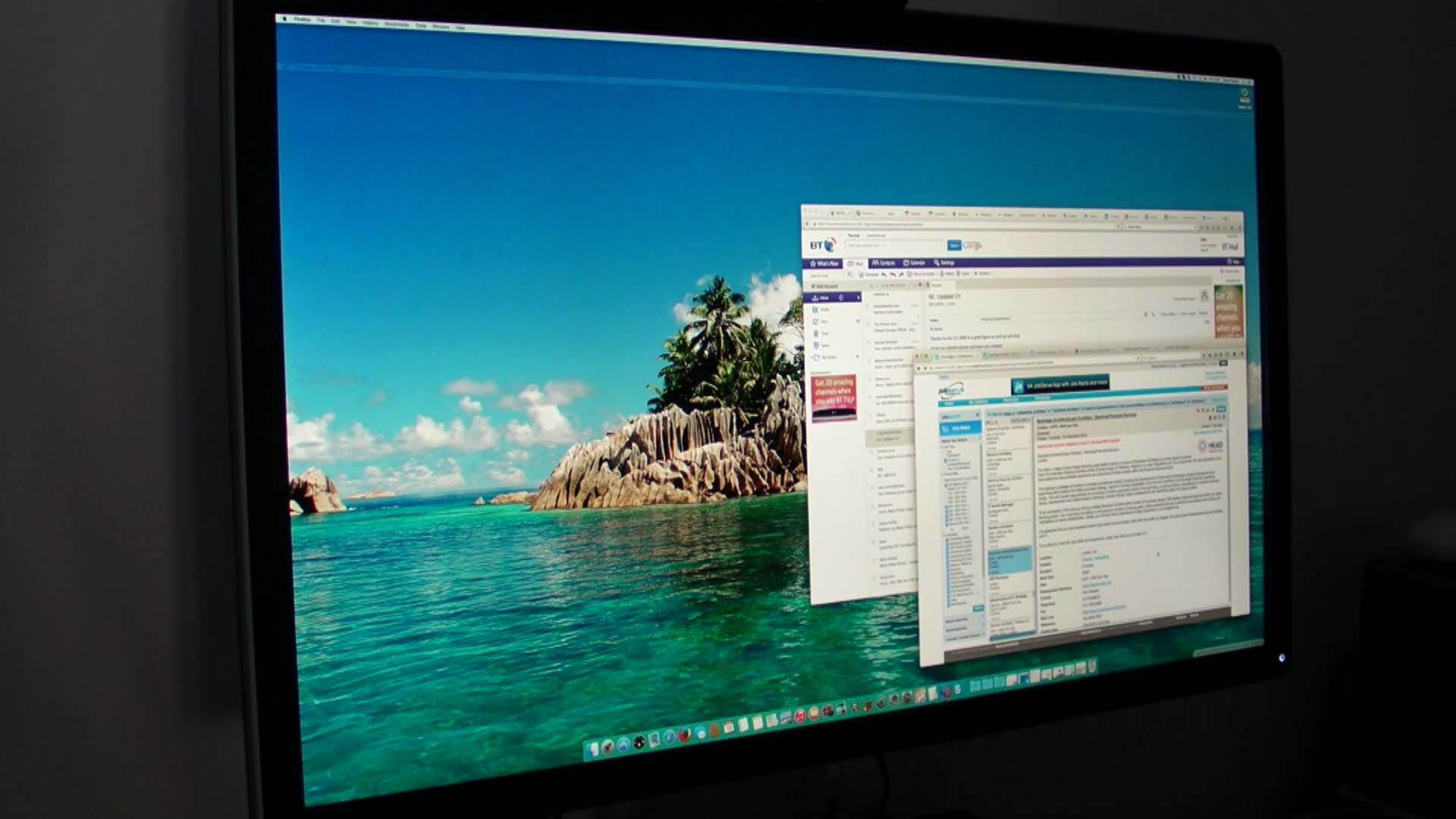

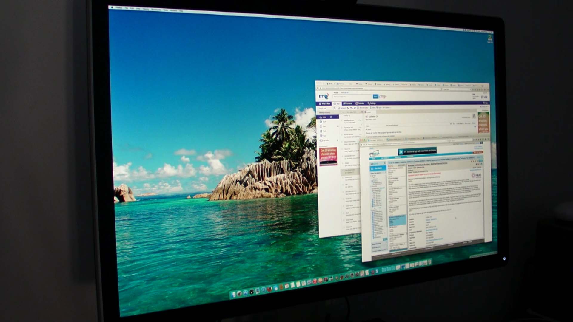

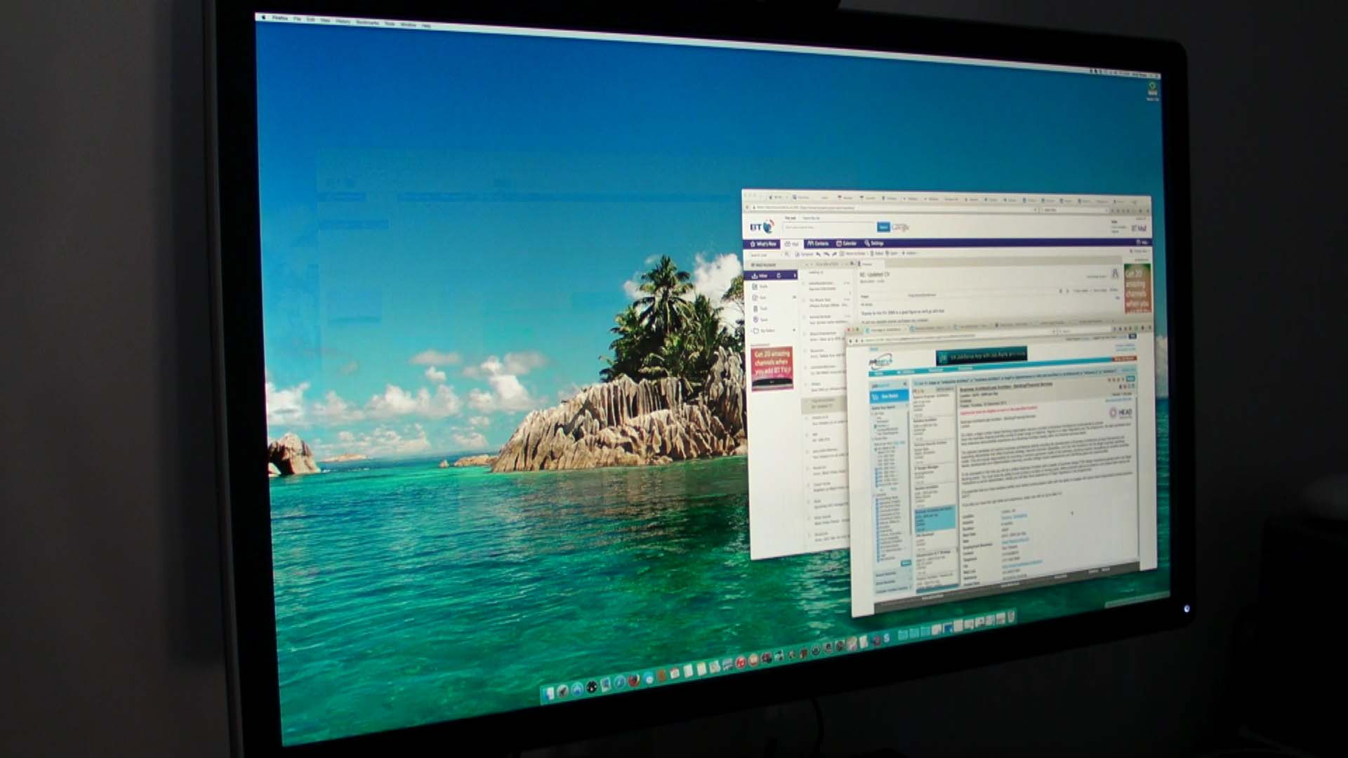

A screen recorder probably wouldn't capture the flicker but a camcorder definitely can.
Frame1 -- shows the screen as it should be
Frame2 -- you can see the top menu bar starting to appear a little way down, as though vertical sync has been lost. This seems to be a full frame being drawn as the next frame shows the browser windows having shifted down the same amount. But...
Frame3 -- suddenly things go very wrong indeed. Past the LCD lag, we can see a new frame is being drawn where the browser windows are now at the top left of the screen instead of the bottom right.
Frame4 -- just when you think things couldn't be worse, the full horror makes itself visible. It's not a sync problem at all. Those browser windows haven't moved on the desktop. Instead, if you look carefully, you can see that the whole desktop has been reduced in height by a third and rolled left a third of a screen. That bit of island on the right of the screen is the bit of island that was in the centre. The real give away is the dock.
Frame5 -- heading back to normal with just a bit of LCD ghosting.
So I have no idea what the Apple 7950 driver is doing but that scaling of the desktop means it's definitely not a RAM problem, even if the change of RAM clock is happening at the same time.
